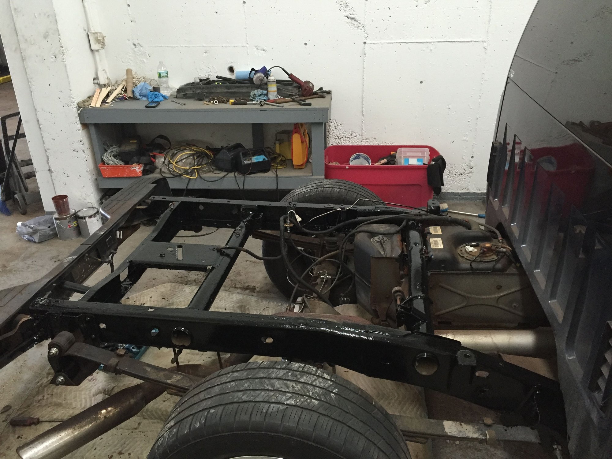

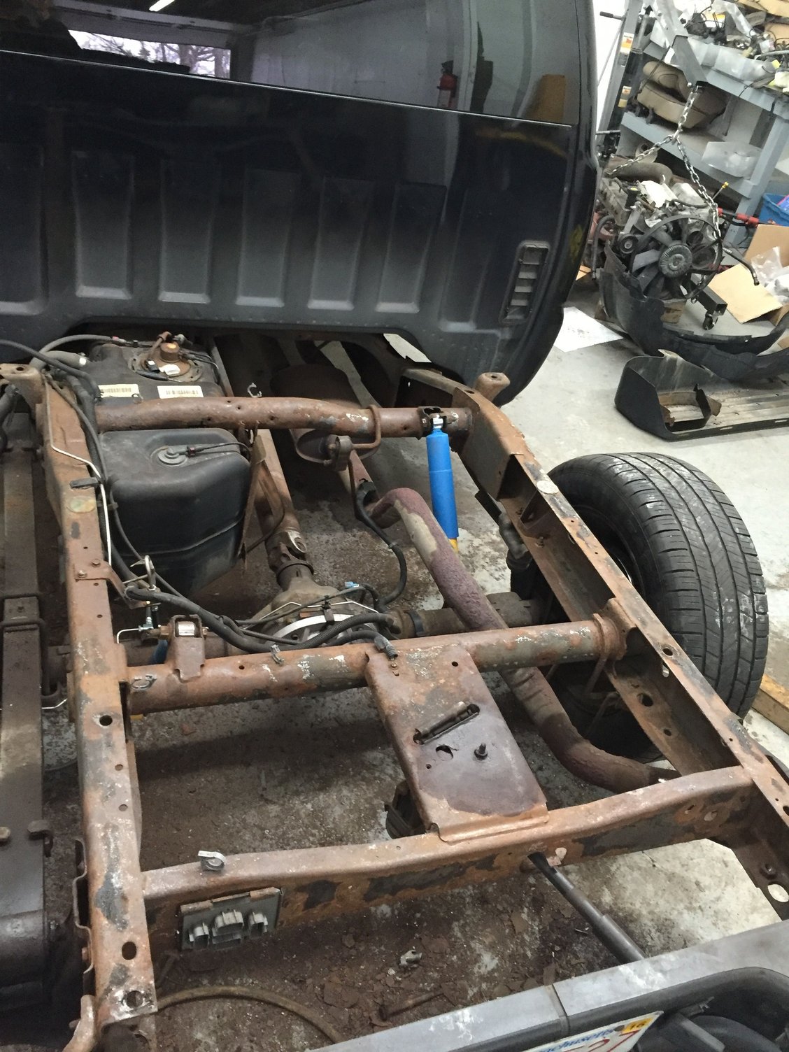

Old Apr 29, 2016 | 10:10 AM
  #29
Jlipton72's Avatar
Joined: Dec 2015
Posts: 29
Alright, so, truck is back together and I've been driving it stock, what a luxury boat! Popped the bed off to do some needle scaling and painting (thanks New England)
While I was under there I realized I got the wrong walboro kit, after speaking to summit and then walboro, apparently there is a new unit being offered from walboro that is a complete upgraded plug and play sending unit with a 255 pump installed for what he said was in the realm of $300 ish, doesn't seem all that bad and I'm going to wait a little to see when it actually releases.
As for exhaust I ended up going with the speed engineering system that dumps in front of the rear axle. I'm hoping to stay within reason noise level wise, and that system seems like a good start for the money that if is too loud I can add a second muffler.
Put tires on the truck as well, 305/50/20 nitto bro20s. Like how they look and feel. Drive nice too when I'm done feeling
Header and exhaust will probably go on next weekend once I figure out why the truck has no air conditioning... Is there an AC fan that could have a stuck relay? Starts cold then goes warm..
Thanks fellas
