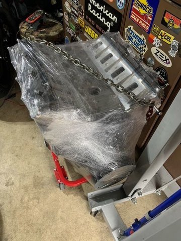

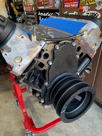

For the first time in 4-5 years, the engine is in my garage and ready to drop in! Waiting on a couple little nuts and bolts and we will be ready to put her in her home!

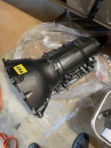

Got ready to mate the trans to the engine and realized the measurements weren't adding up. Had a perfect 1.050" from trans case to converter bolt flange but had a 1.300" roughly from the block to the flex plate mating surface. Did a lot of digging and back checking and realized I have the elusive long snout crank and the TCI flexplate is made for the short snout without the need of a spacer. SOOOO..... another weekend lost while I searched for the right flexplate. Unfortunately, the only one I can find is a GM Perf OE 4L80 one. Fingers crossed it will hold up. Waaayyy too late to change the crank now!
Side note, anyone need a #399754 TCI 4L80 SFI flexplate? Only bolted on once, 0 miles, LOL.
