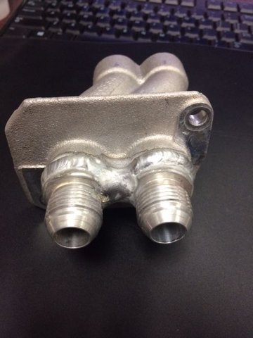

Got my fitting back. Not my welds, still works for me though.
