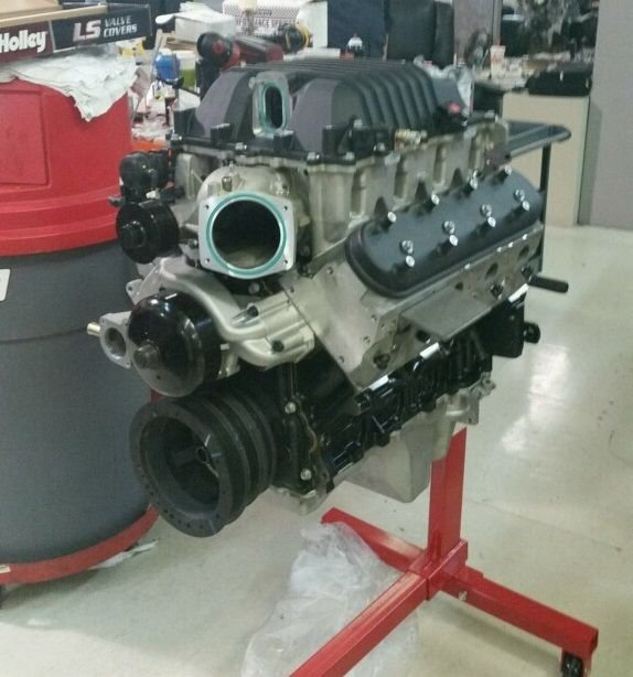

Coming together nicely. Almost ready to dyno. Waiting on the fittings to come back for the supercharger. They are getting welded for -10AN fittings. Also waiting to order the pulley system till my taxes come back. That will speed things up a bunch!

Looking good. What water pump is that?
It's off the 07-10 VVT tahoes. Has the right offset for the 8 rib combo to run the LS Simple bracket kit, and lines up with the supercharger pulley.

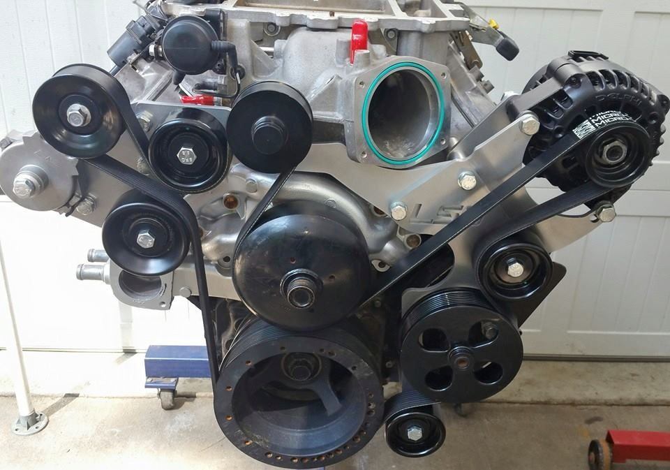

This is the 8 rib LS Simple kit I'm going to run, but in black.
have you tried looking into the olsen customs kit? im running it on my lsa swapped truck and the price is cheaper then ls simple
I havent. Got a link or something? I can't find it.

lsxperformance's Avatar
Joined: Jul 2010
Posts: 789
From: Waverly, Ne
He's on Facebook has his own billet bracket setup looks pretty nice.

And had an awesome price!!

He does do some really nice work! Quick response too. Sadly, he does not have anything for the 8 rib guys with the zl1 balancer and late model water pump spacing. Oh well, woulda been cool.
