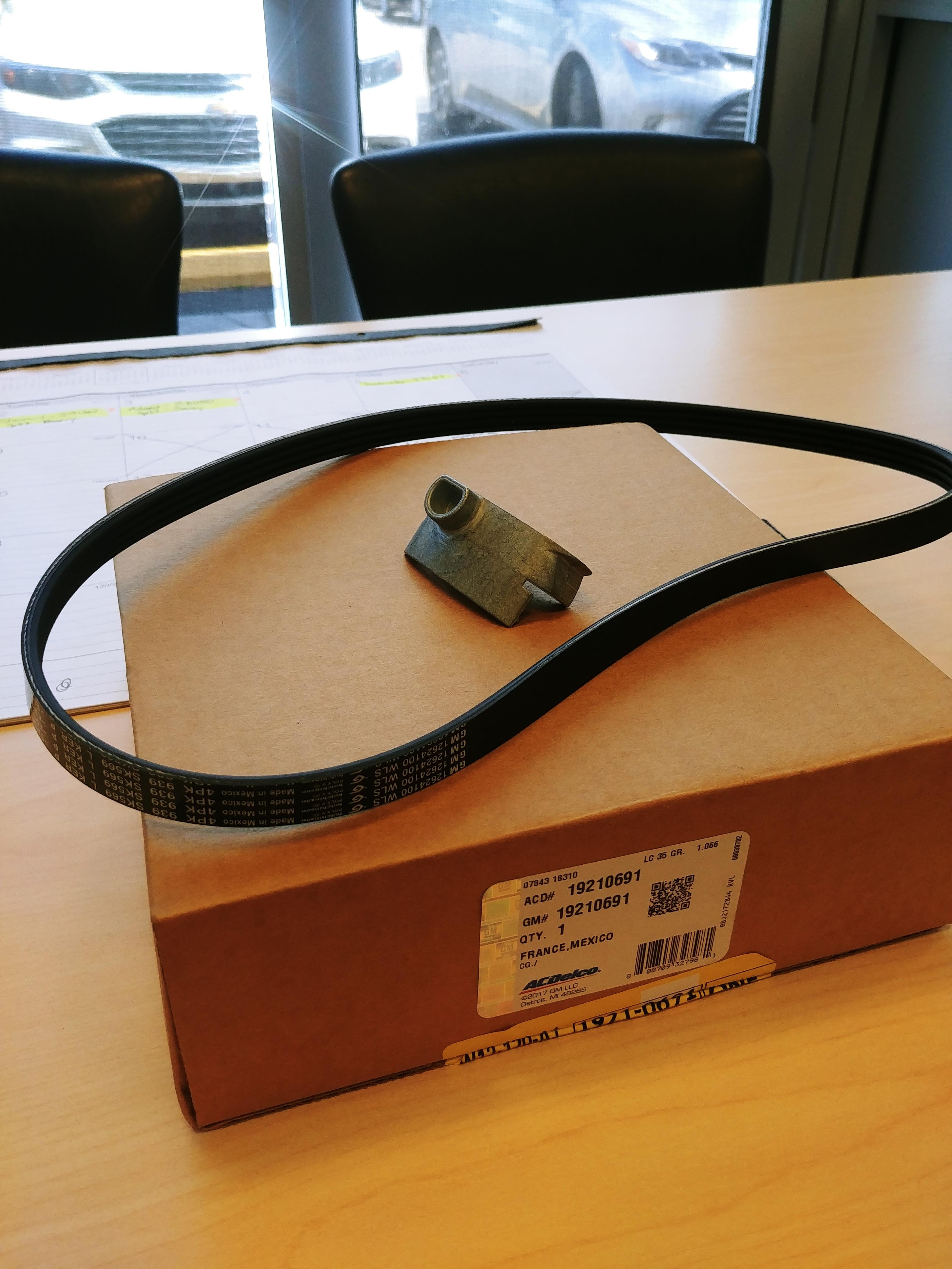

Did a little maintenance today. Drained catch can, cleaned air filter, rotated tires, and finally put on the stretch-fit ac belt. It is on and ac works! I will keep y'all posted on whether it last or not.

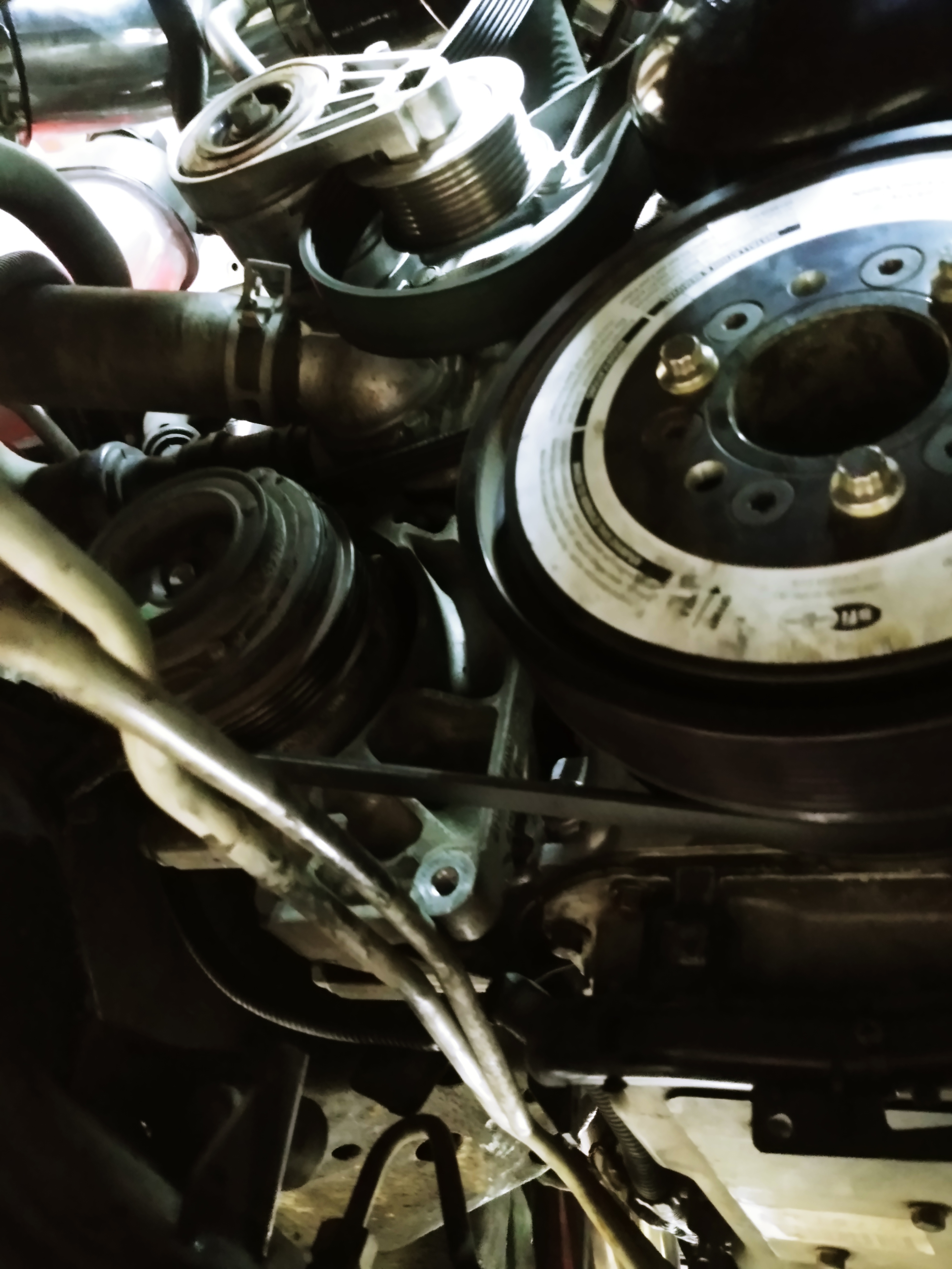

Update: it's been a couple weeks since I installed the stretch fit belt, and AC is still working. I think that fixed the belt slinging issue !
