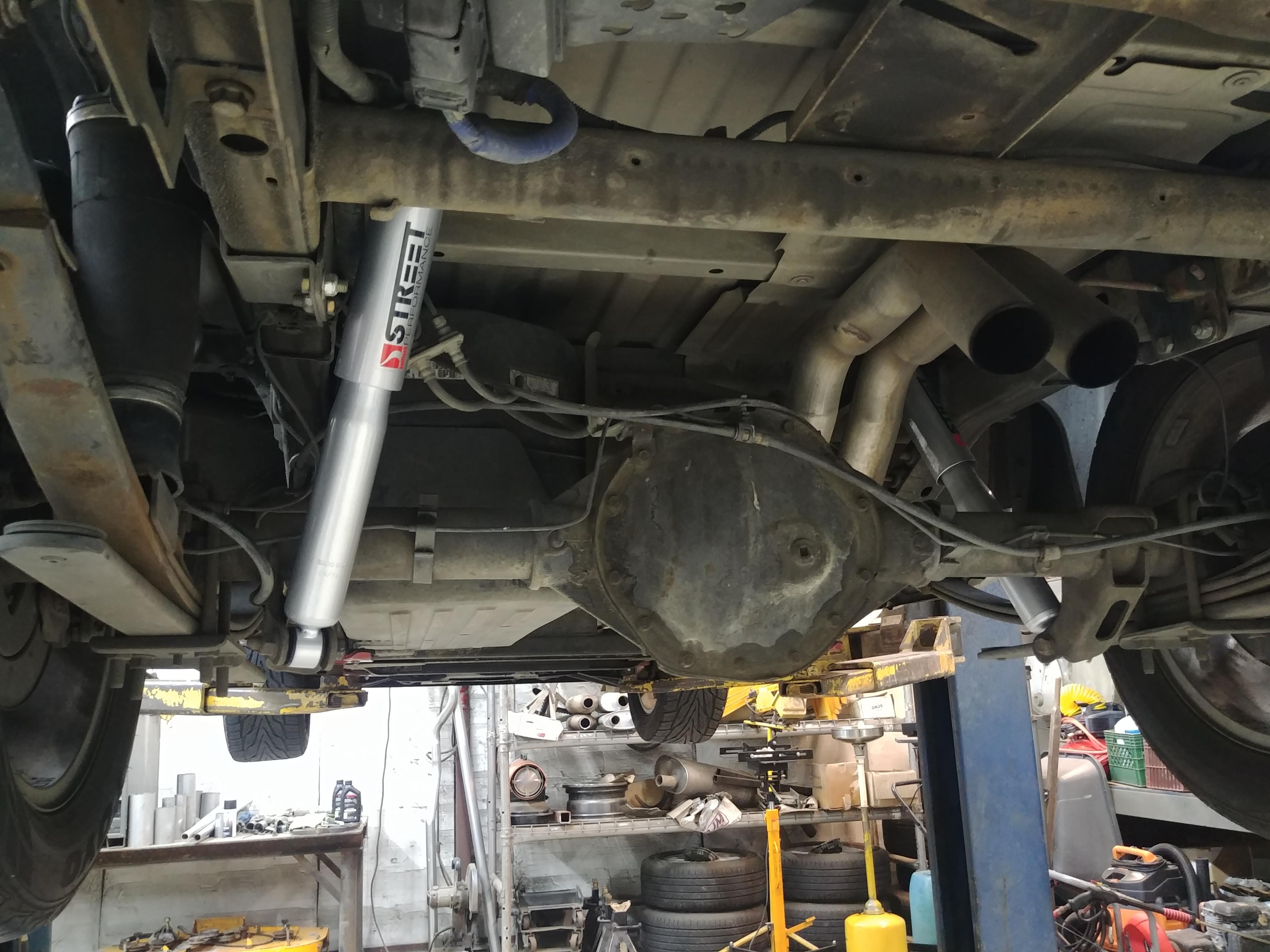

The Fox 2.0 shocks aren't bad, I've had a few sets and they ride nice but are firm when needed...

They feel nice so far. Will have more road time tomorrow on my way to work to get the full effect. Will keep y'all posted.

I have the Belltech shocks in the rear, with being lowered 4" out back, the oem length shocks are too long and you will bottom out easily. I switched to the Belltech SP rear shocks, they are pretty good. Maybe a little firm, mine seem to have a light clunk on road seams.
