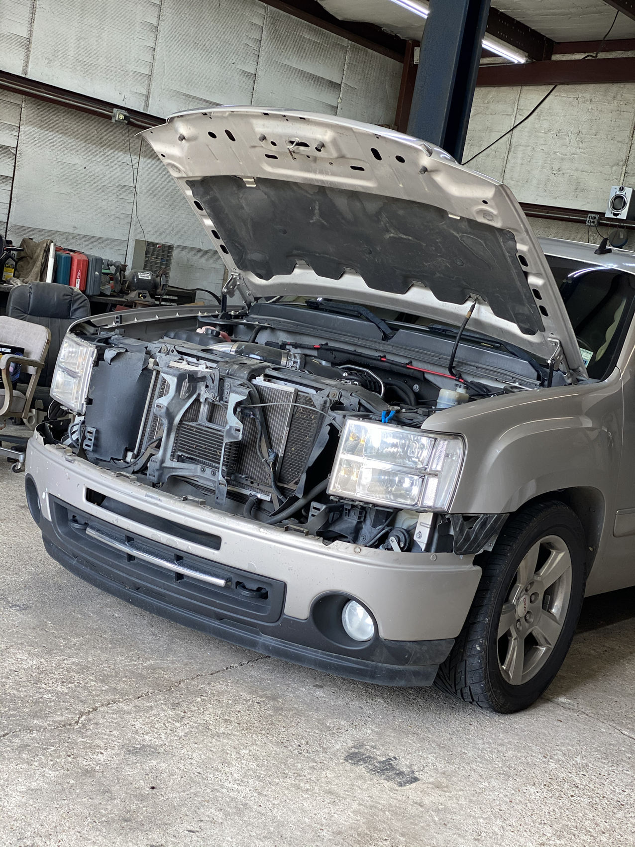

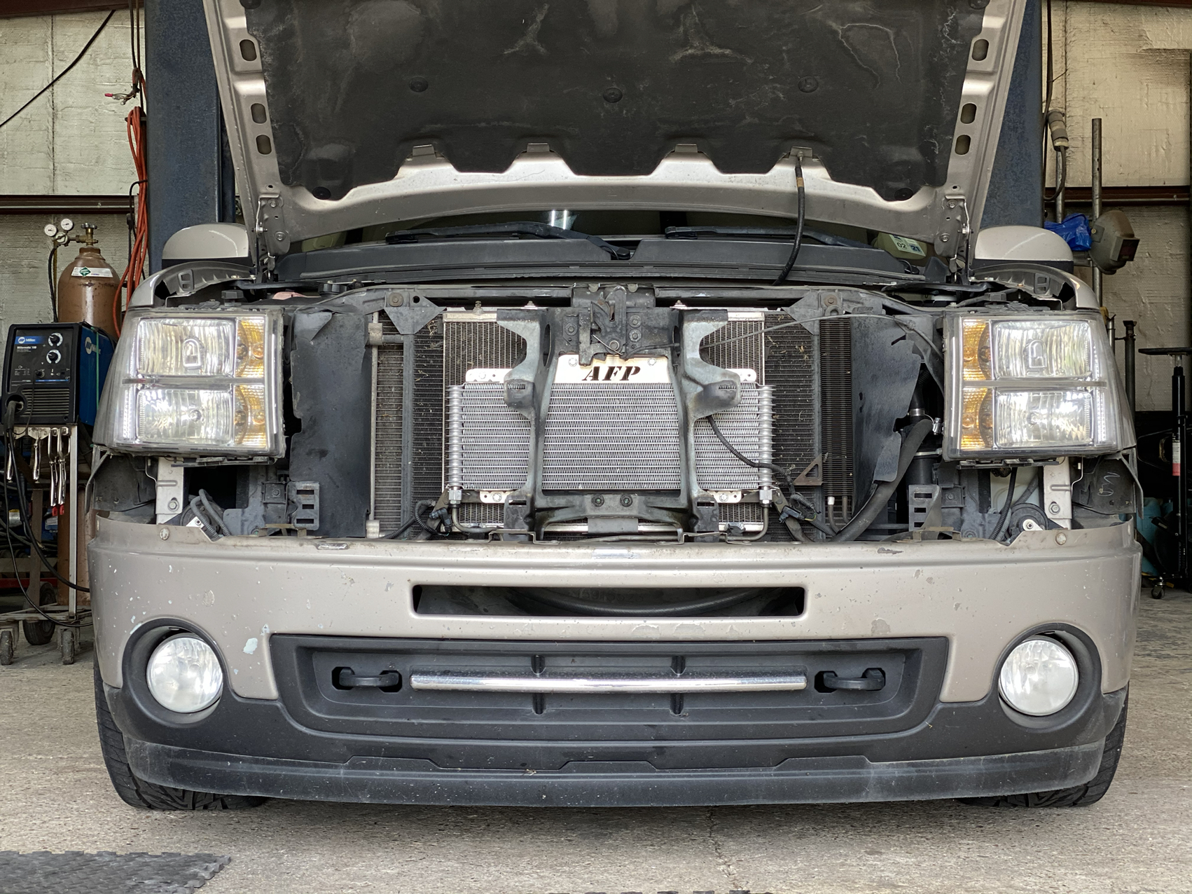

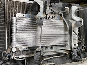

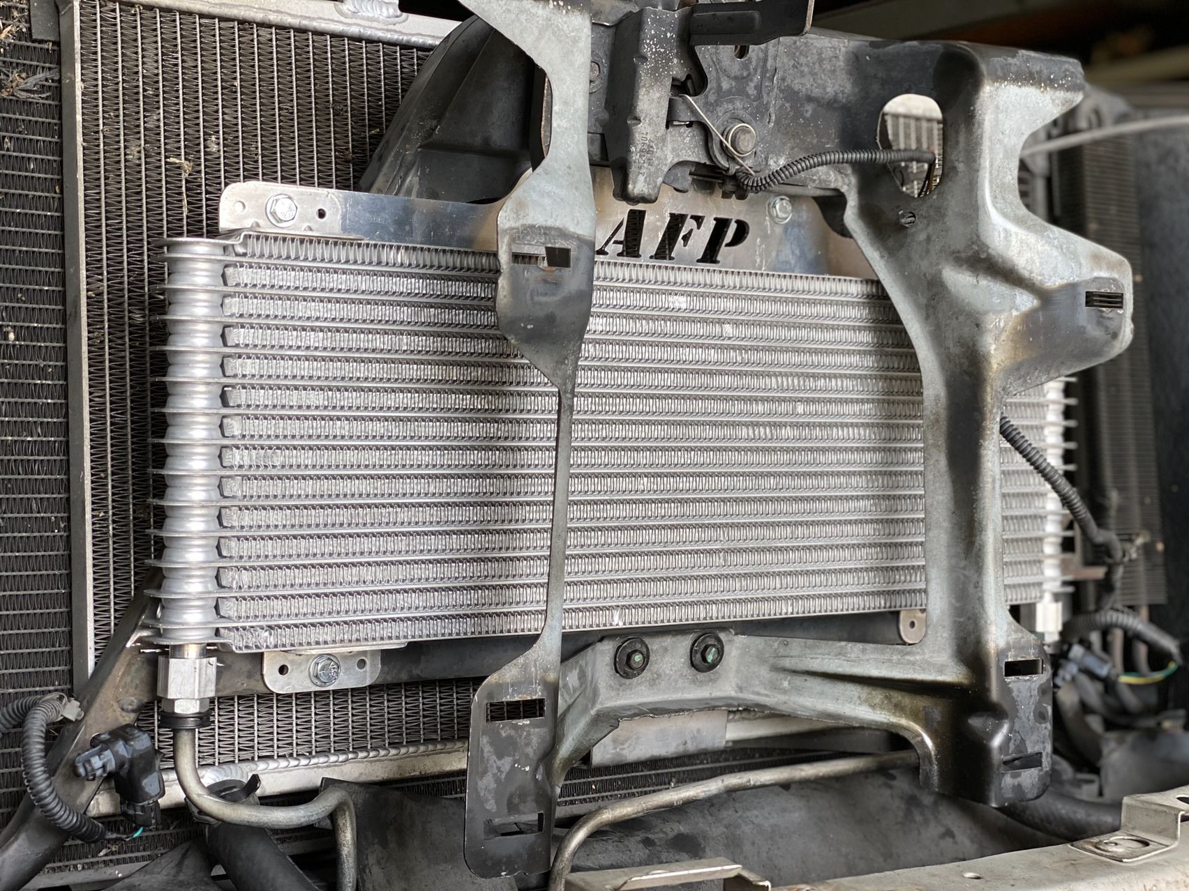

Update. So I've been having a trucool 40k since I did the motor swap and upgraded converter but ... never installed it. Planned on installing it the weekend after getting the truck tuned but was driving it and temps were fine. My job I had then was a long interstate drive away from my house and my trans temps never got too high. I switched jobs to another location and have a lot of stop and go, but started that job during fall/winter with cooler temps so my trans never got too hot. Now that the weather is heating up and I have been in this stop and go traffic, my trans has been getting up to around 200 degrees everyday on my way home soooo finally decided to install the cooler.
Wasn't bad at all. Used the AFP bracket and factory lines. Also did not bypass the radiator. Trans temps have been staying around 40 degrees cooler.
Other than that, everything is great!

Great job and nice bracket!
