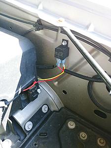

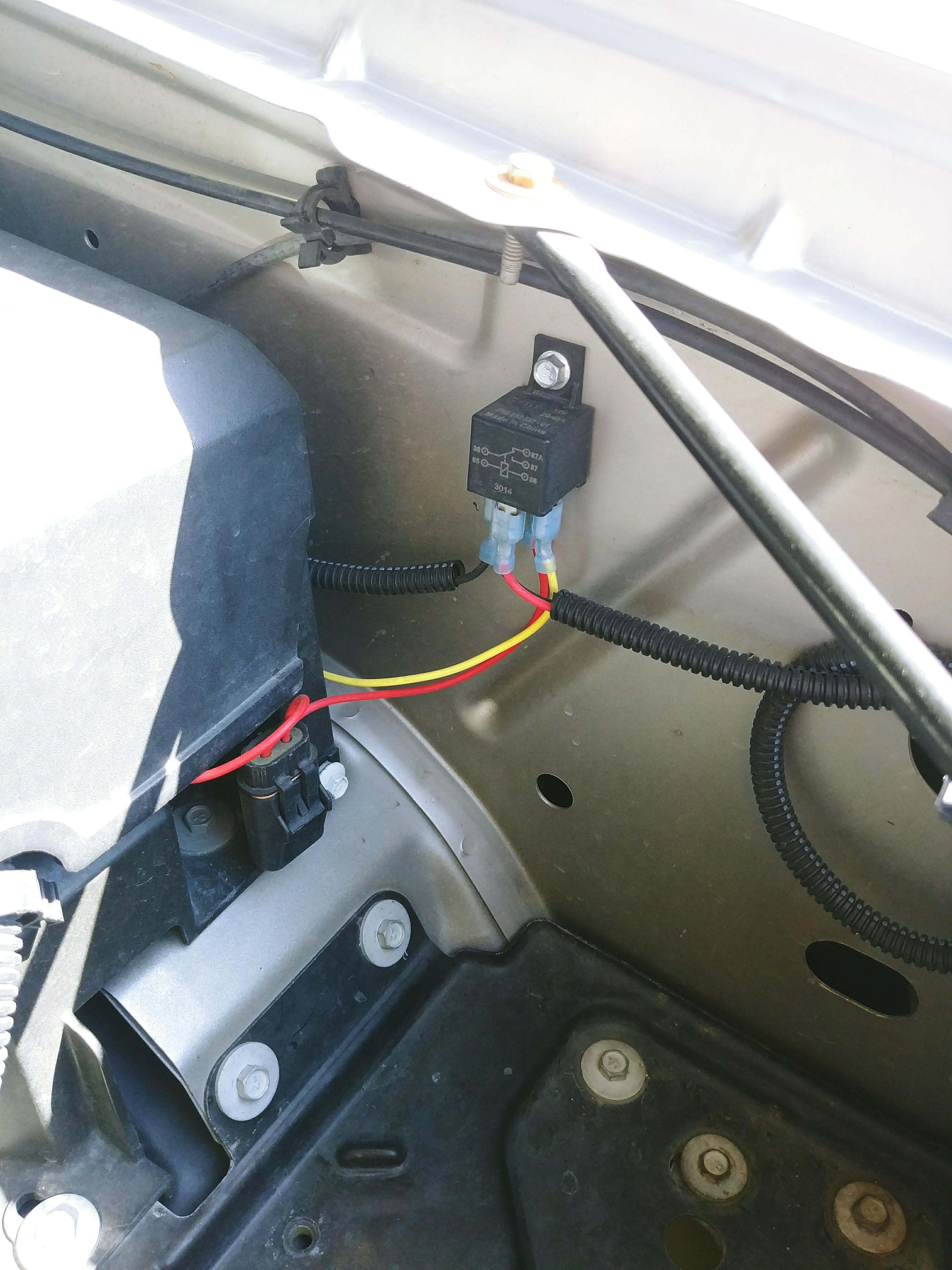

When you did the install did you have to splice 2 of the MAF wires to the 2 wires coming out of the supercharger? Also, before you added your boost gauge did you just have the vacuum line at the back of the blower capped off? Any pics of where you mounted the relay for the intercooler pump?
I decided to order a 3.00 pulley and some ID850s...hopefully those injectors are enough to run E85...
yes I did, the wires for temperature are relocated. and yes, I forgot what exactly I used, some type of rubber cap tiewrapped on tight until I did boost gauge. and here's a pic of the relay, nothing special but works and is out of the way.
Awesome thanks for the info!

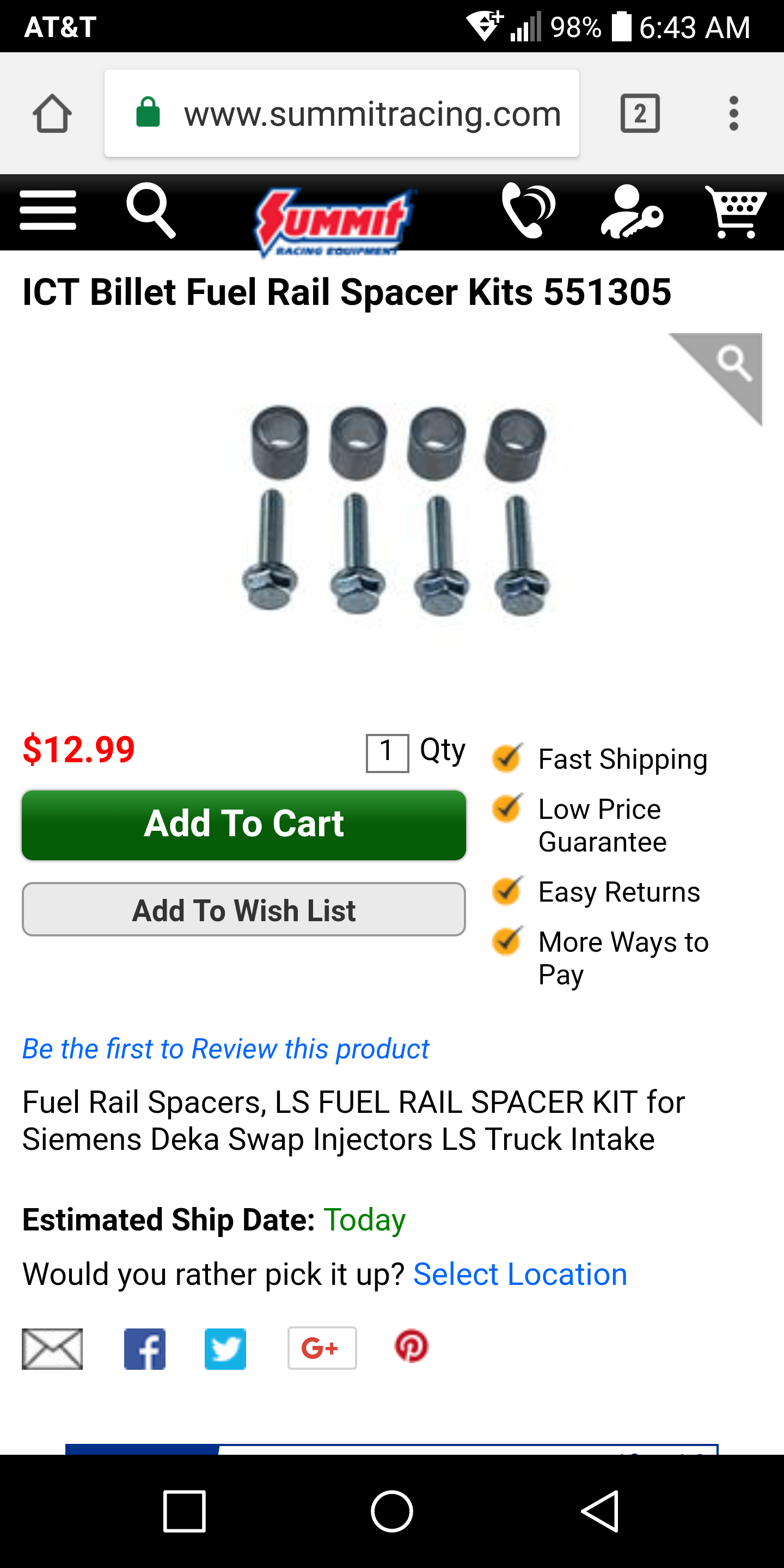

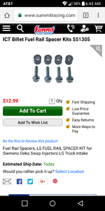

found a deal on a set of injectors recently that are longer than I needed but couldn't pass up the deal. I knew I would have to space up the fuel rail to accommodate them and figured I'd just find something from the hardware store to make it work for cheap. ended up finding this instead, probably more expensive than whatever I would have found elsewhere to space it up but saved me the time and trouble. .5" spacers and bolts made to space up truck fuel rails

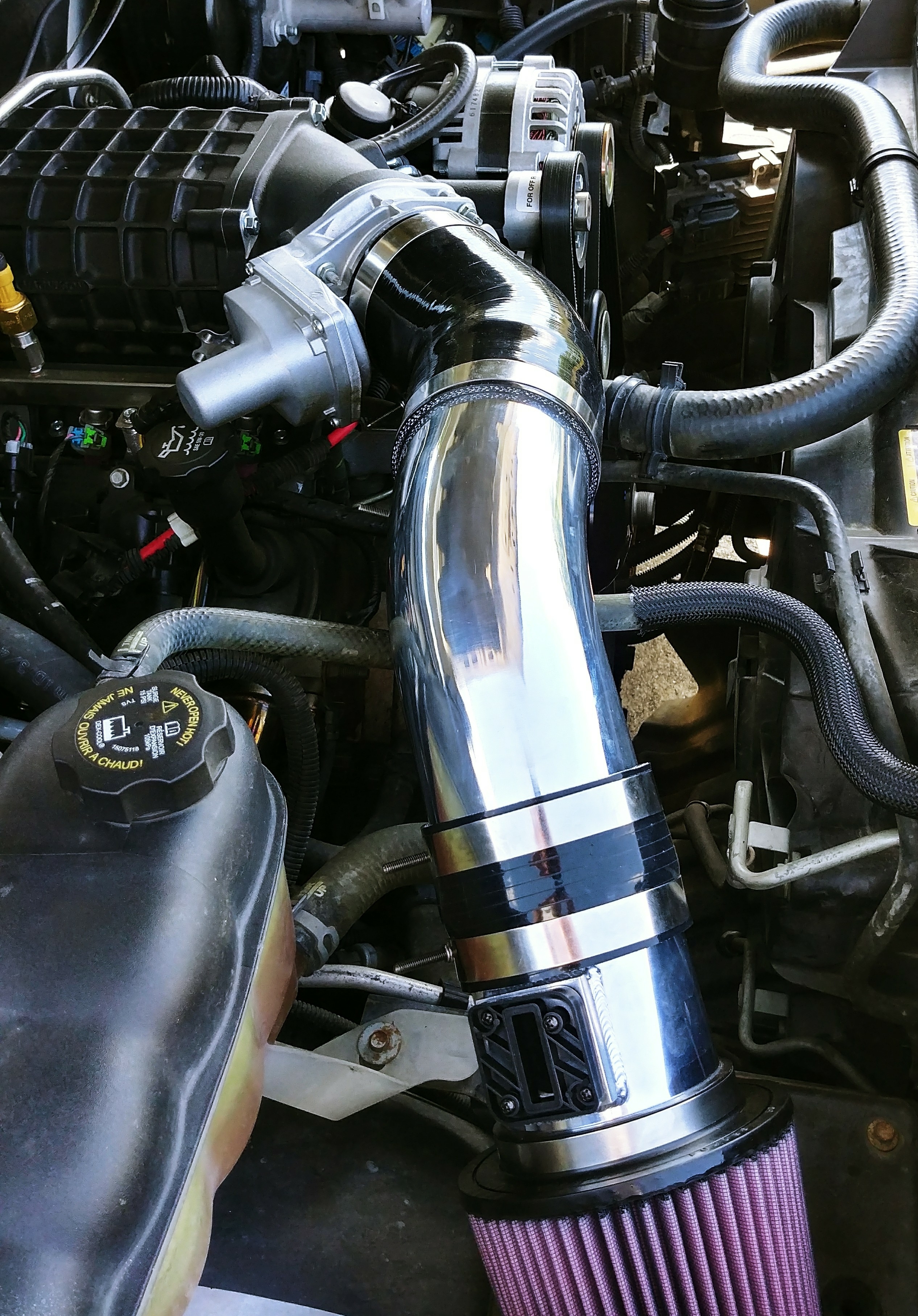

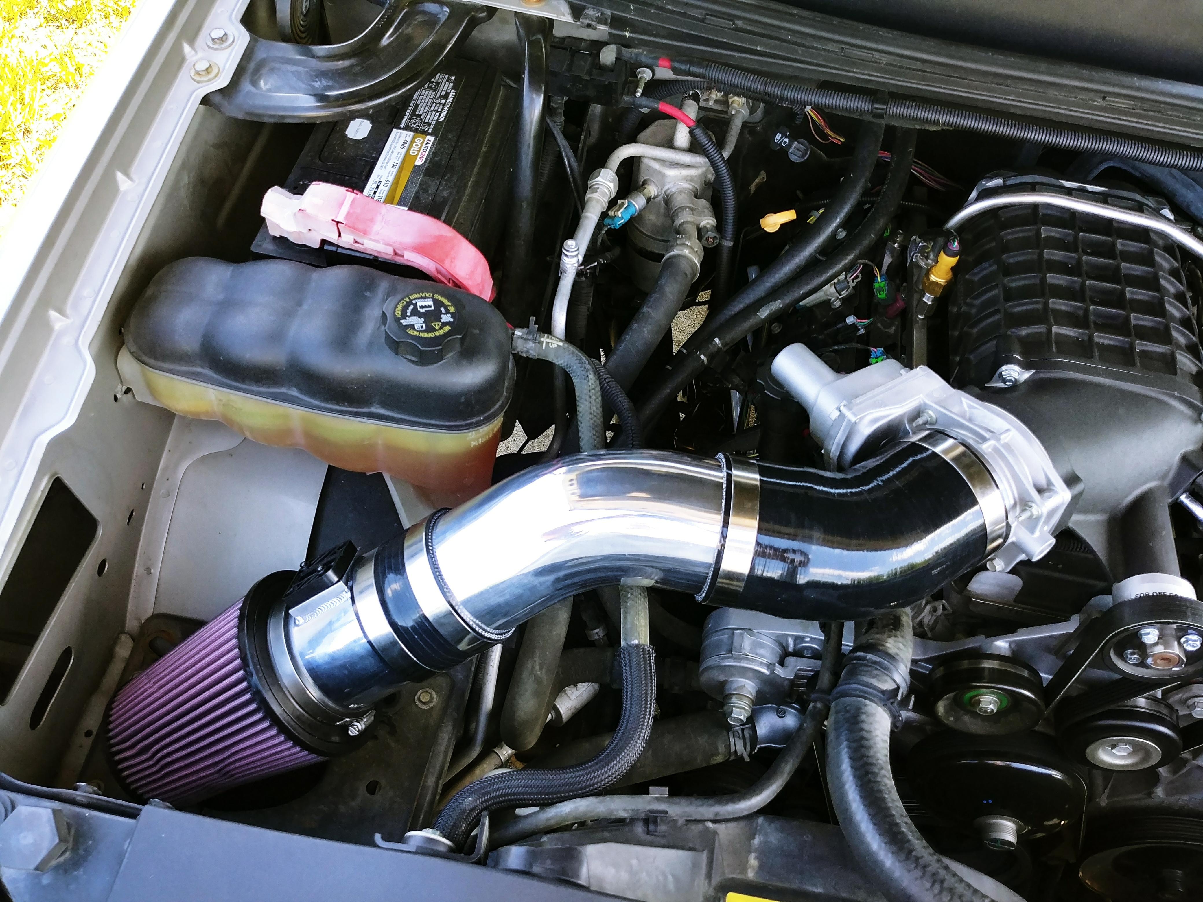

finally pieced the 4" intake together with tubing from siliconeintakes.com. adjusted everything and tightened it up so I could remove it as one peice. can't use it until retune since I'm swapping to card style MAF but at least it's ready to install.
Attached Thumbnails CHRGDUP Denali-20180425_144647_hdr%7E2.jpg   CHRGDUP Denali-20180425_144713_hdr.jpg

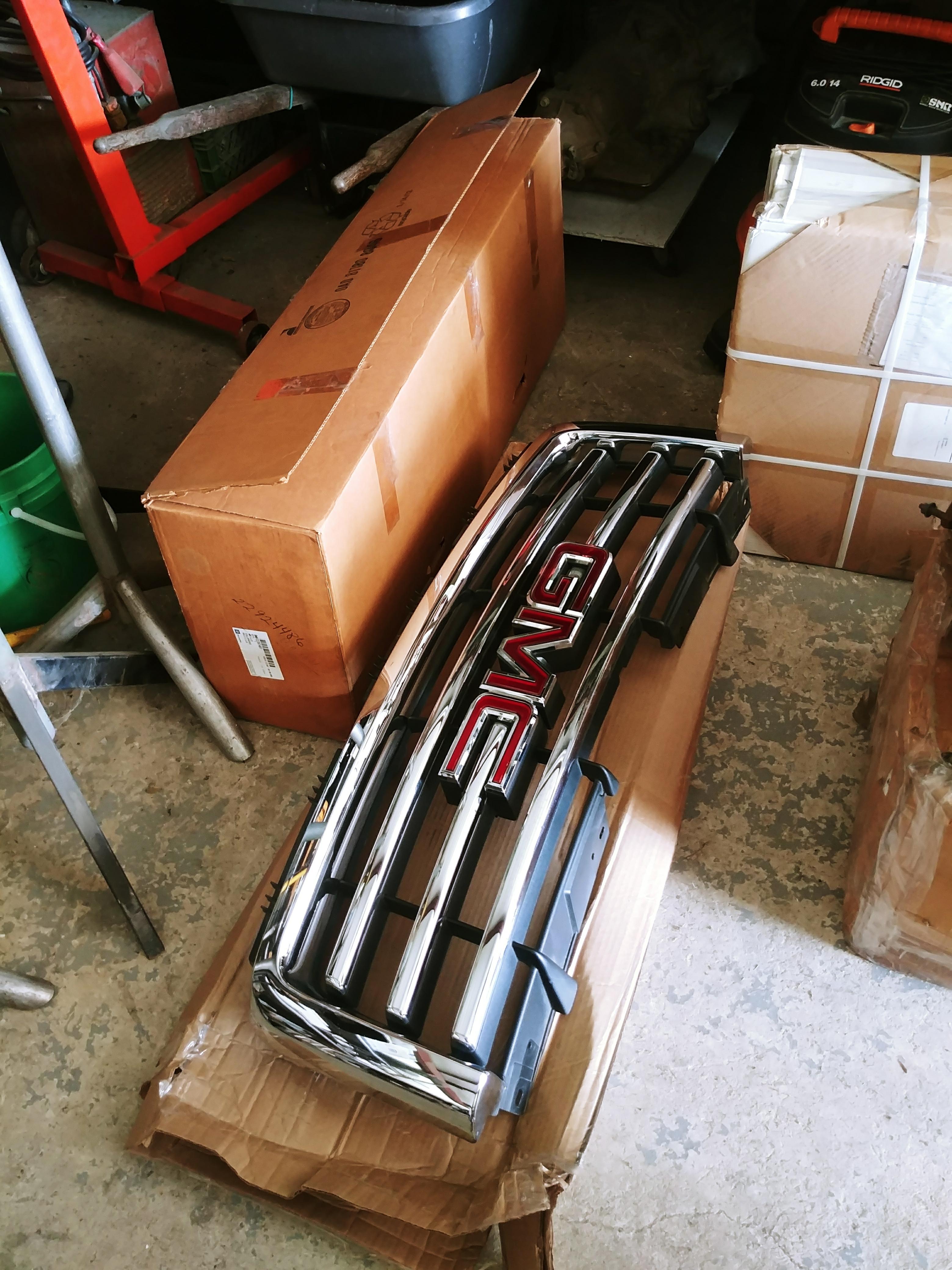

New grille and valance

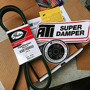

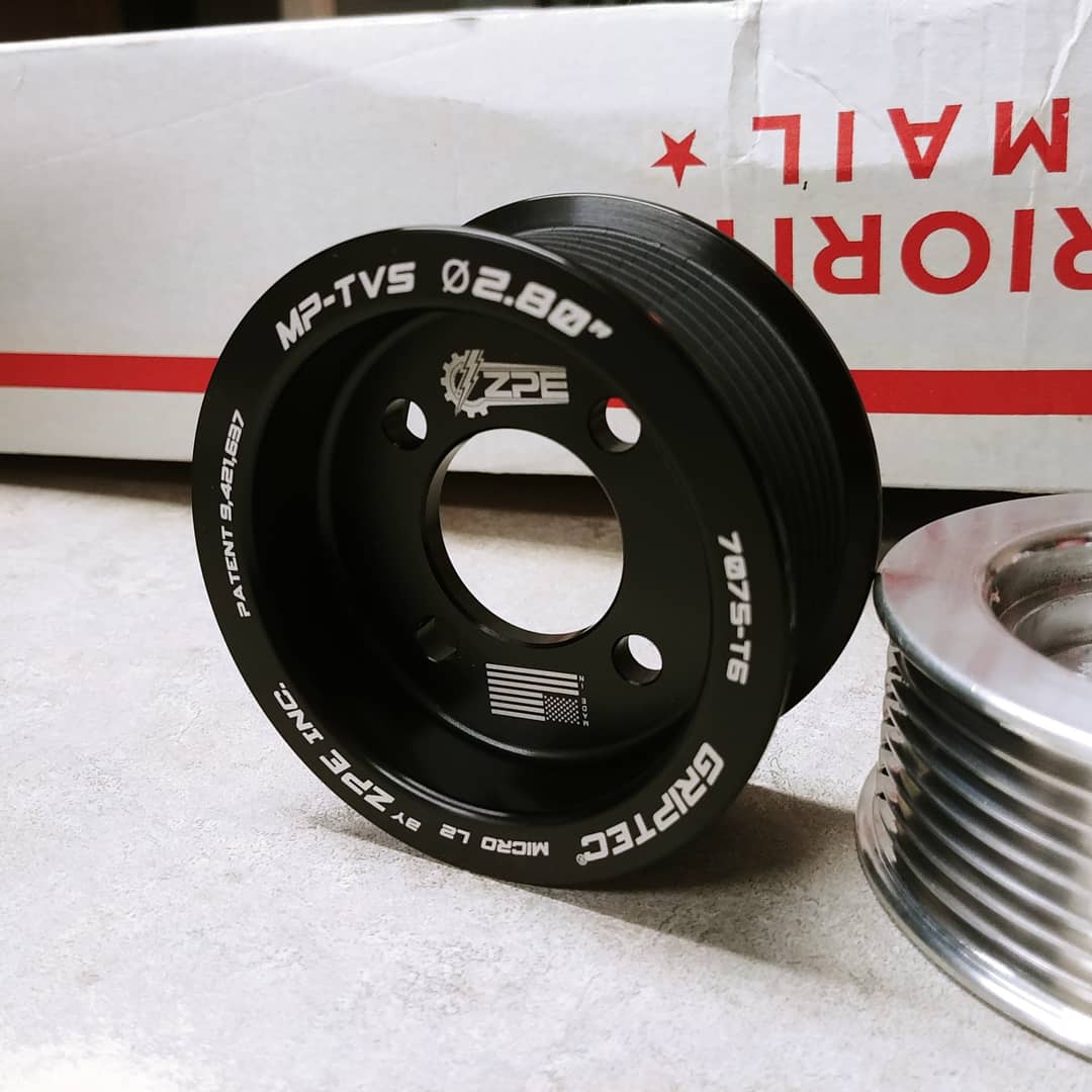

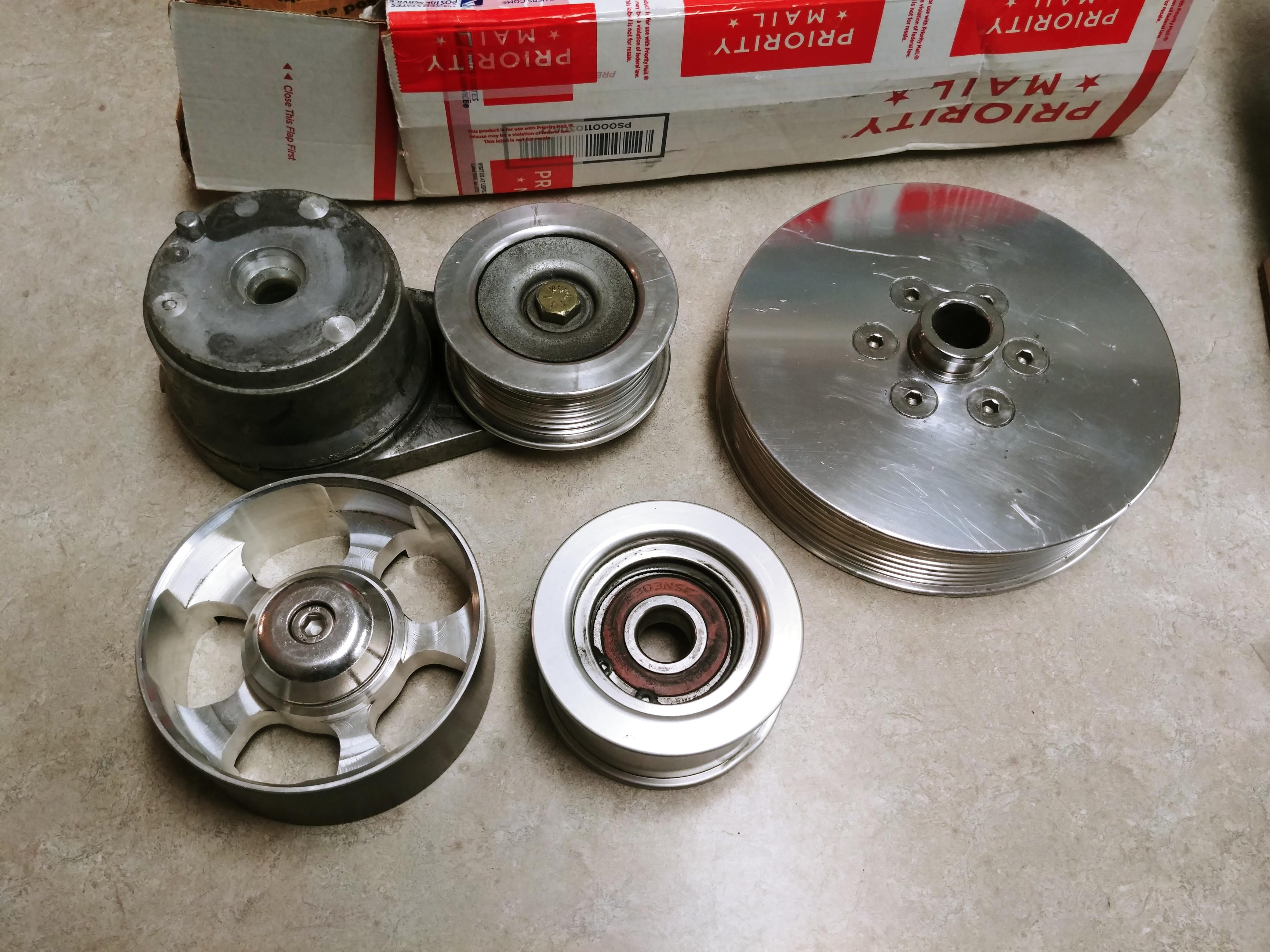

Got some goodies today. Will be installing a lot of parts soon before my next retune including 83lb injectors, 4" cai with card style MAF, 90mm tb and exhaust (already installed), IW 8 rib pulleys, overdrive Ati super damper, and 2.8 griptec. Should wake up the beast a lot.

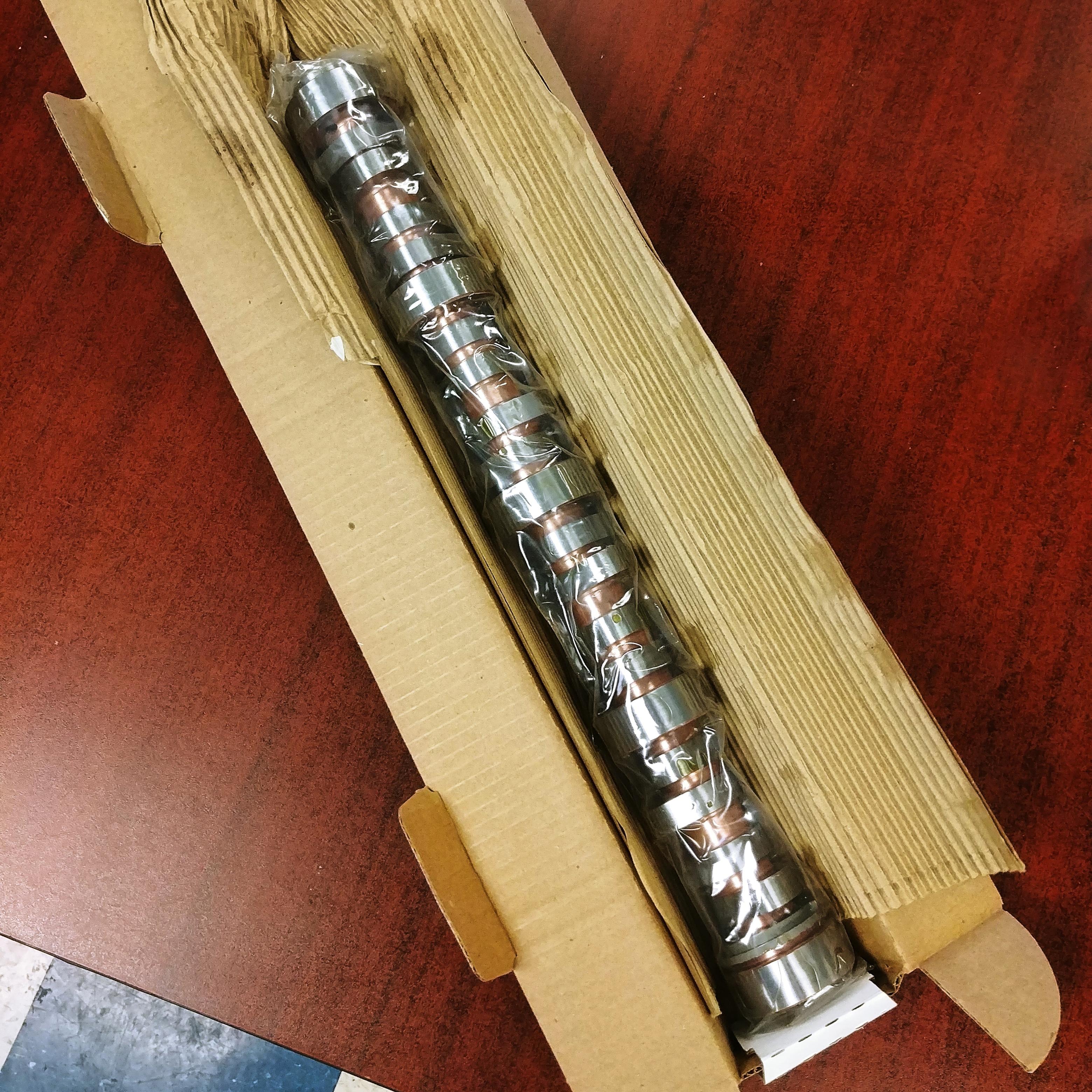

I also had a cam specd for it (218/236 .612/.612 116+4) but do not plan on installing until later on. I went to a car show and someone won a "free custom specd cam" coupon from a local shop I wanted to use anyways, so I bought it from them at a discounted price and got one specd and cut, but plan on buying the supporting goodies later on to install. That should also wake this thing up.
Attached Thumbnails CHRGDUP Denali-img_20180611_154535_973.jpg   CHRGDUP Denali-img_20180529_105931_945.jpg

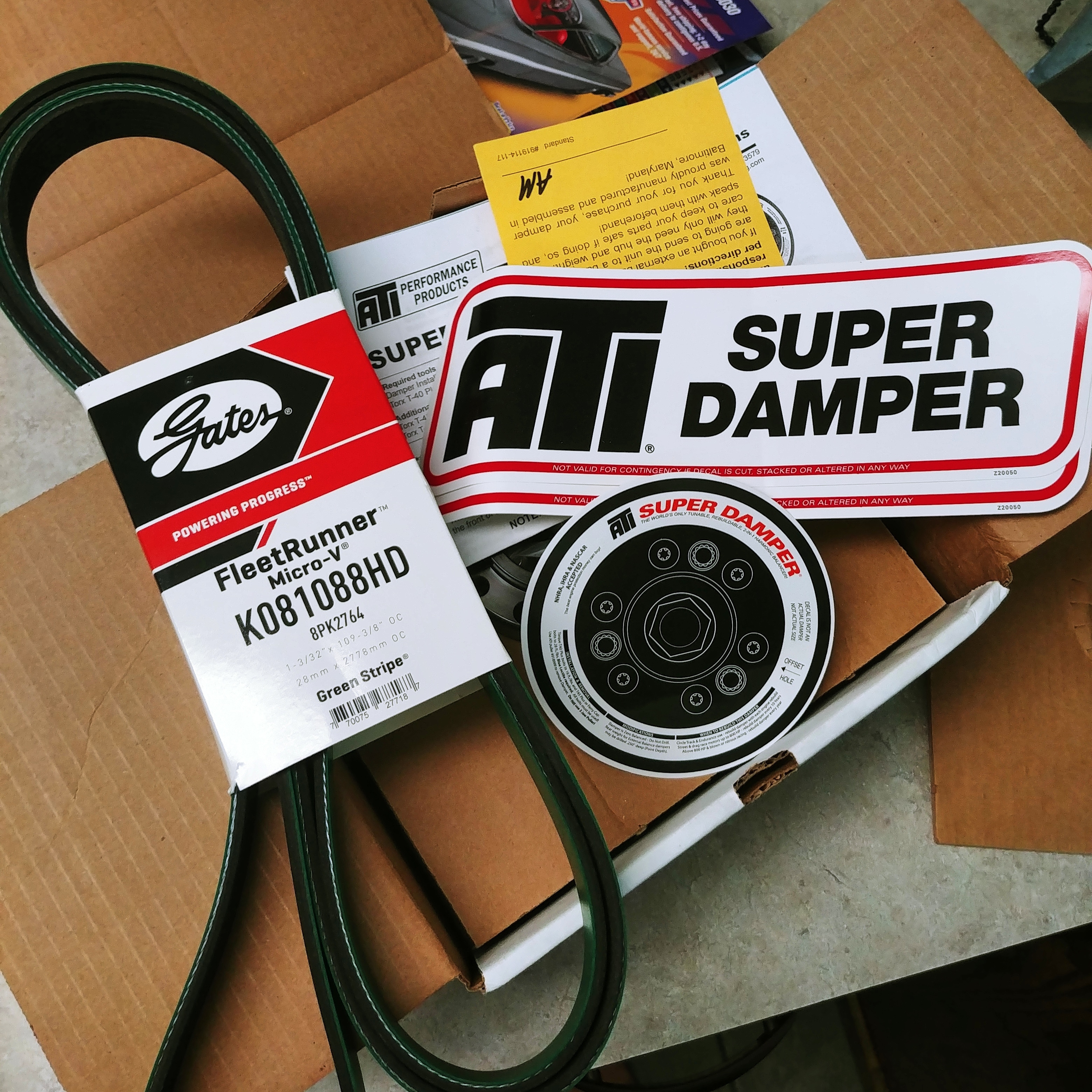

Some more goodies
Attached Thumbnails CHRGDUP Denali-20180614_201927.jpg   CHRGDUP Denali-img_20180614_202400_712.jpg
