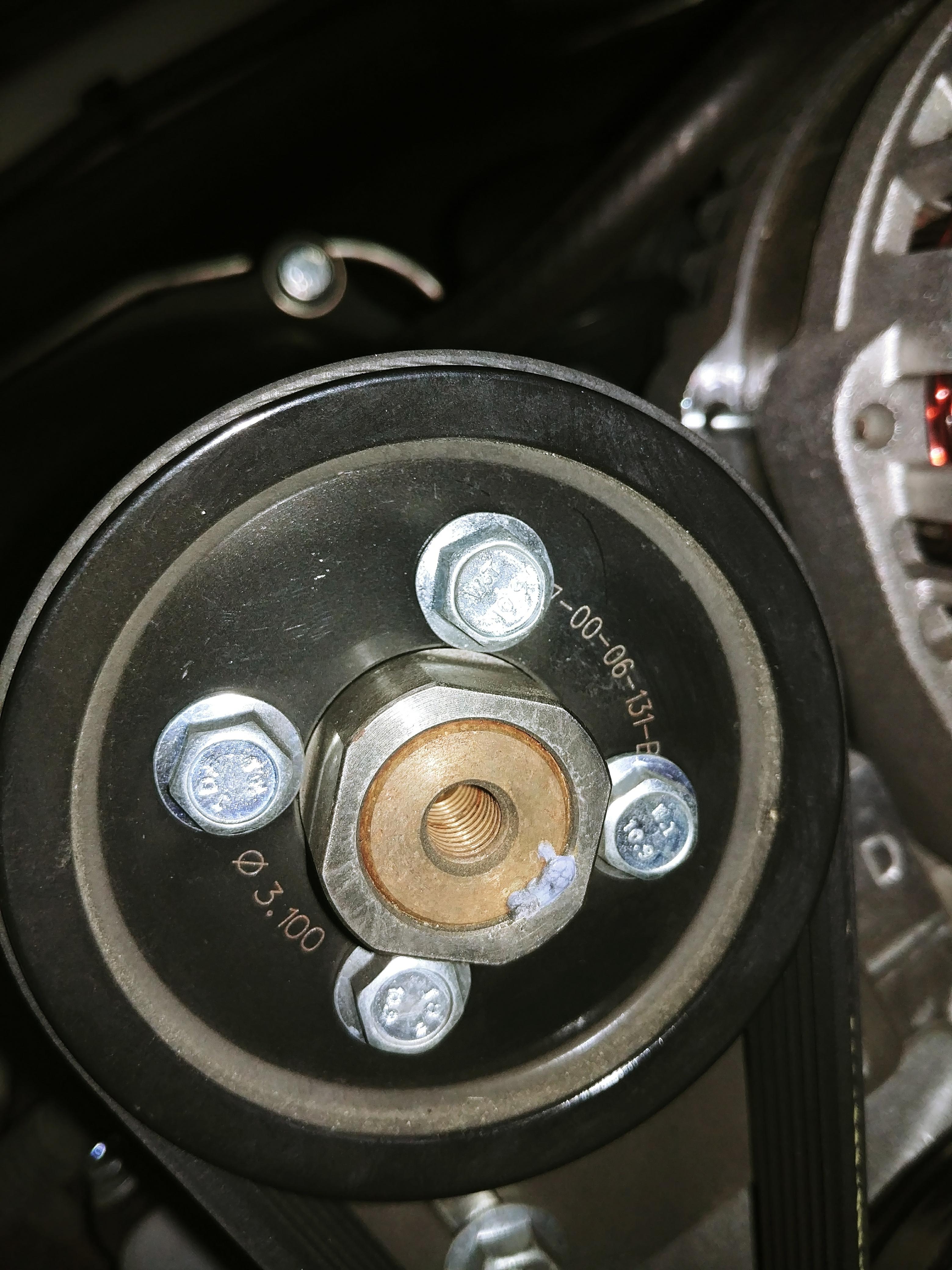

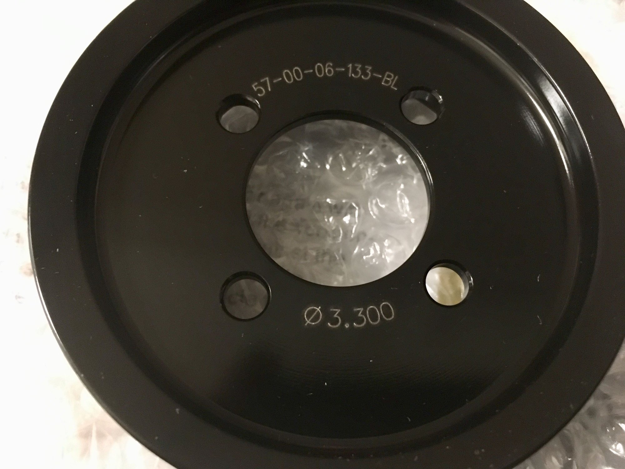

Kit came today...it came with a 3.30" pulley which it say is supposed to be for 6PSI...gonna order a 3.10" and then see where Im at boost wise...I don't really wanna have to add a methanol setup
Old Apr 17, 2018 | 08:24 PM
  #87
CHRGDUP_Denali's Avatar
Joined: Nov 2016
Posts: 191
Likes: 7
From: Baton Rouge, La
weird that mine came with a 3.1. is yours a tvs1900 or 2300?

Definitely a 1900 kit, I just verified, you had me excited for a second they screwed up and sent me a 2300 kit lol....yah thats really weird...its part number 01-19-60-019-BL which comes up as 11-13 GM SUV 6.0/6.2....
The part number for the truck kit is different 01-19-60-015-BL which comes up as 09-10 GM TRUCK 6.0/6.2 but I would think the kits would be identical, the engine bays are pretty much identical part for part
Old Apr 17, 2018 | 09:02 PM
  #89
Joined: Nov 2016
Posts: 191
Likes: 7
Mine was the MAG011960007 for 07.5-08 Silverado/Sierra with 6.0/6.2. not sure why the pulley size would be different though. your kit may have came with different injectors than mine also since yours is probably flex fuel.
