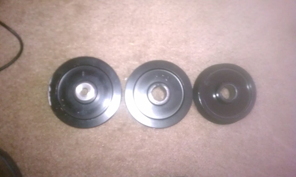

New pulleys. 3.85, 3.7 and a 3.6

Get the fuel figured out and I'll help you tune it for the 3.6 this weekend o.O

smokeshow, was thinking about putting the 3.85 on and shifting at 6200rpm. was seeing about 9 psi there with the 4". And I have to work this weekend
