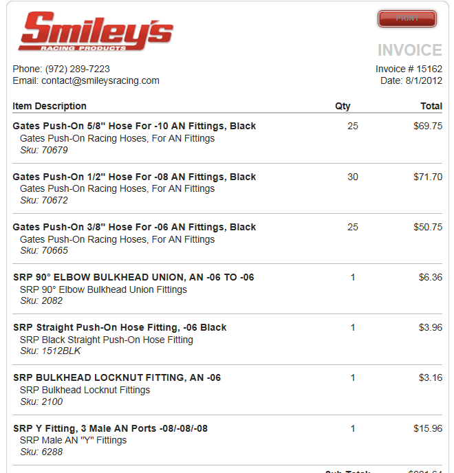

some more parts for the fuel system
all thats left is the FPR, pumps and filters.
