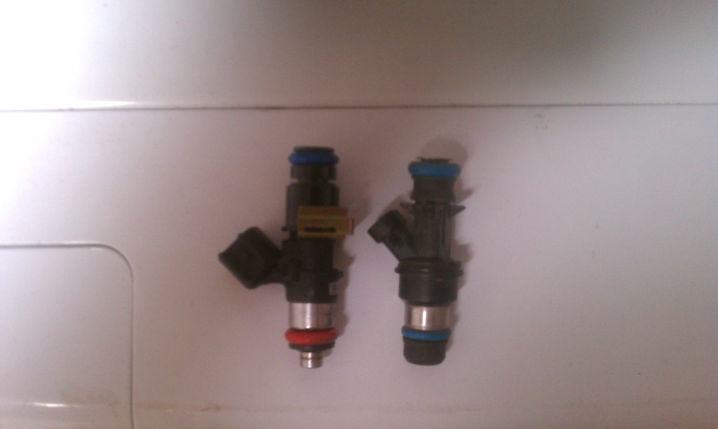

So I got the old fuel rail and vette filter outta there, the Fast 65# injectors and spacers are in and the USCAR connectors are spliced in. All thats left is make the spacers for the fuel rail and find someone to give me a ride to the hardware store because I cant seem to find my longer bolts to mount the fuel rail.
Old Jul 25, 2012 | 07:20 PM
  #590
AndysC3's Avatar
iTrader: (14)
Joined: Jun 2009
Posts: 2,884
Likes: 10
From: Minot, ND
heres a pic of the stock injectors and the fast injectors with the spacer on top.
