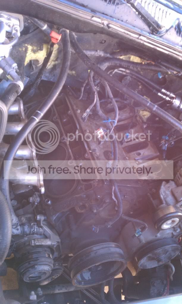

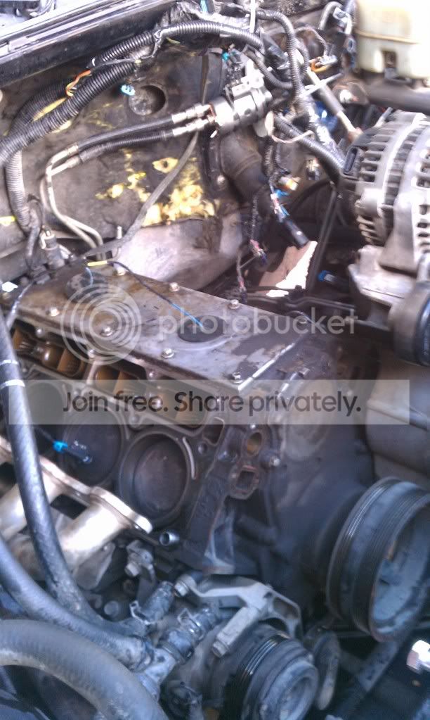

spent about 6 hours working on the truck. Got it most of the way torn down. Had a hell of a time getting the drivers side head off. The head bolts were hitting the header. Had to remove the front driveshaft and drop the header. but it finally went my way. Rented a 3 jaw pulley from auto zone and when I got home the bolt was broken, so I gonna have to get another one.

Damn you're not messing around! When do you hope to have everything all bolted back up? Do you plan on getting some bigger headers or are you going to stick with the pacesetters?
