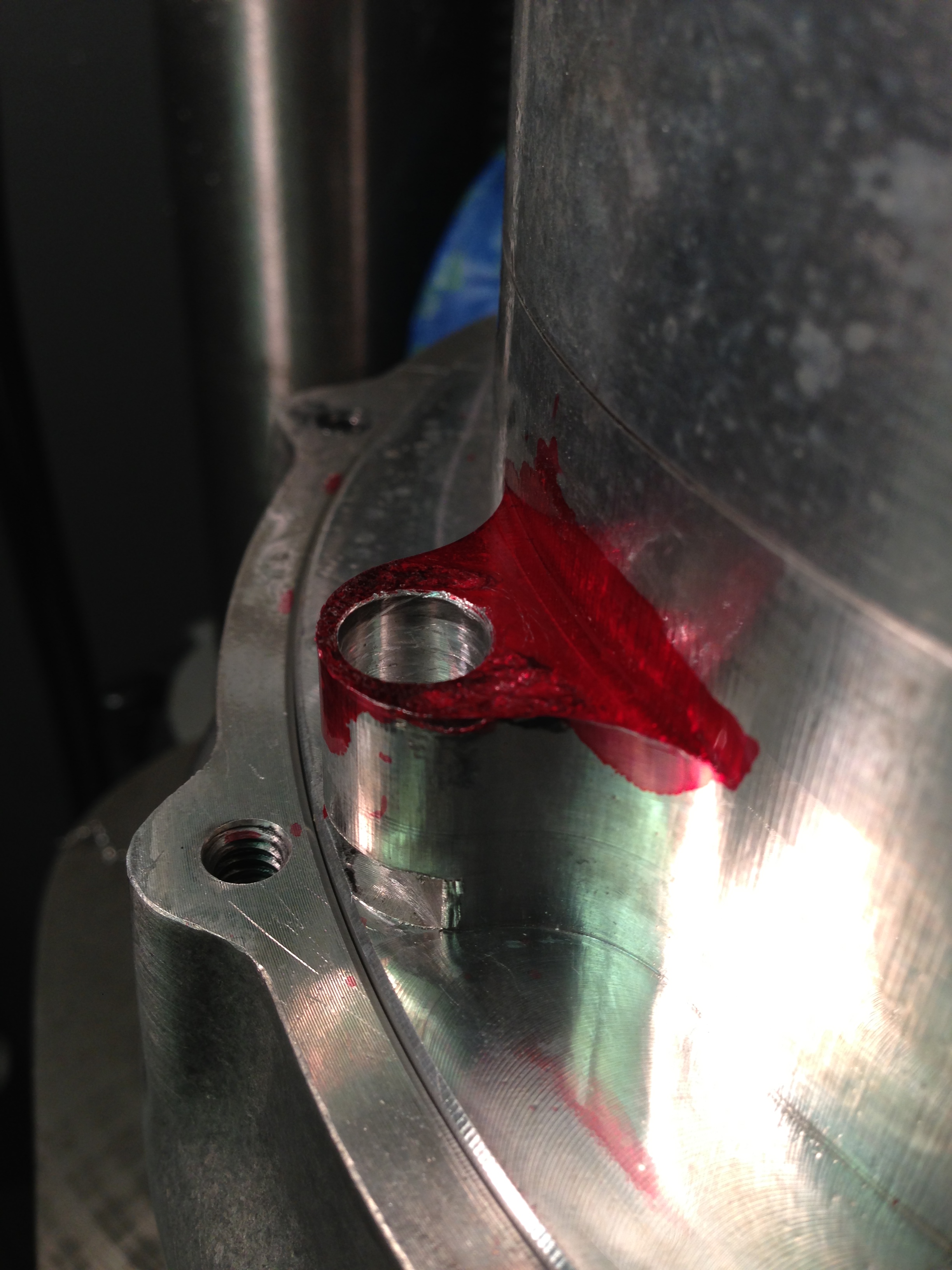

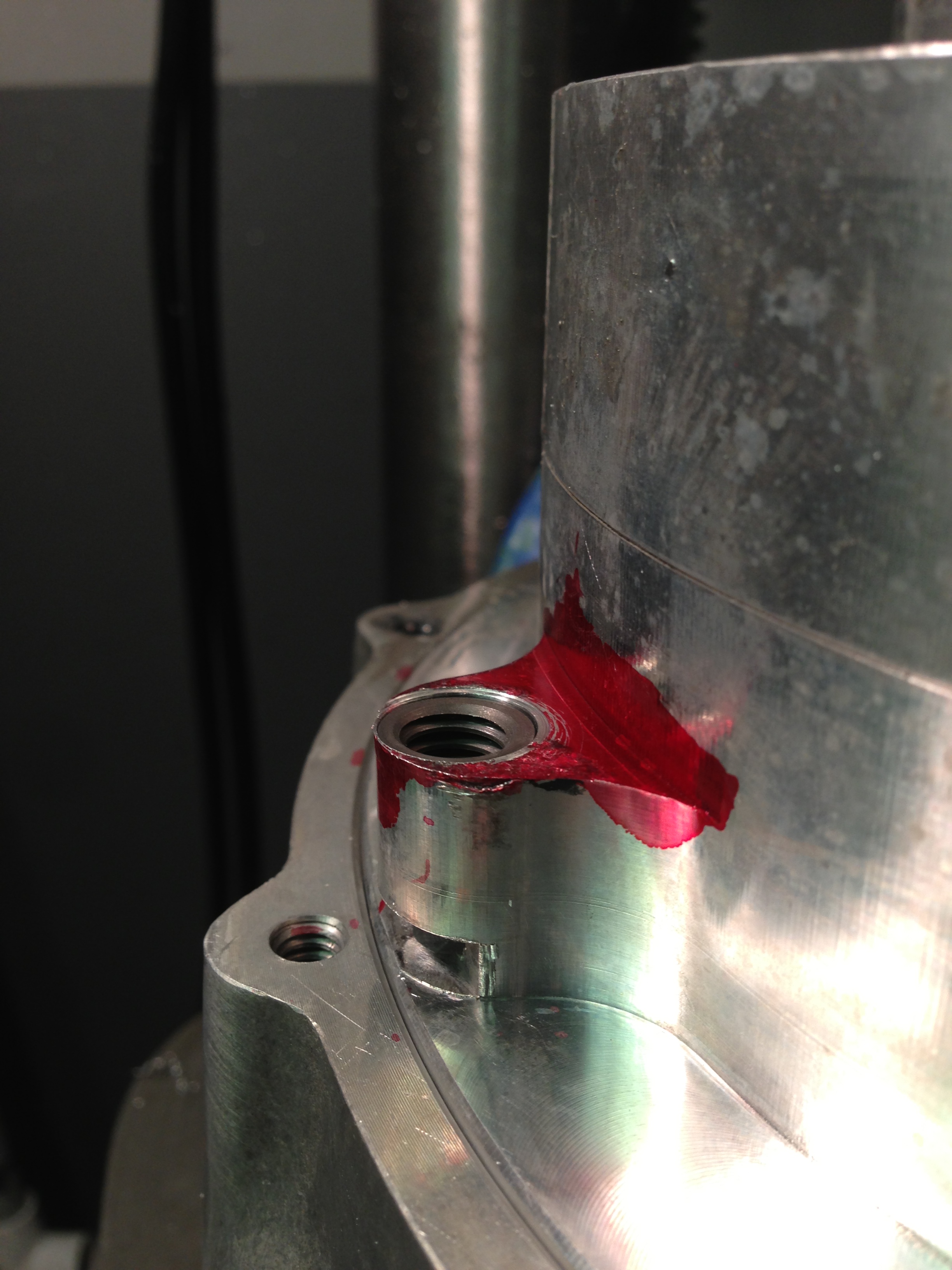

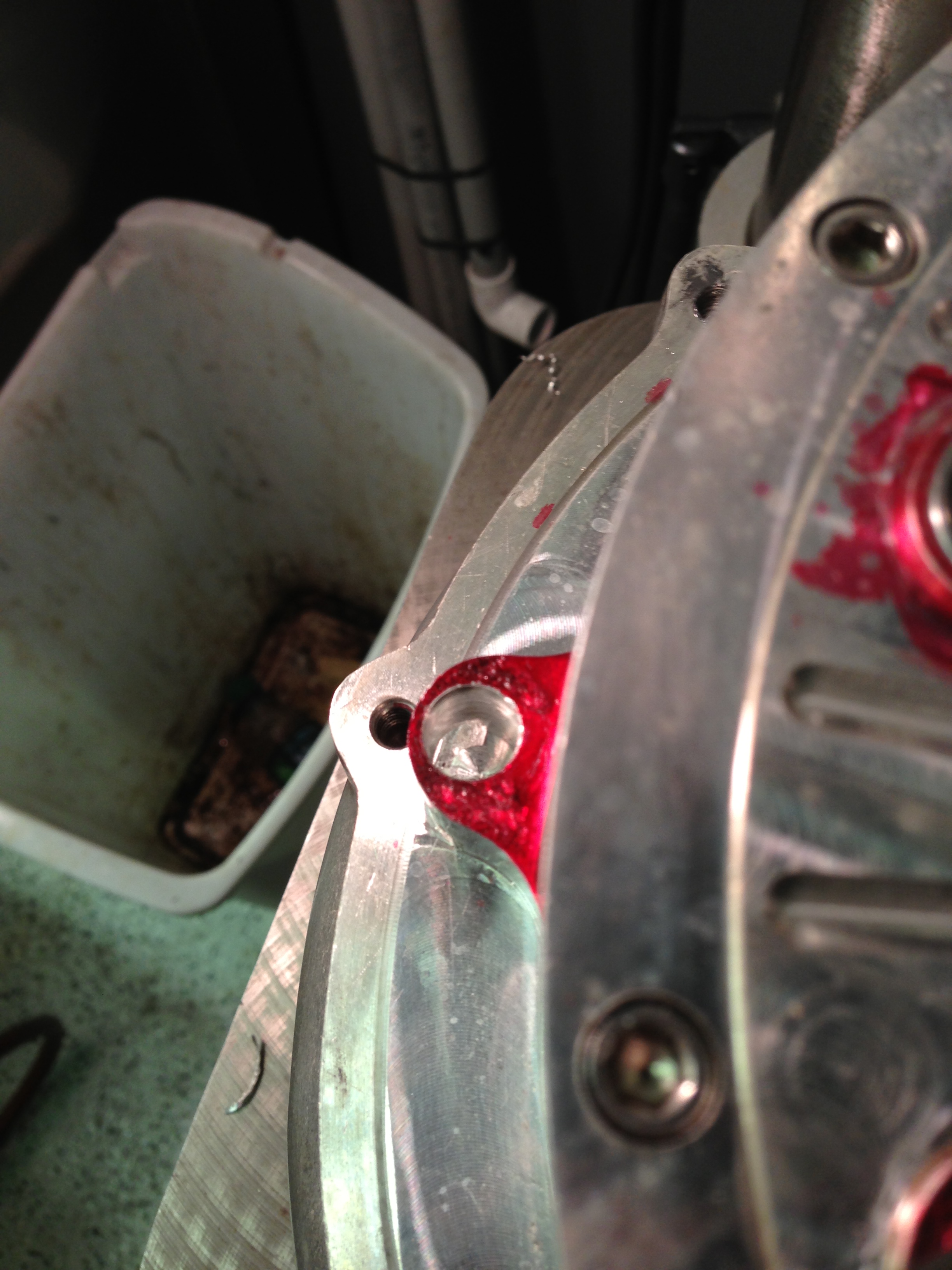

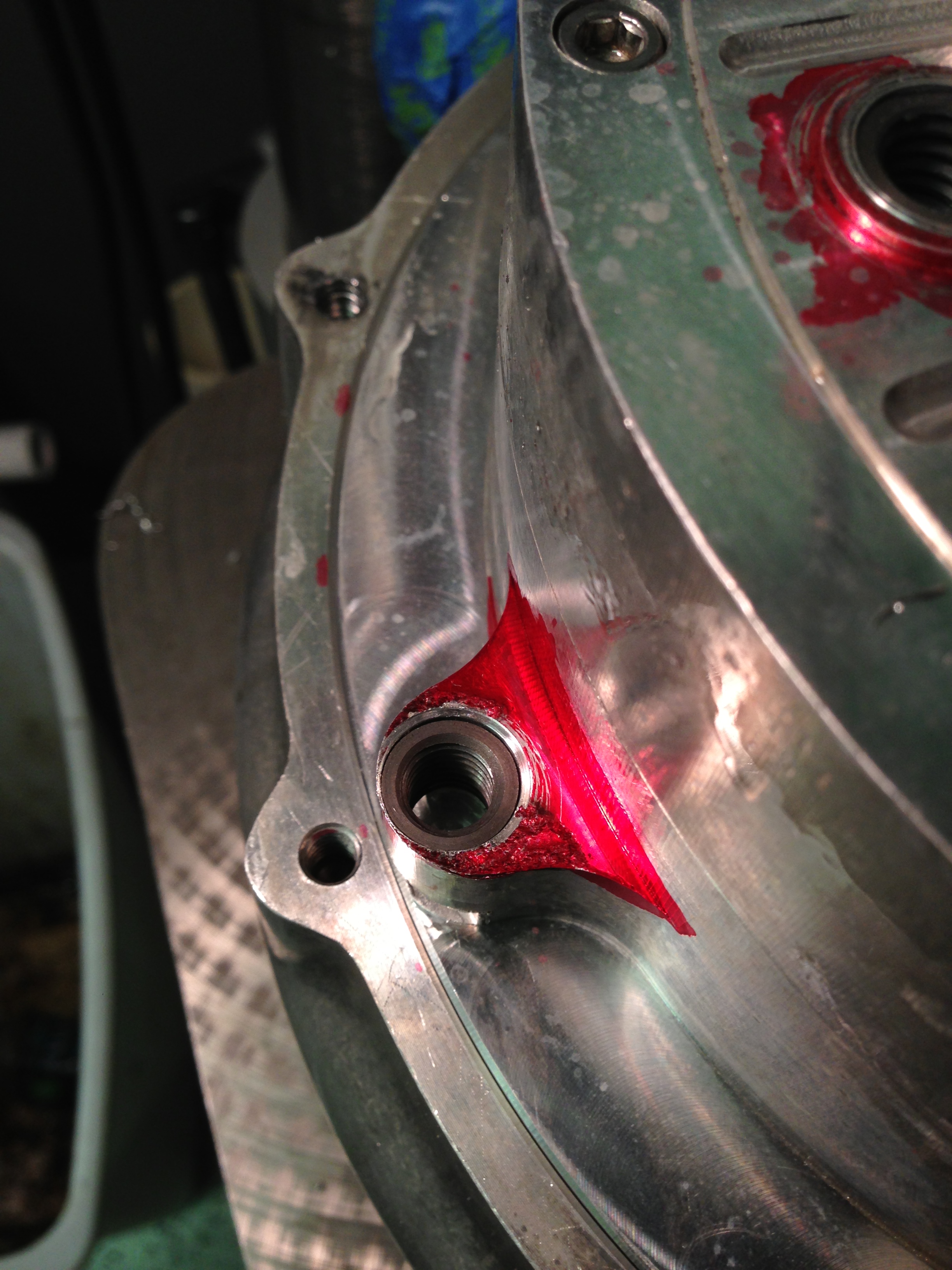

I have had some issues with the mounting holes in the procharger getting worn out, so I decided to time sert all the mounting holes. The holes in the face of the transmission case were no issue, but when I got to the extra 4 holes on the bottom half of the transmission case I noticed that there was not a lot of meat in the tabs at the outer most portion. Anyway, I gave it a go with it rigid mounted in my drill press. Took my time making sure that it was lined up where I wanted and went very slow with the tap and the counter bore for the insert flange. It was a little nerve racking, but I got it done. Here are a few pics, it turned out pretty nice I think.
I was going to do all 4, but really only one needed it. So I decided to only fix that one and not press my luck for now. I'm gonna stud the blower mounts, so with that and all the other holes fixed up with an insert, I should not ever have trouble again. It was a fun little project. You can see in the pics the lack of room to work with. The first two pics are after the hole was drilled with a size X (.397") drill. In the last two, you can see that the counter bore for the insert flange basically goes to the edge of the material.
