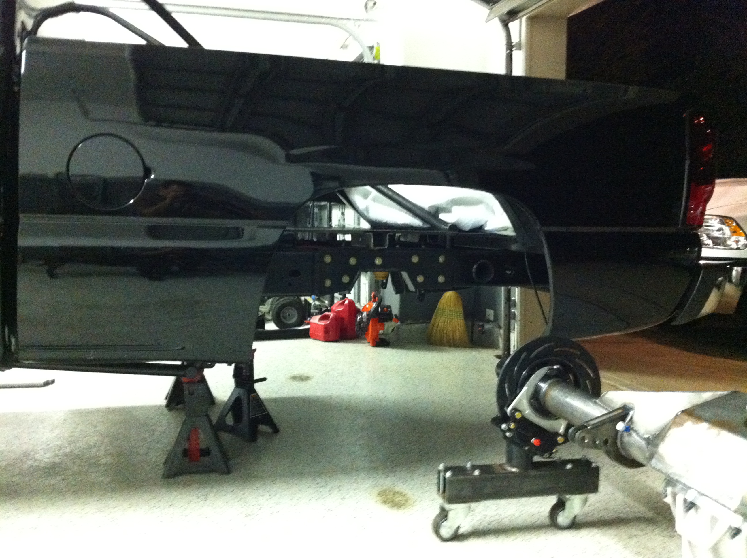

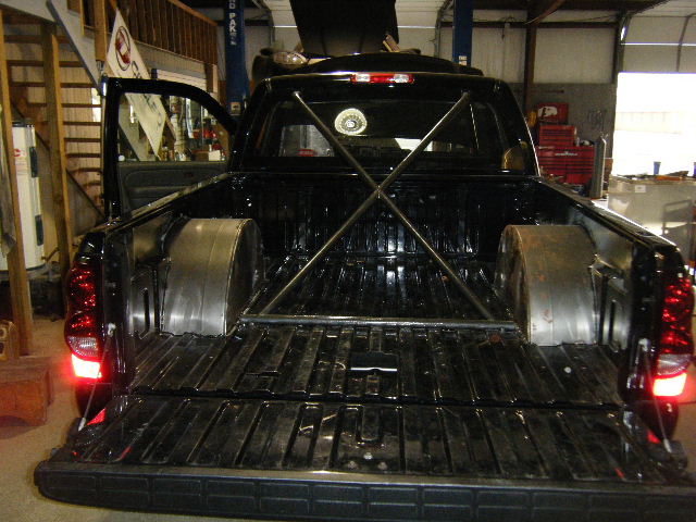

Not quite sure what you're asking. This is really the only good pic I have of the tubs. I'll get some better ones to post up to see if anyone else has a comment.
Here is a pic of the truck before the tubs were installed. I cut the old ones out myself and if you look close you can see that I left plenty material for a weldable attachment point to the bed side.

What is holding your tubs in? Just seam sealer?
What I mean is how your stock tubs where put in there was a flange all the way around the tub under the bed that the tubs where spot welded to your going to need that lip again. I made sheet metal angles and riveted them in and riveted the tubs to that then attached those rods to the tubs just like stock.
To go back to stock tubs like you want that will all have to be remade again or welded in.
the only ugly part is the half moon hole left by the big tubs I would think that will be the hardest part to fix unless you saved the cut outs.
As for the rolled fenders could you not un role them it may cause some distortion in the body but your getting it repainted so any body shop would be able to fix that I would think.
Your box looks pretty mint and hard to get off the truck with that cage you got I would say if you could find a nice replacement box at a wreaking yard or somewhere would be the cleanest way to do it and cheapest I would think.
I'm not a body guy ether but that's how I see it and its just some ideas to try to help your issue.
