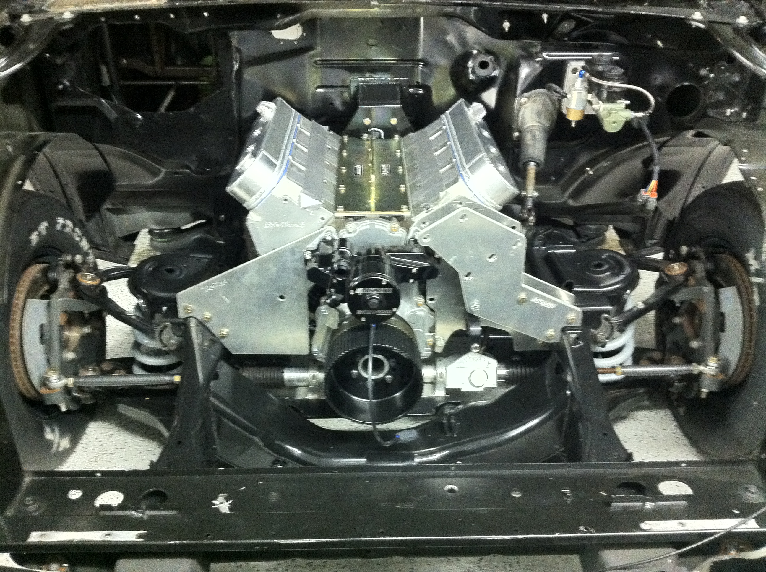

Are you going to reclock the PC? Never seen it routed up like that before.

That's one of the bigger ones, the F2. With a cog belt drive.
Couple steps up from a D1. He'll be making 4 digits with it's all said & done.

I think he's referring to it pointing upward like in photos...

Yes the volute will be reclocked. It's not supposed to be pointing up.
Motor is installed, but I've run into two minor issues with fitment. I'll probably pull it back out fix those issues and put it back in tomorrow.

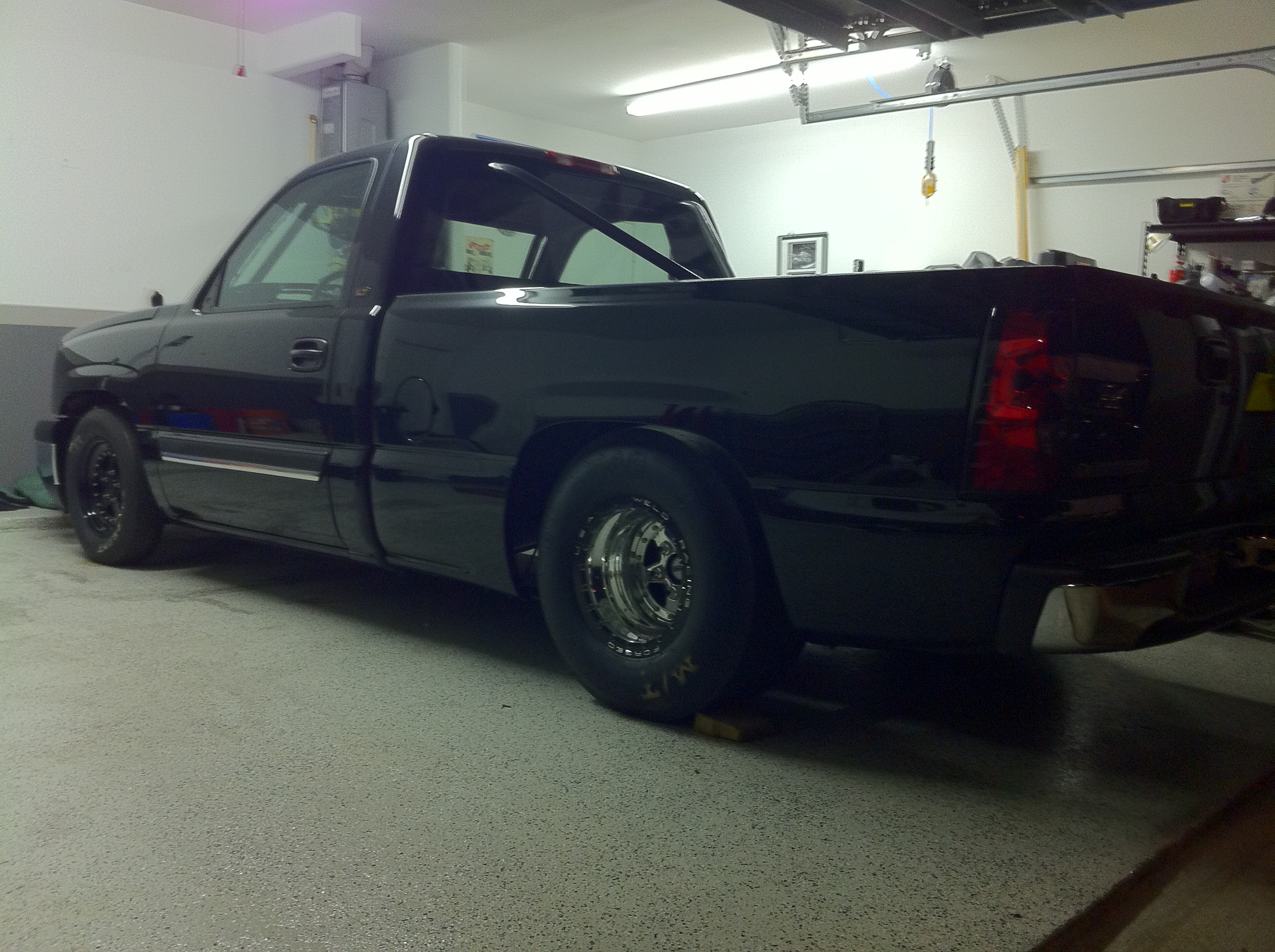

Thing looks crazy sick with this new wheel combo. The rears are 15x12 double beadlocked alumastars with a 29.5x10.5 ET Drag, fronts are the same ones I had but I sent them back to Bogart to get anodized black. Here are some pics....

Looks great! I think at this point, lots of people have high expectations of the truck! I know I do.

Oh I know it's an F2 and makes my D1 look like a baby LOL. I was just under the impressions for proper oiling or something all procharger had to have the volute at a 6 o'clock position or close to that.
^^ Yup
Gotcha. Badass setup for sure man. Can't wait to hear it

Awesome! Absolutely love it brother!

That looks perfect man. Glad to see some progress
