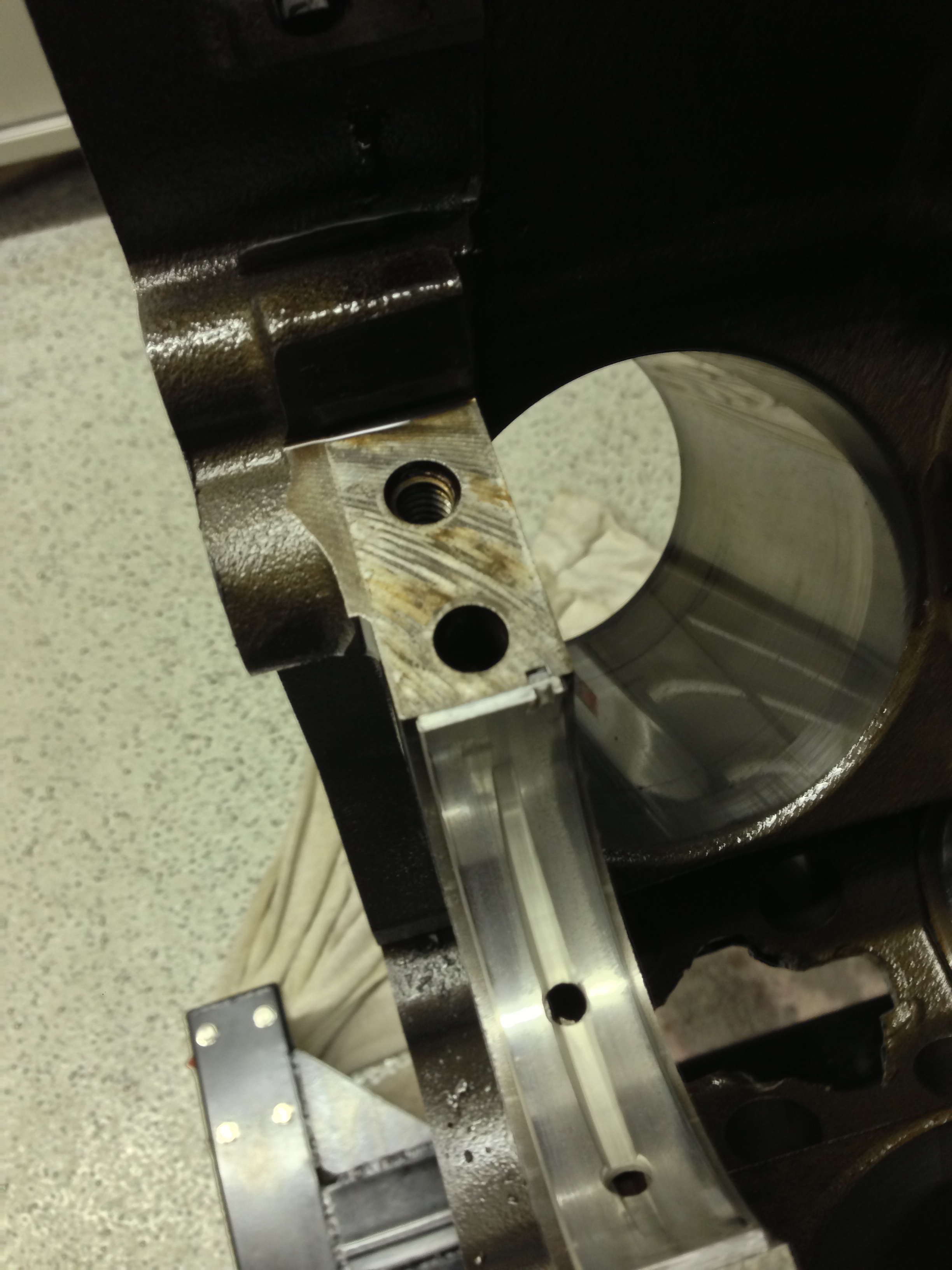

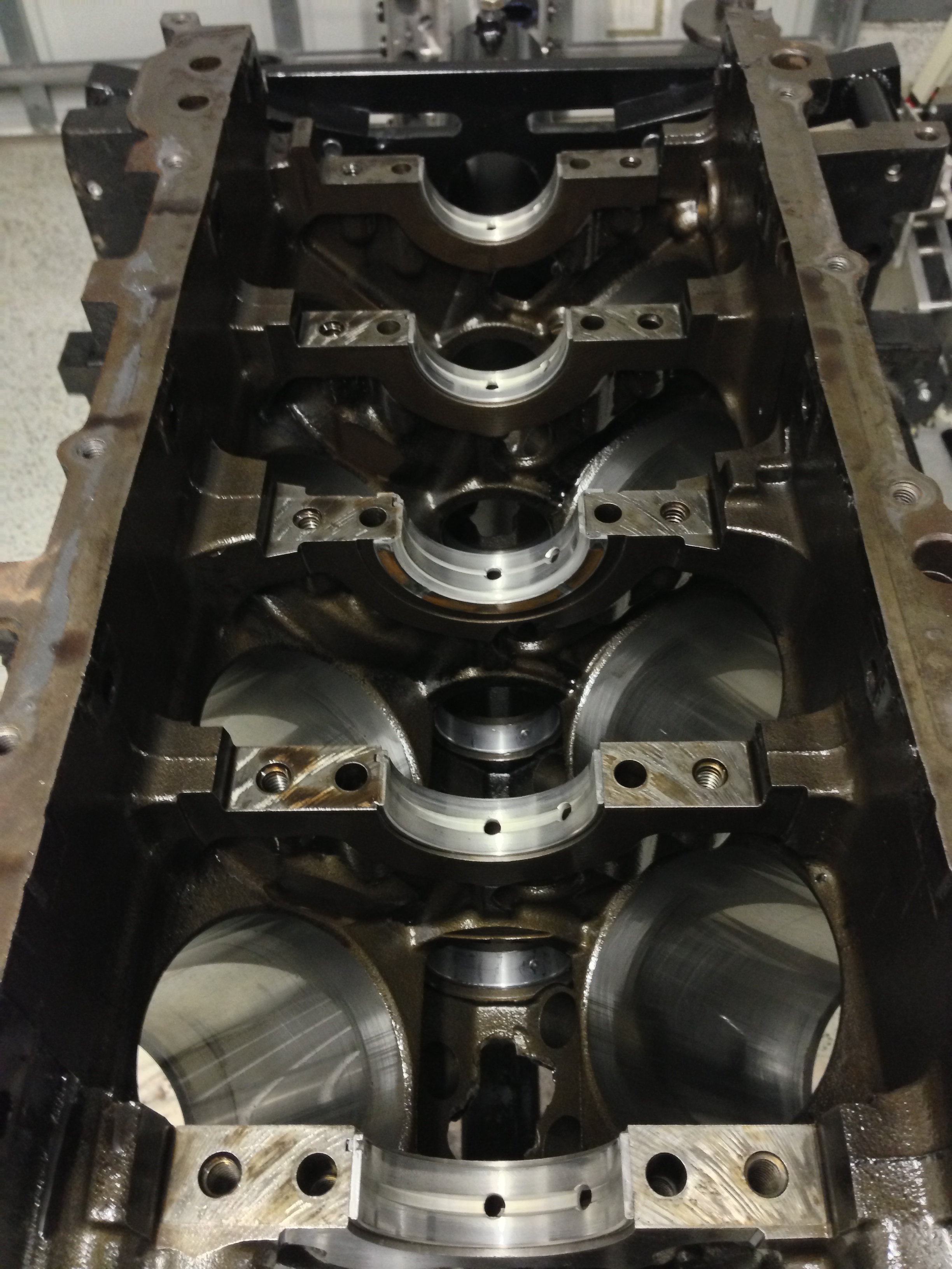

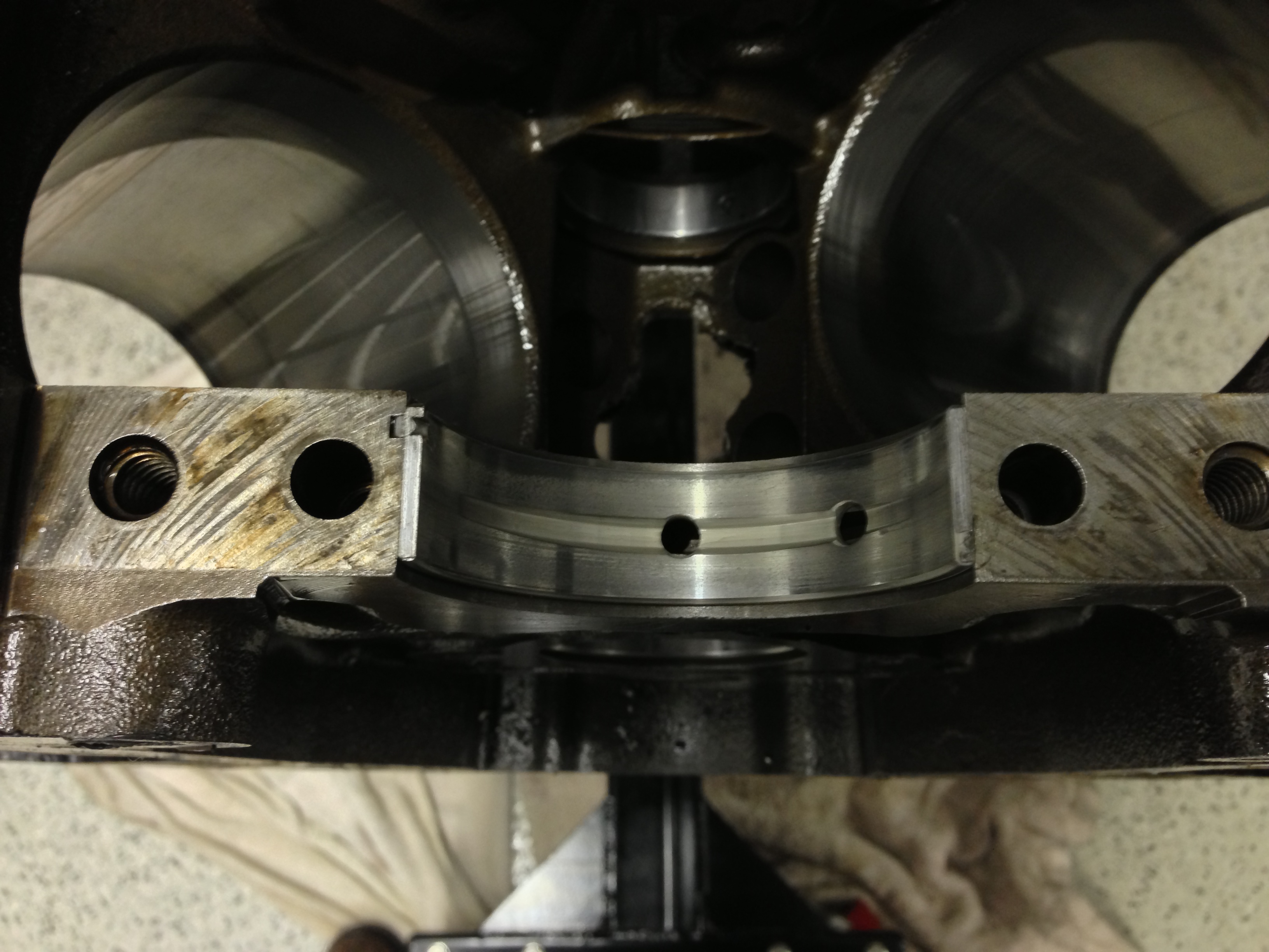

For those that say side slinger prochargers wipe out front main bearings.....I show you this. For those that don't know this thing drives an F2 with no crank support. A testament to my engine builder.

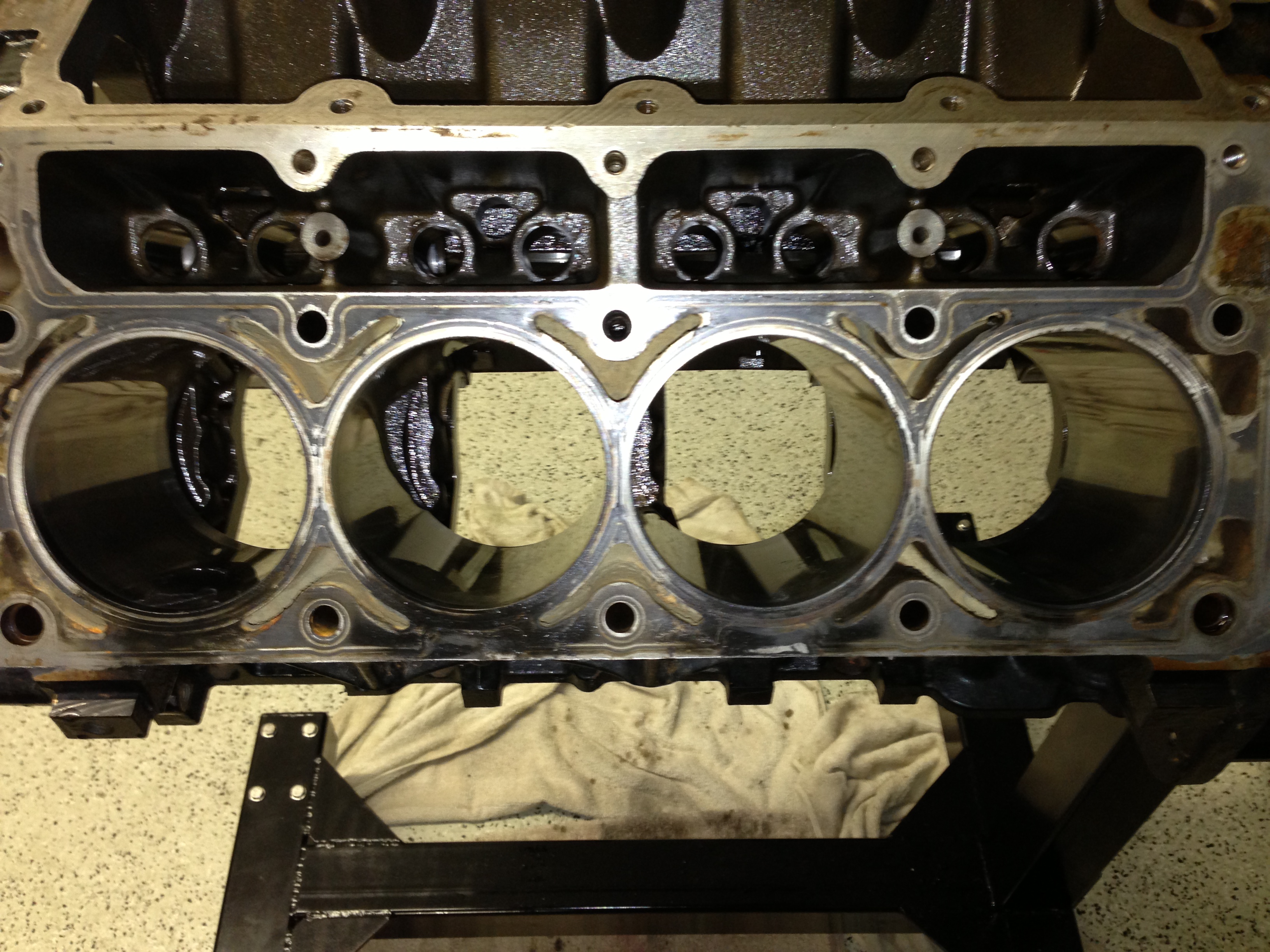

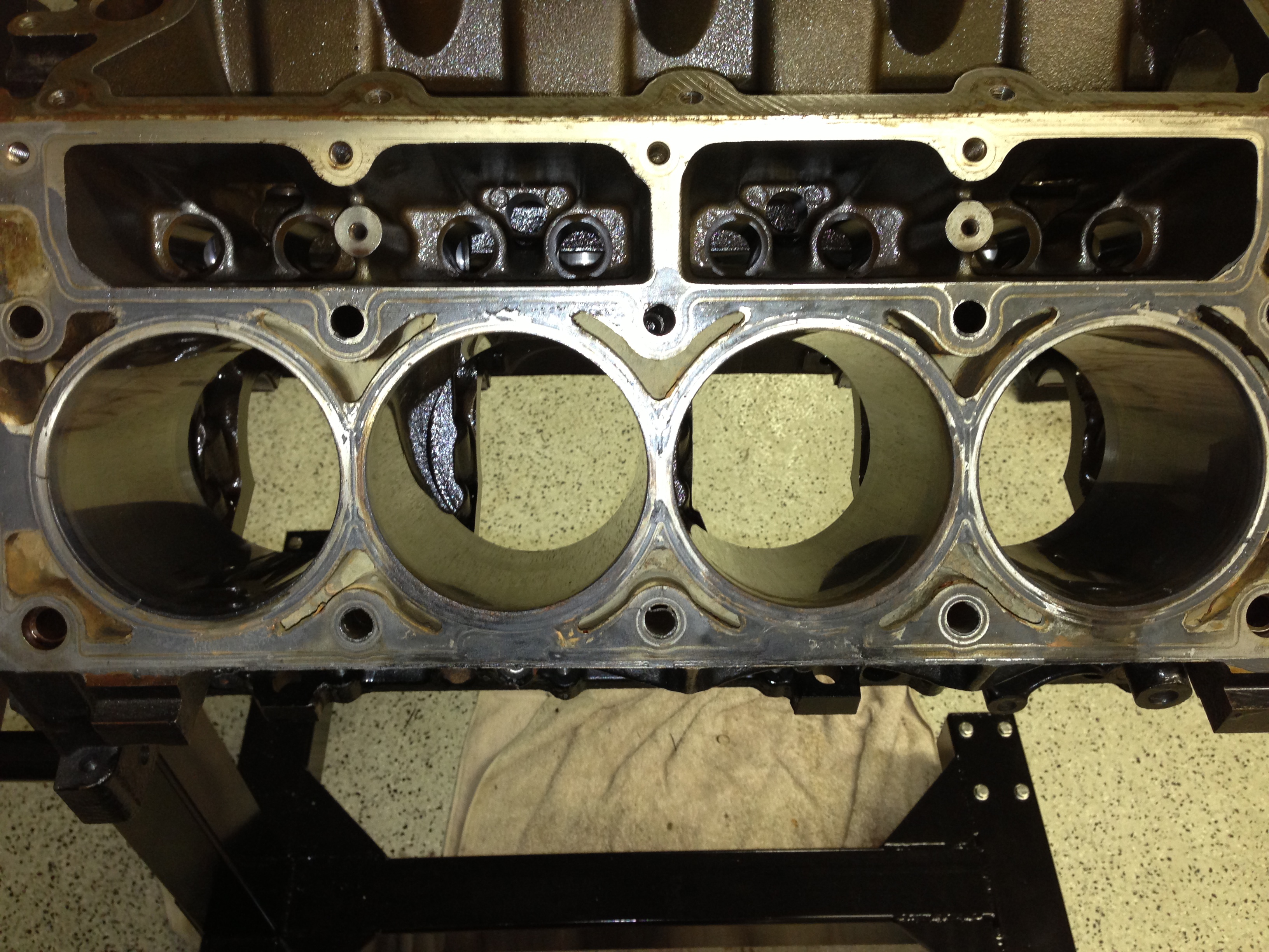

Here are two pics of the decks on the block. You can see it was hurt pretty bad. I guess the cool thing is that it was hurt like this when it ran 8.99. Would have loved for the go-pro to be under the hood while this took place.

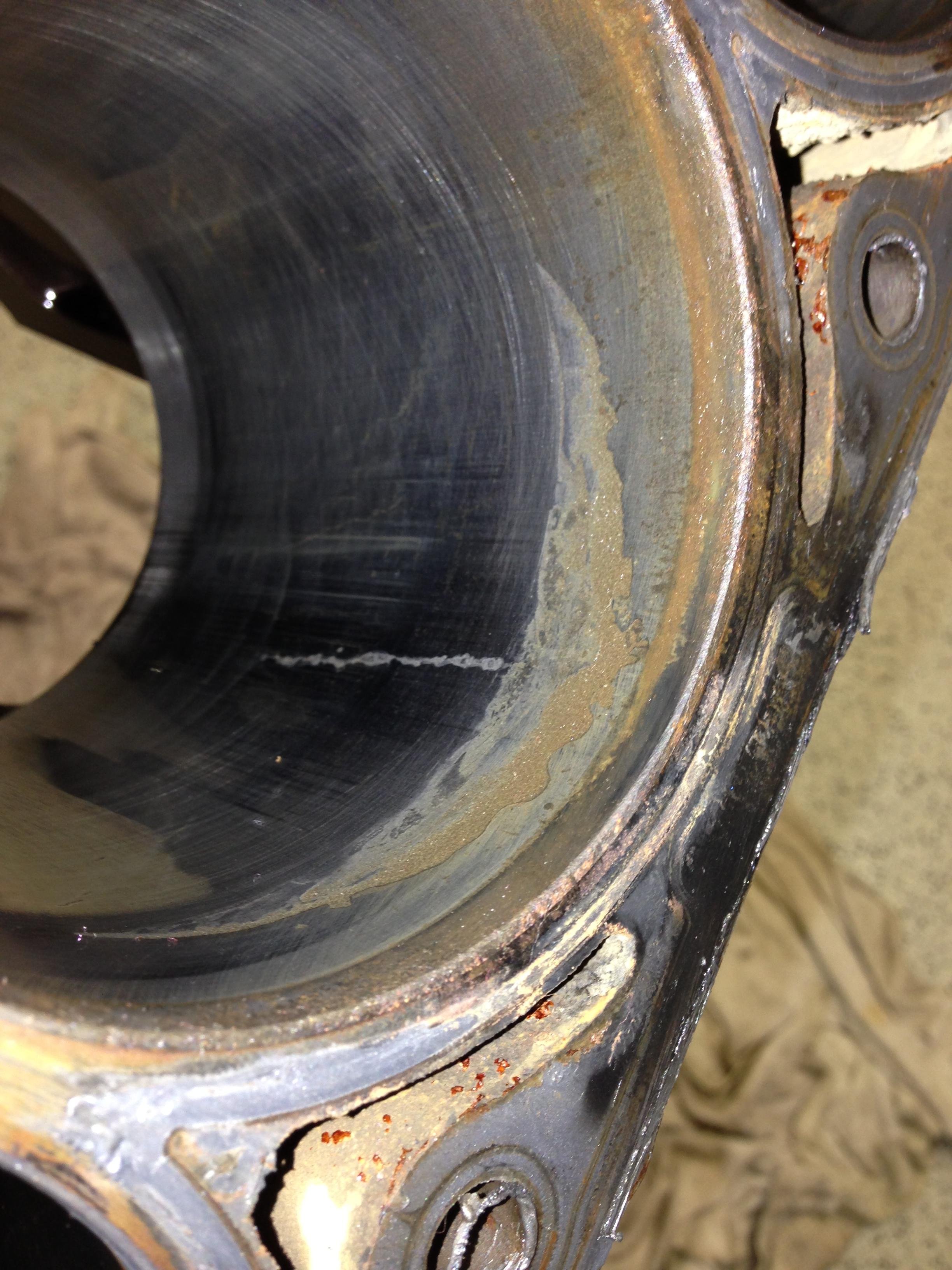

Here is a pic of the worst cylinder damage. The damage is from it sitting with water in the hole (I had no idea it was this bad). This was realized when I couldn't get the plugs out of it cause they had seized up from the water. Hoping that the cylinders will clean up with a slight hone job and a set of rings. If not, I'll just get another 6.0 block as the pistons are fine.

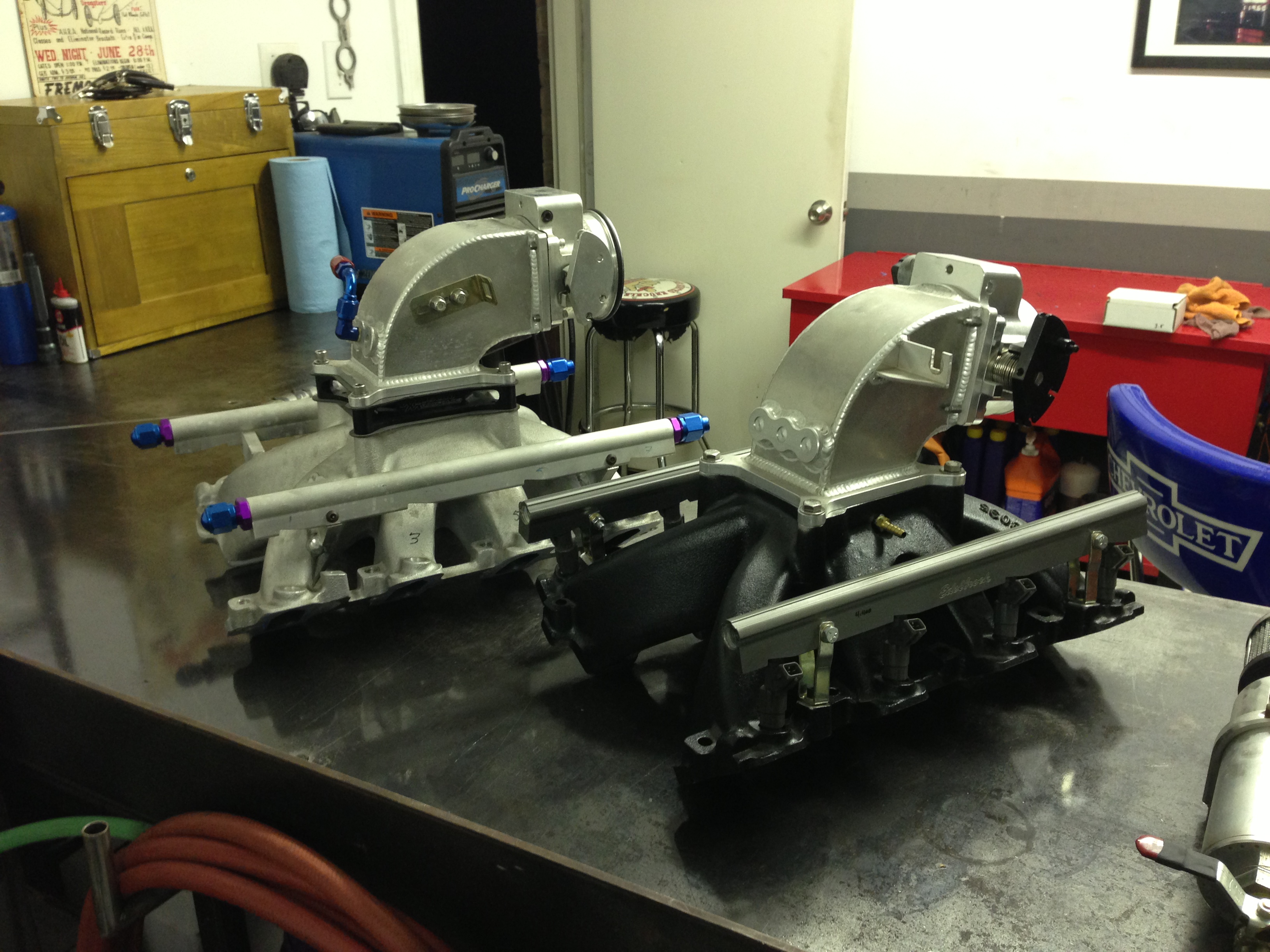

Here is a shot........just a typical day in my garage....couple of super vic's

If you study the pics, you'll notice cylinder 7 and 8 are the only ones not really hurt. Weird as those are typically the worst. The worst where 3 and 4.

I thought that was pretty typical of the vic jr style intakes?

Was the Block ever decked?
Yes
