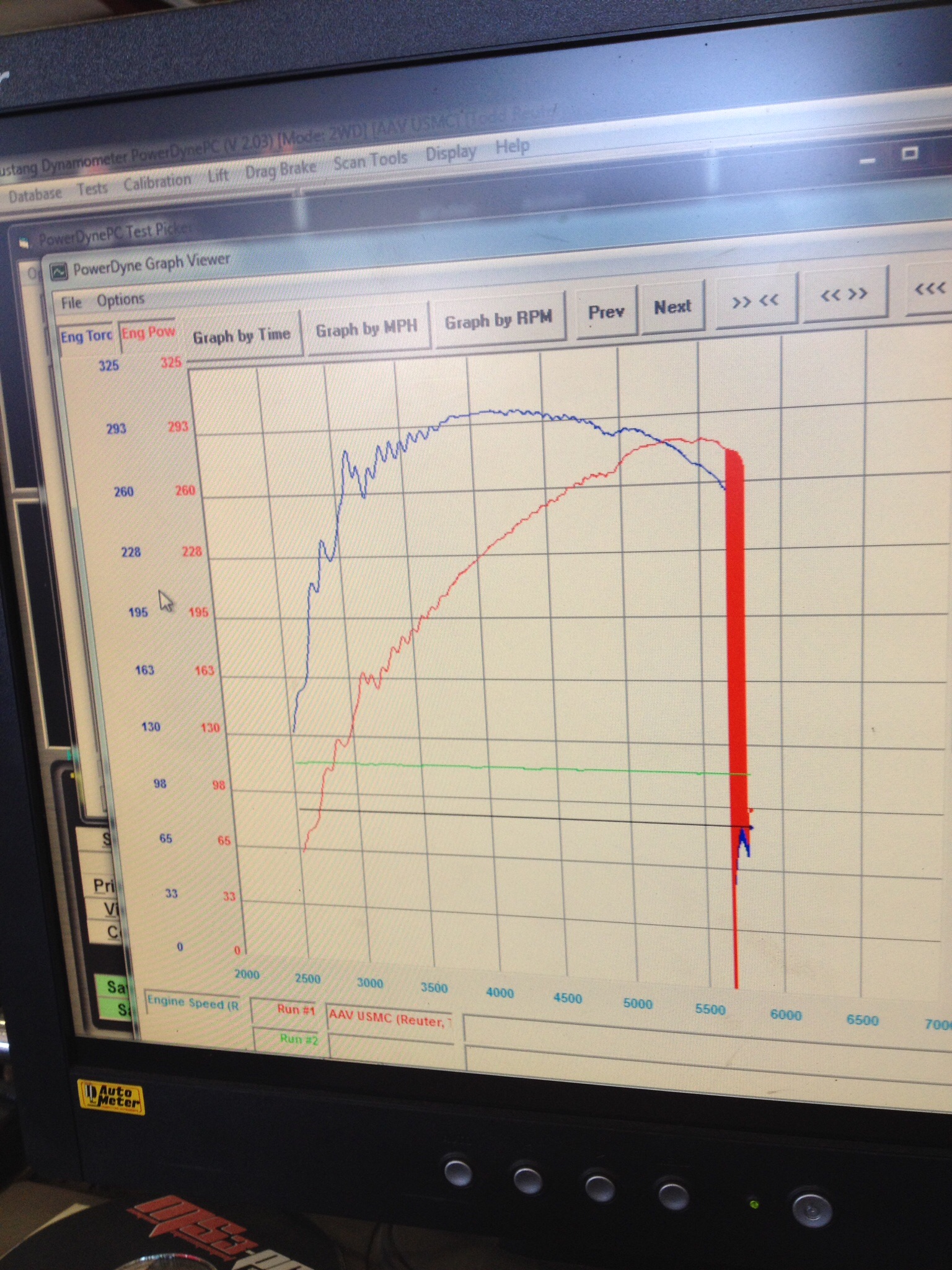

Before: stock idle clip..
And the before Dyno, had a muffler welded into factory exhaust and an kn fipk cold air intake..

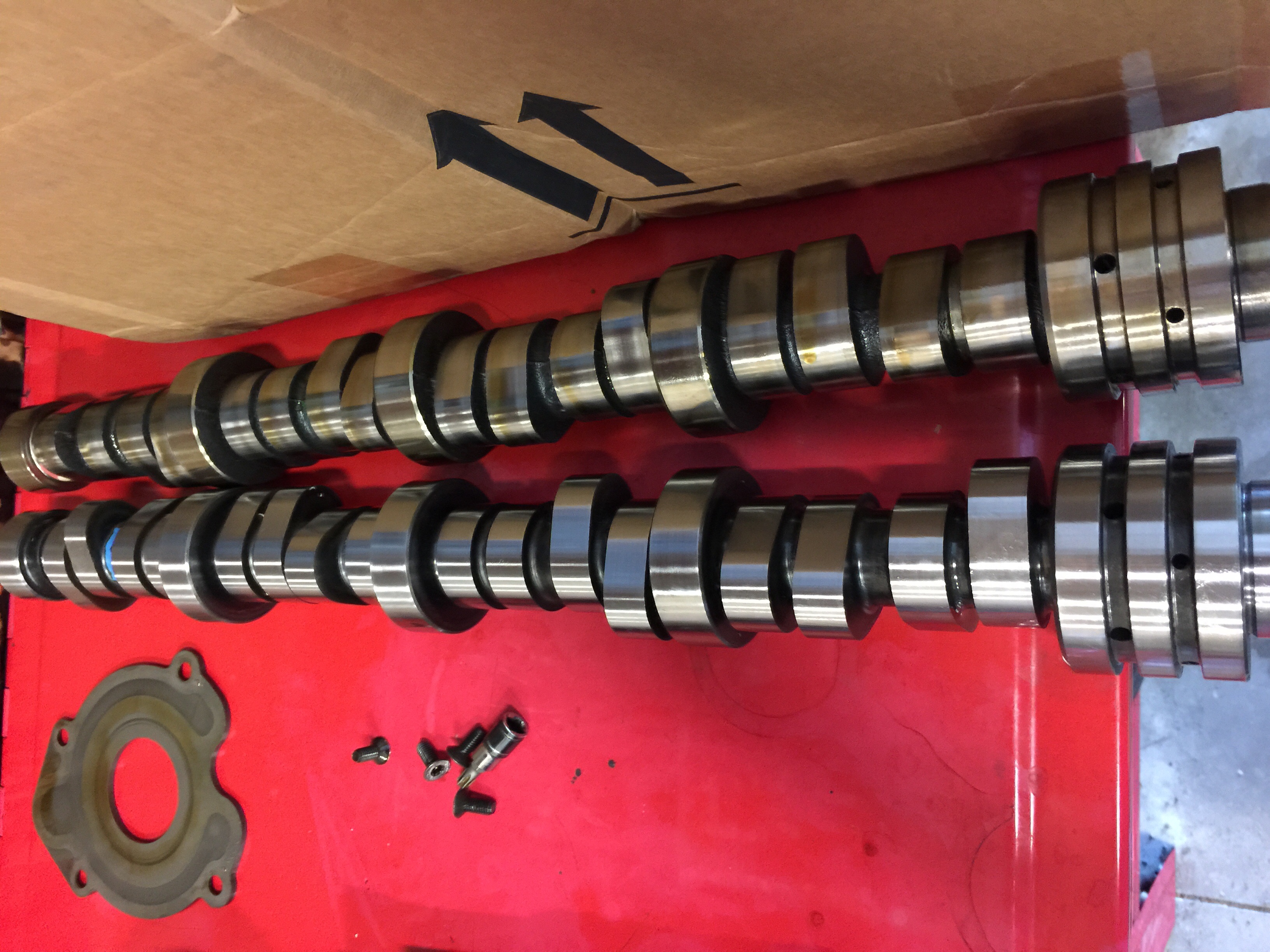

Here is the custom cam (left) it's a high dollar piece, comp makes these on a Cnc machine instead of the normal cam machines. Note the large front journal with all the oil holes for the cam phaser.. We are still going to retain the phaser but will be limiting its travel to 14* movement for more piston to valve clearance.
