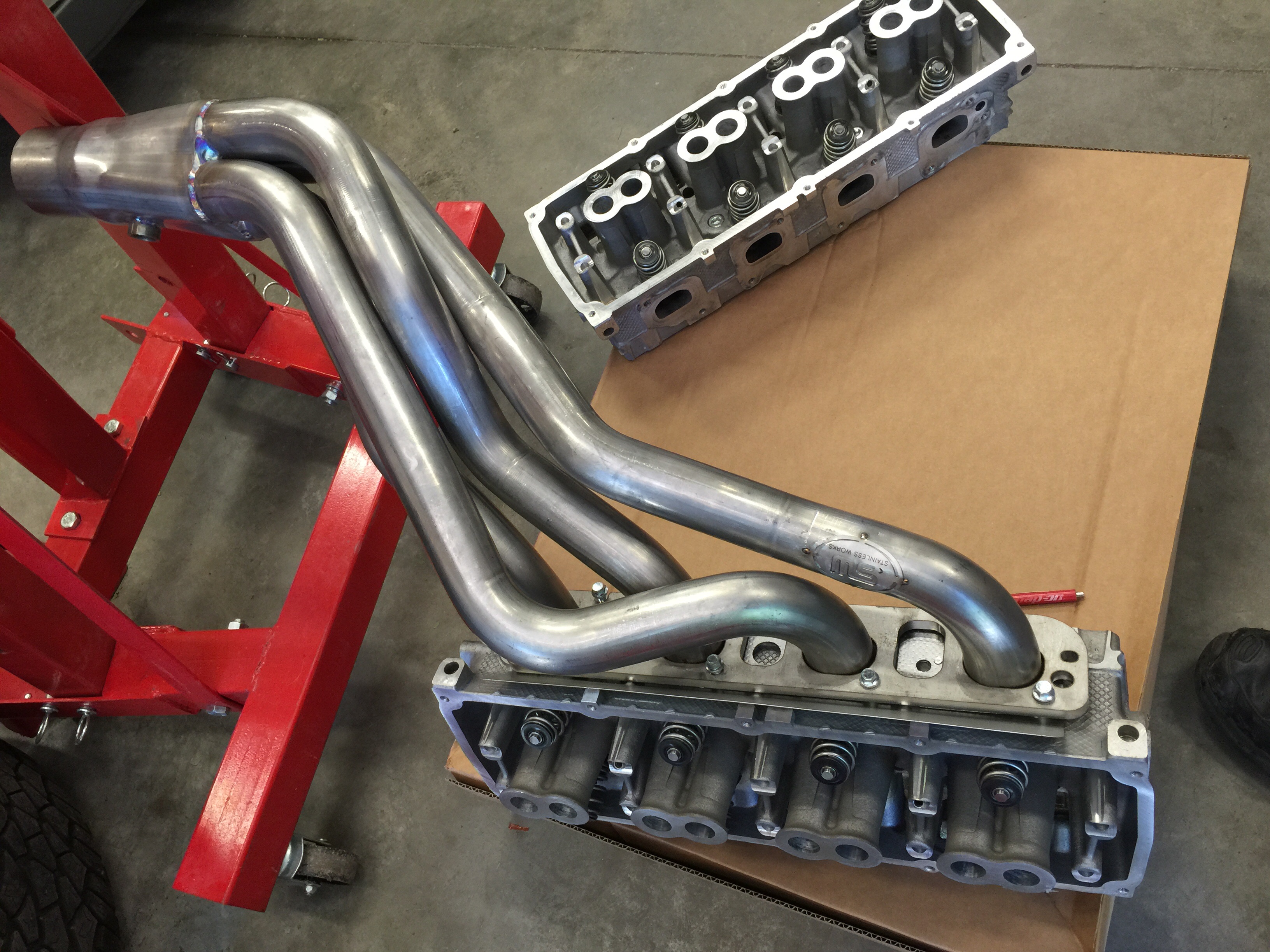

So I have been slacking on progress here.. Here is a pic of headers these were a real pain to install passenger side wasn't bad driver side took me the better part of a day.

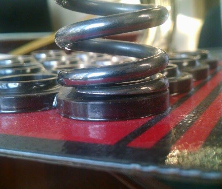

Come to find out the spring kit I had purchased from comp needed more parts to get the correct install height. About .200

Another pic of headers. It's a shame to cover this stuff up.. You can't even see them when installed

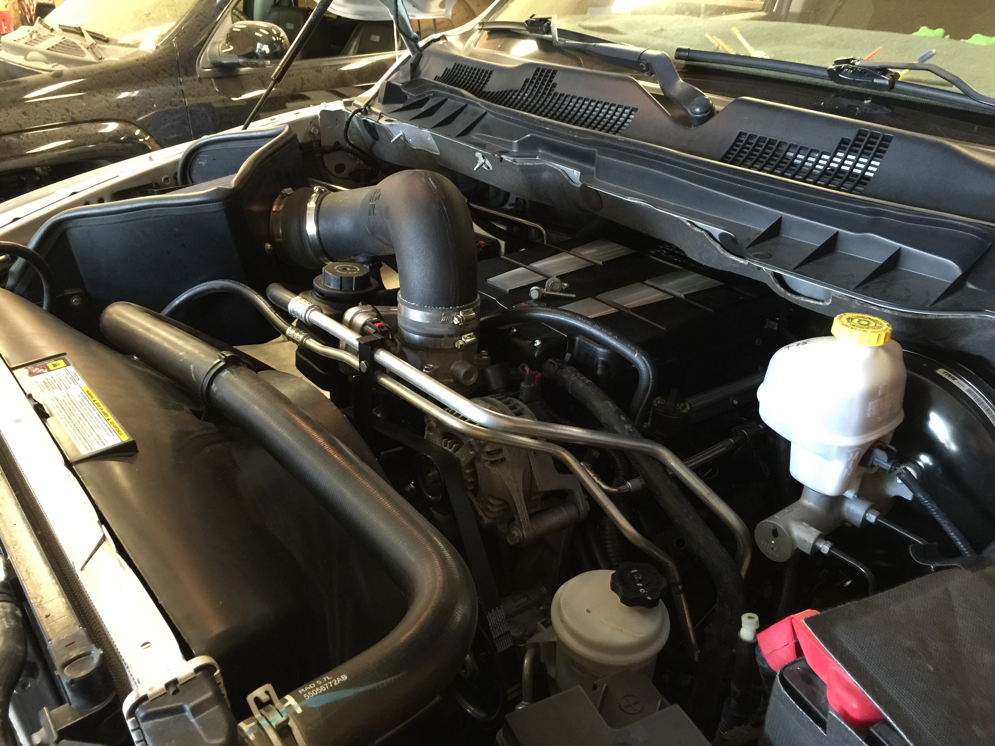

Deleted MDS, installed our custom grind cam, Milled the heads did a valve job and replaced a couple valves there was some pitting on the stems and had worn thru the hardening. Not sure why the truck is only about 30k miles. Reinstalled the heads using stock Mls head gaskets, and lifters from the earlier 6.1L and bolted the heads down with arp head bolts. Then bolted the blower on.

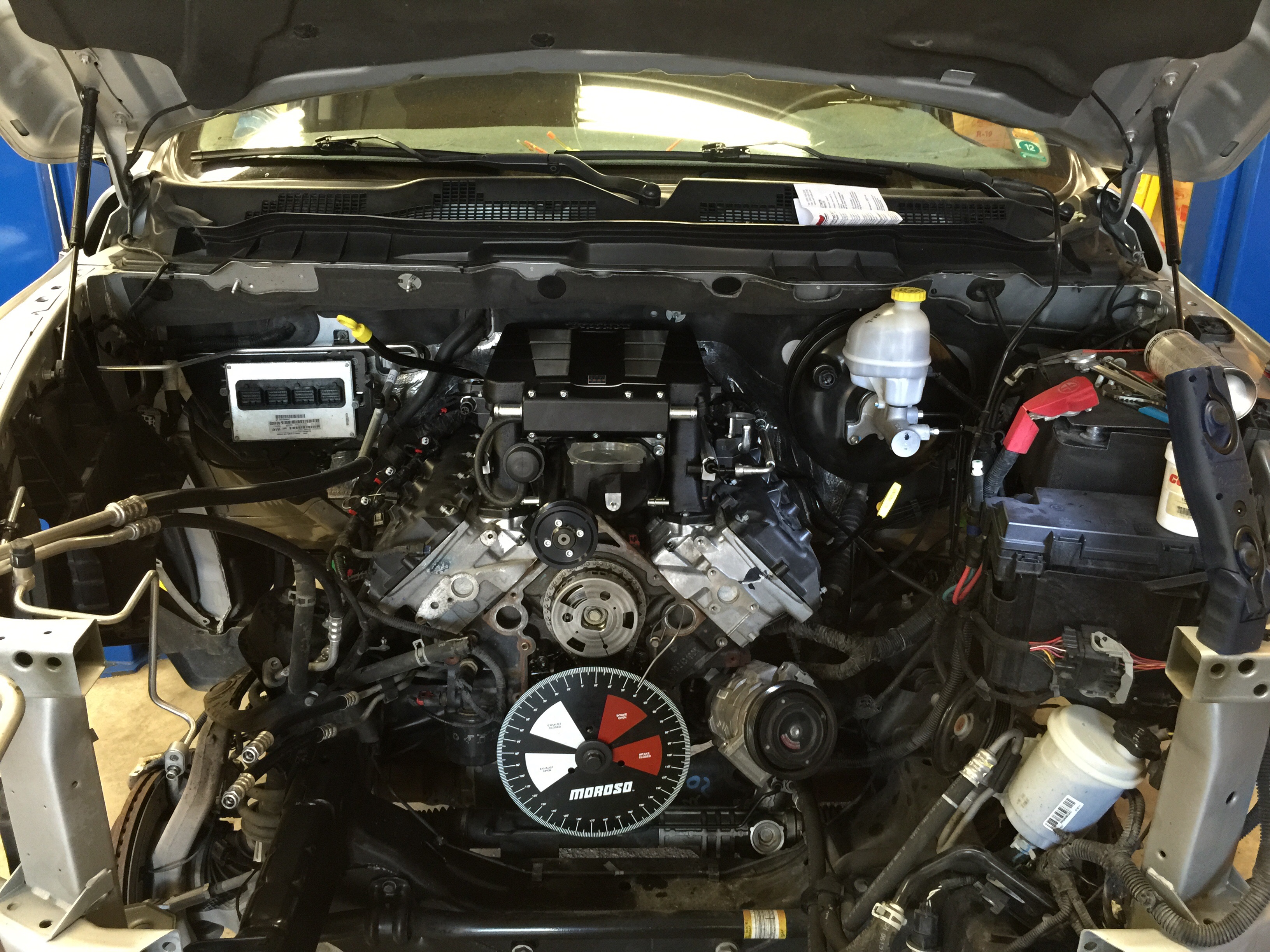

Then started reassembling the the front end and putting things on the front.

Another pic from the front. Looks stock you would never know. Another guy on here will be handling the tuning. I don't remember his user name but his last name is Greene.
