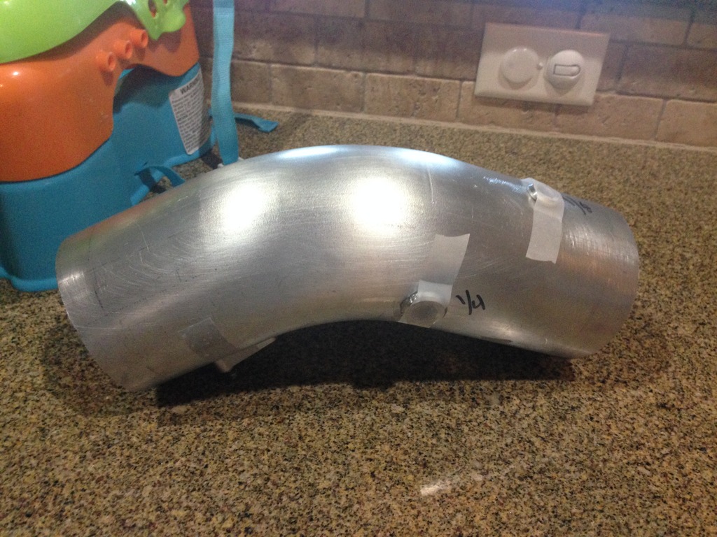

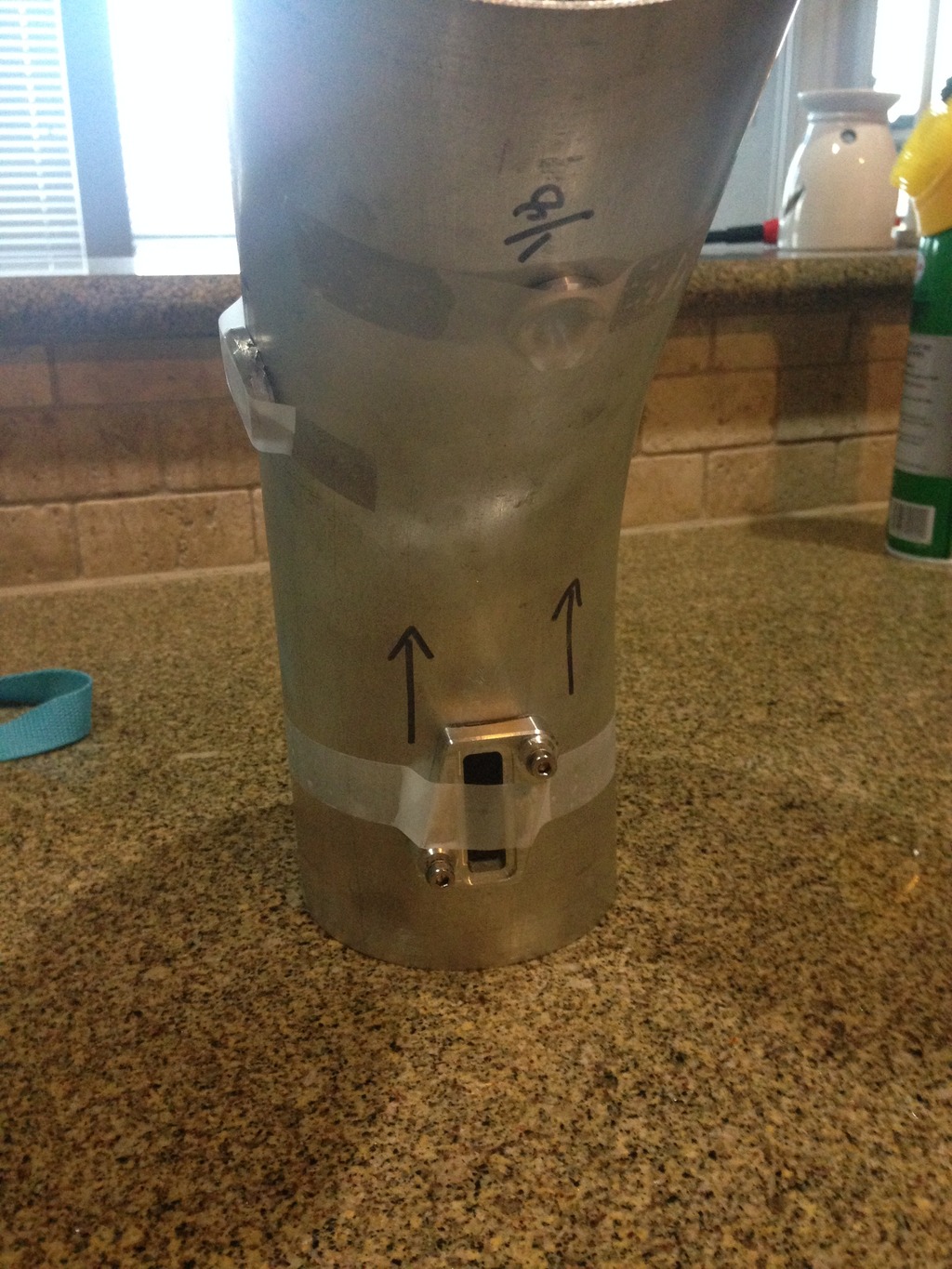

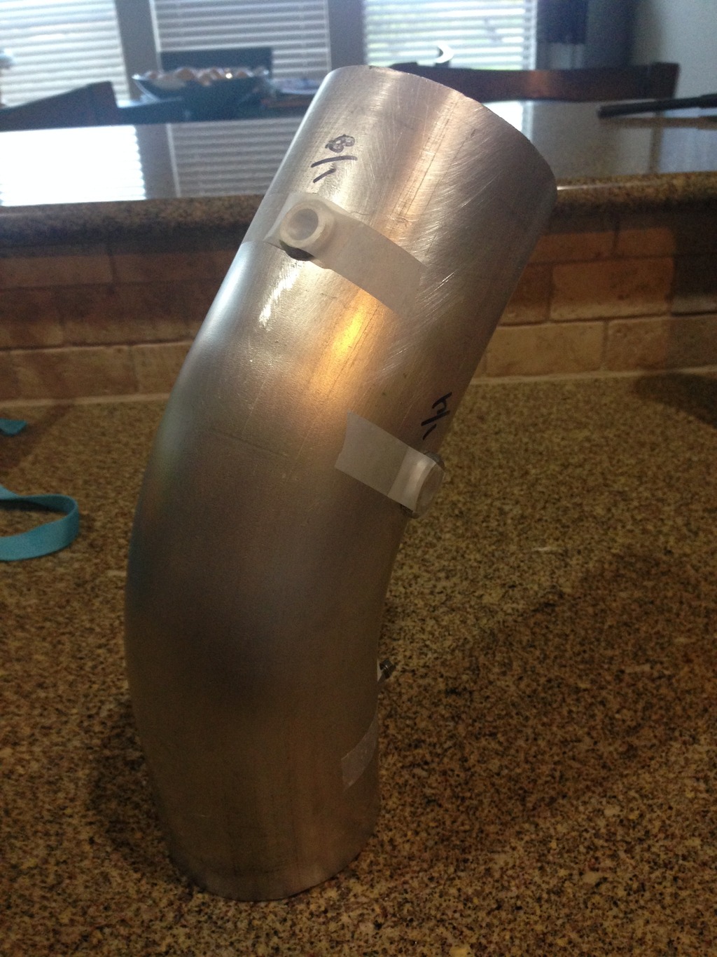

Well i am back from vacation. I was able to get a little done today. I got the intake tube all prepped for welding. I have 2 x 1/8 bungs for meth nozzles. 1 x 1/4 bung for the passenger side valve cover. Then i decided to add a card style MAF flange. I know i should do away with the MAF but i wanna try it for myself to see what it does. Anyways hopefully the shop will have it done in a day or so.

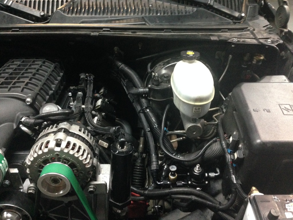

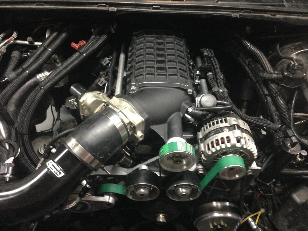

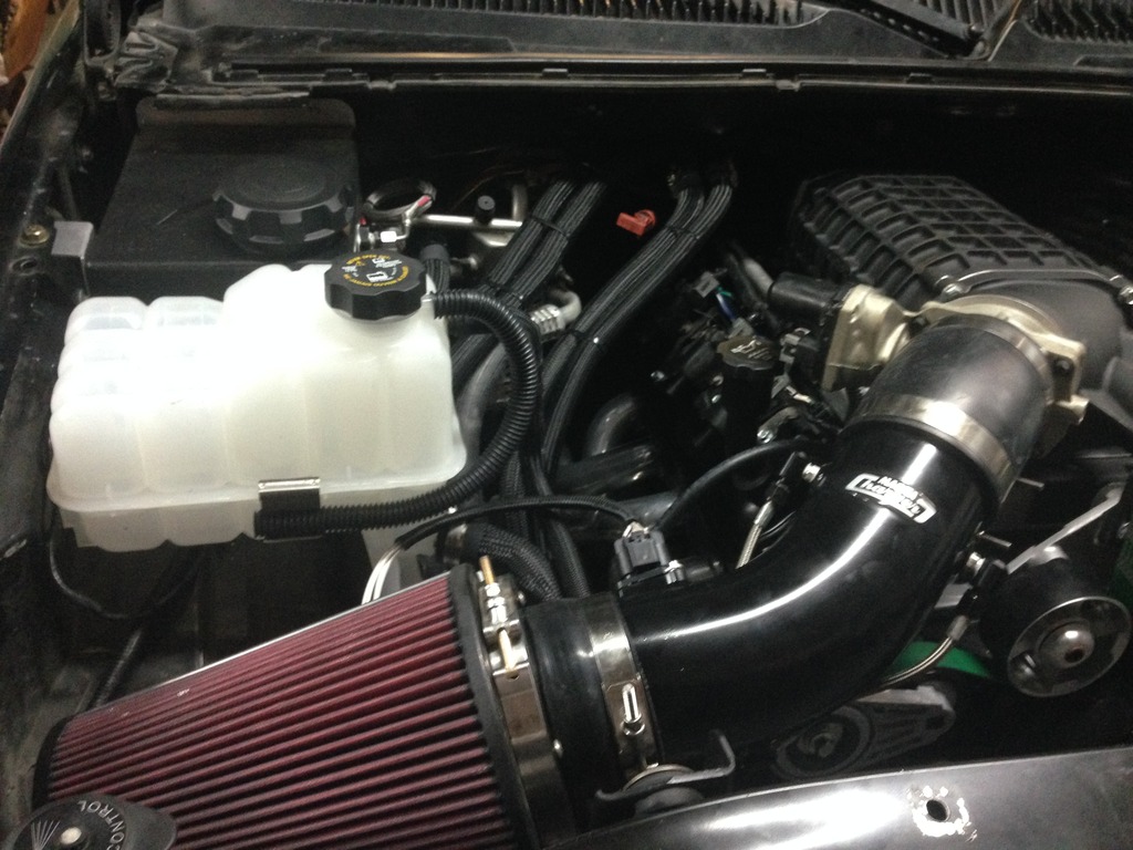

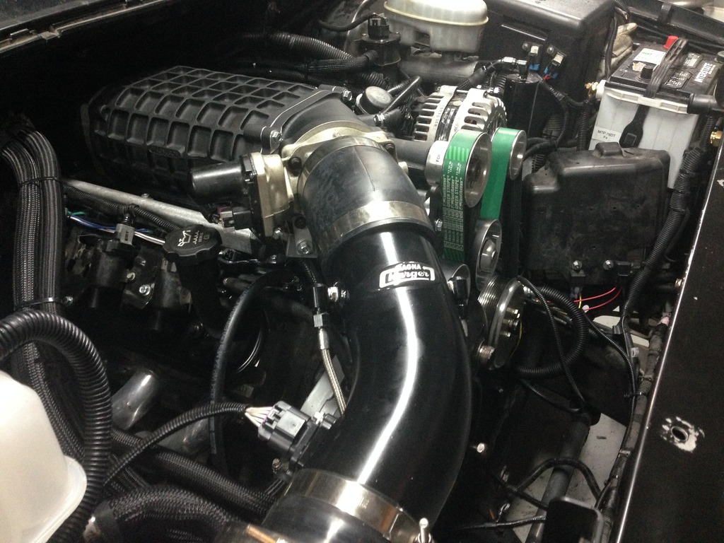

I got almost all the underhod stuff done. Tomorow i get to start exhaust. I might even get to start the damn thing tomorrow!

Extremely clean install. Can't wait to hear your driving impressions versus the turbo setup.

That looks damn good! Very clean! I'm going to have to borrow your idea of covering the hoses with the braided nylon!

Build yourself a heat shield for that filter.

I wonder if the pulley bracket is the same one whipple uses...sure does look like it.
i have one, it is just going to take some tweaking to get it to fit.
what is wrong with the whipple one?
