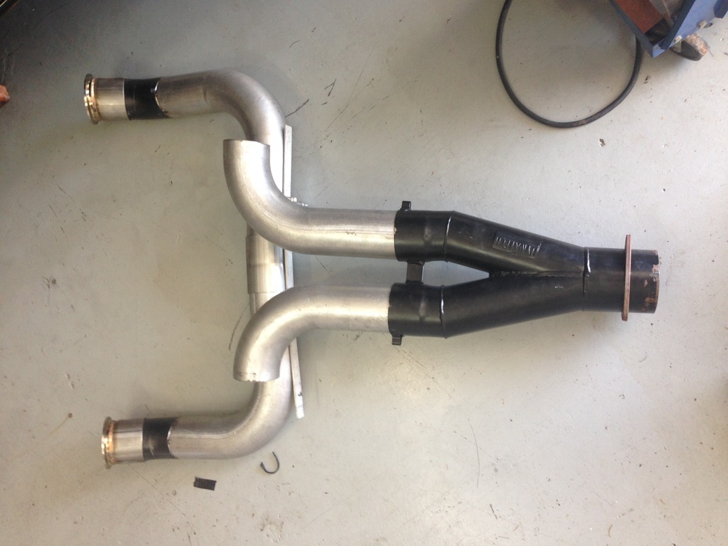

The ypipe is built, i just got to finish burning it together... What a PIA... I am not the best welder or pipe fitter but i think i did ok...
I cutoff the ball socket flanges and welded on some Vbands
the basic idea i am going with

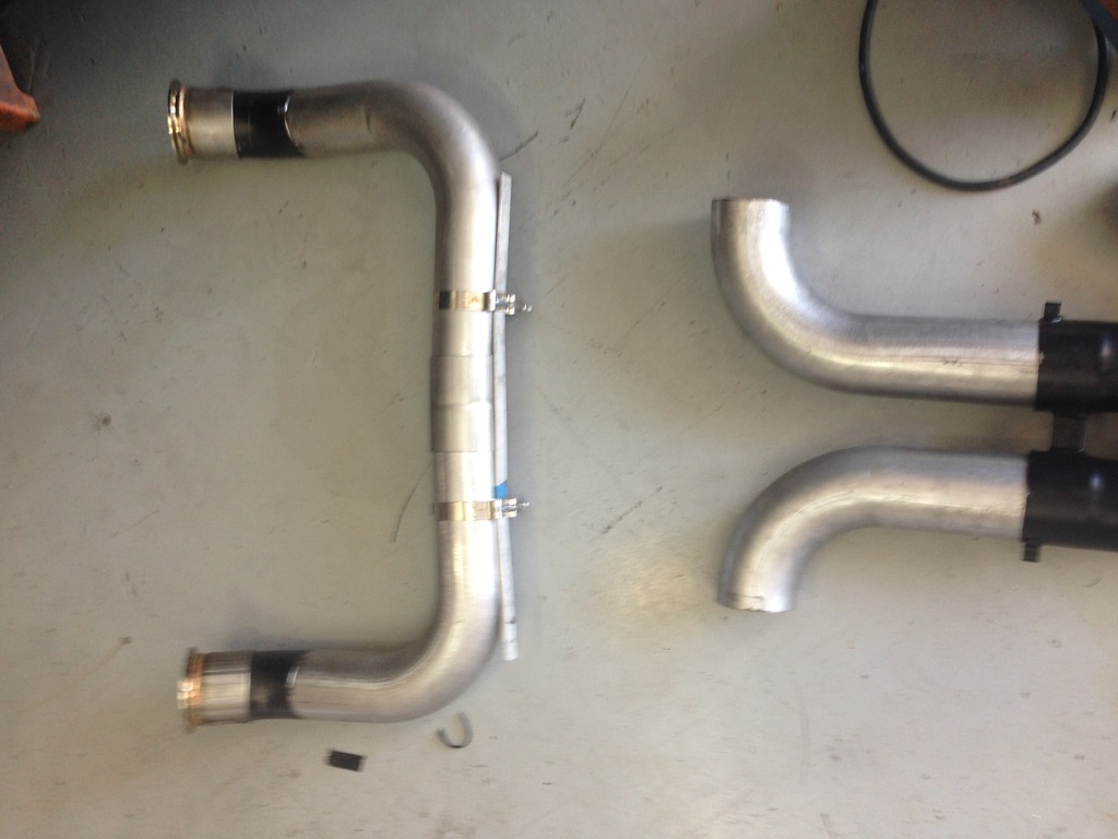

more progress, i used a piece of flat bar to keep the pipes even

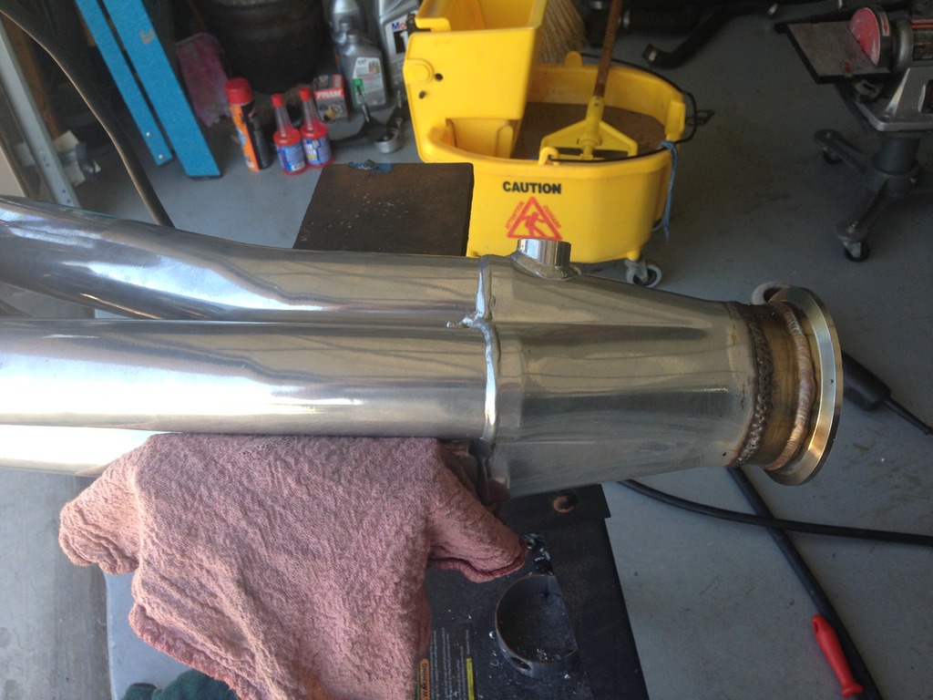

turned out decent

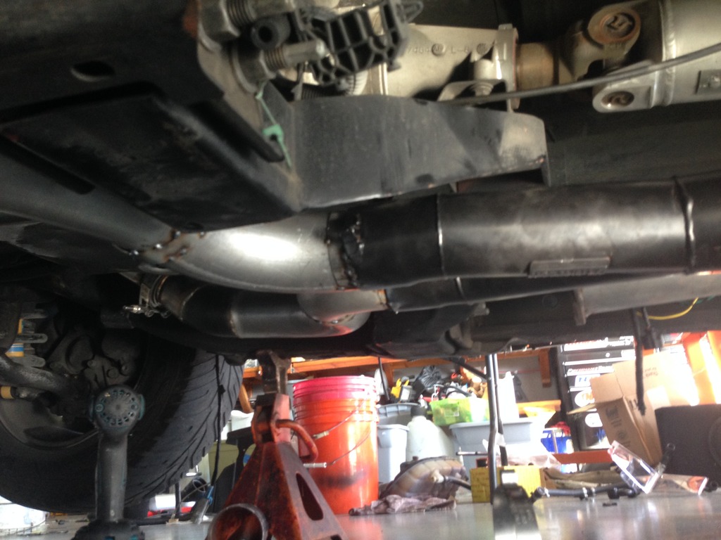

what it looks like all mounted up

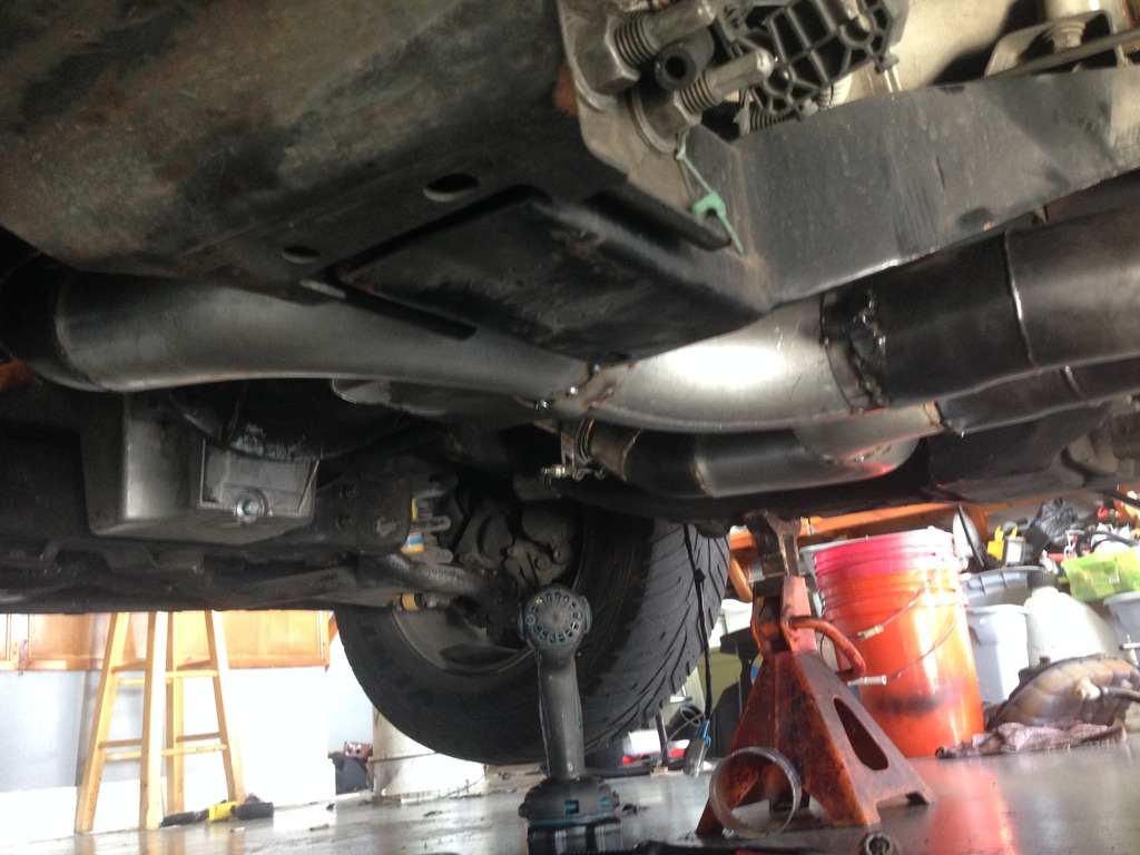

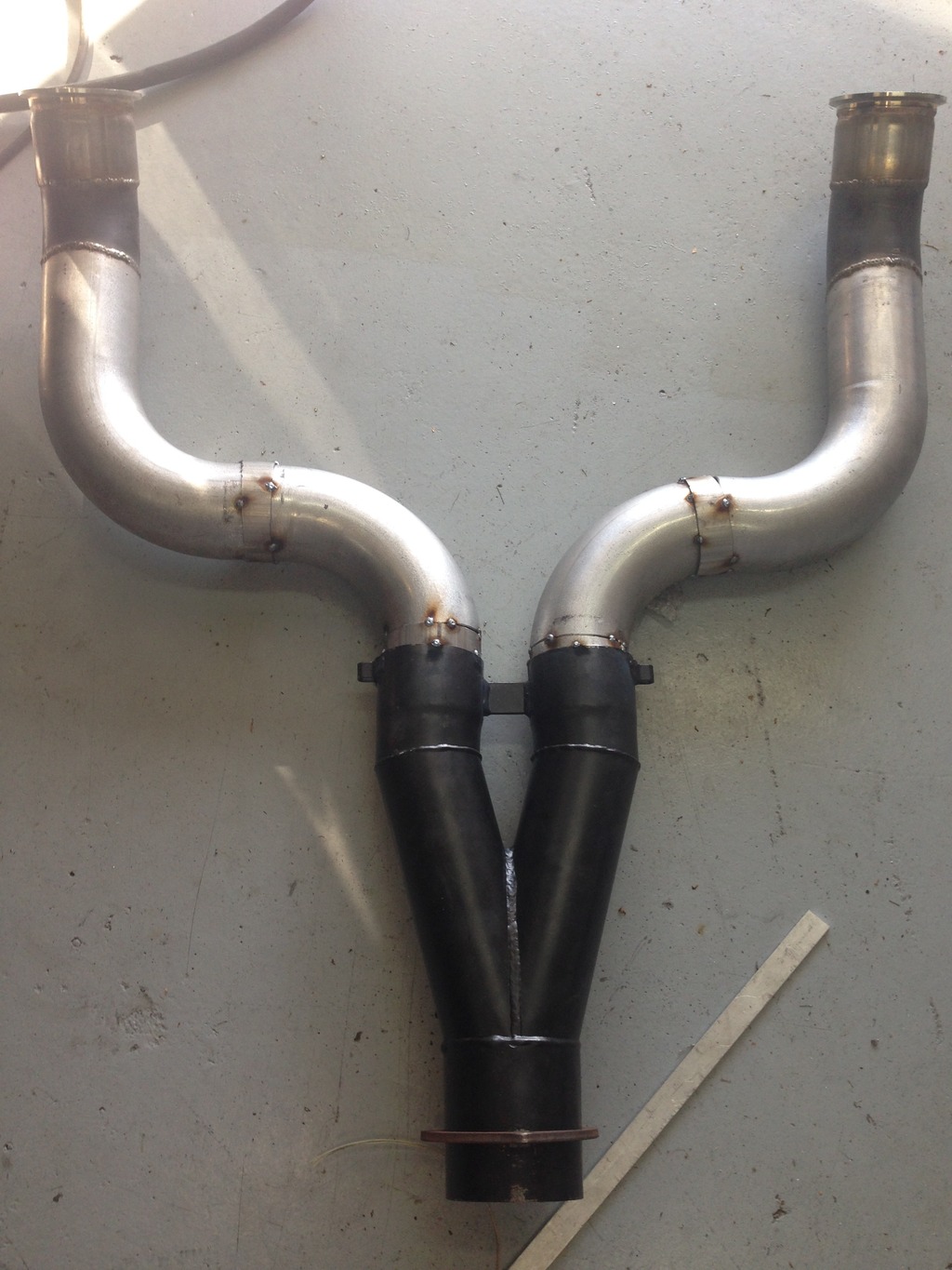

Looks kinda funny. for some reason it makes me think of butt-cheeks...

are you just stacking tacks for the weld?
For the most part yes. Like i mentioned i am not the best welder but i get by. it makes it easier for me to do butt welds...

nothing wrong with welding it in a series of tacks. its hard to tell from the pics, but it looks built up. maybe try a little more heat for the rest of the exhaust.
