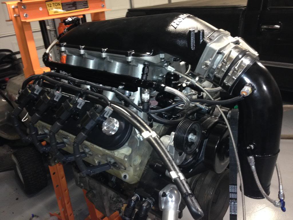

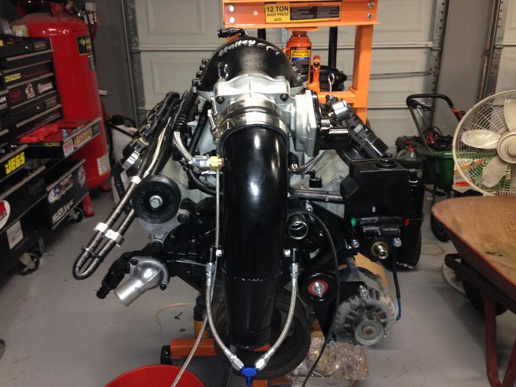

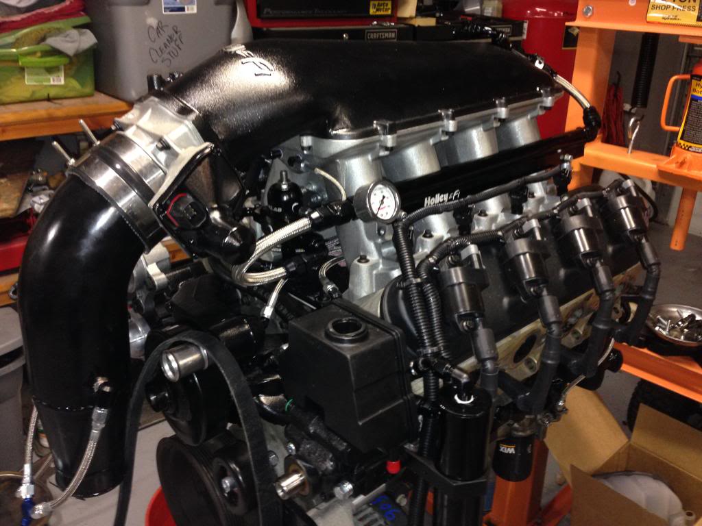

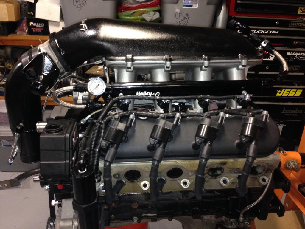

Picture ***** time. The light at the end of the tunnel is approaching. I still gotta figure out the turbo oil feed line routing and run the FPR return line.
Then i need to reinstall the power steering pulley and figure out the belt length. Then i think the top of the motor will be done

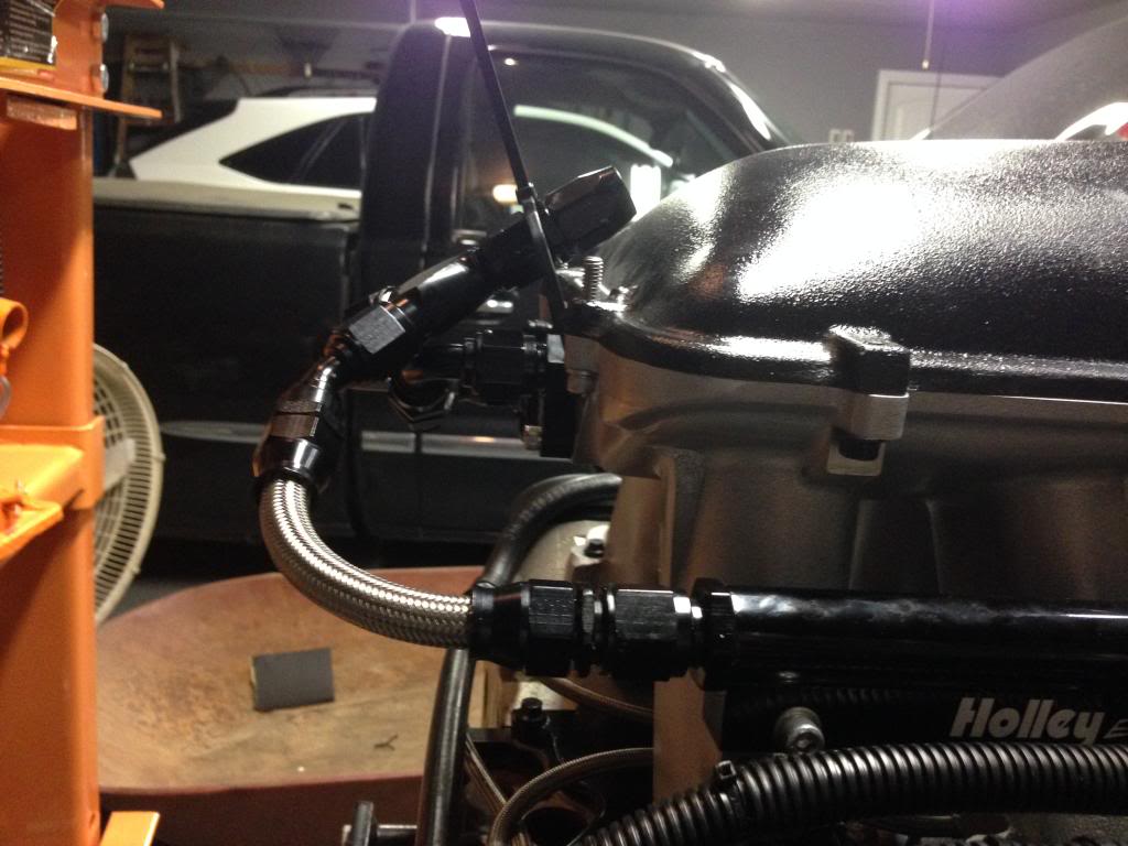

I dont think that rear fitting on top will clear the cowl.

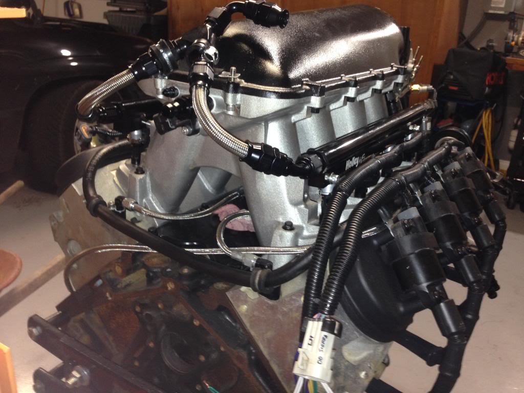

I have had that same fear. Luckily if i swap the hoses around it gives me more clearance. Hopefully one of the two options will work. If not i will try something else. The big unknown us id the tranny dipstick will hit anything. Time will tell
Hoses flipped

How is the feed being routed? Why would you run the inlet up on top of the manifold like that instead of pointing it down towards the bellhousing?
Because my fuel lines are run down the outside frame rail on the passenger side. They come up under the hood in the back corner in the passenger side.
