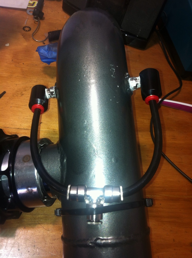

A little progress today. I got a portion of my meth kit installed. I used 3/8 nuts welded them to the charge pipe, then drilled and tapped them for the nozzles. Worked out pretty good.

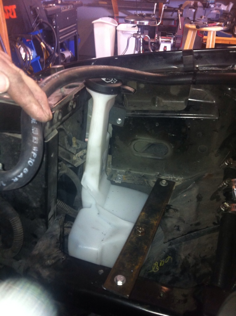

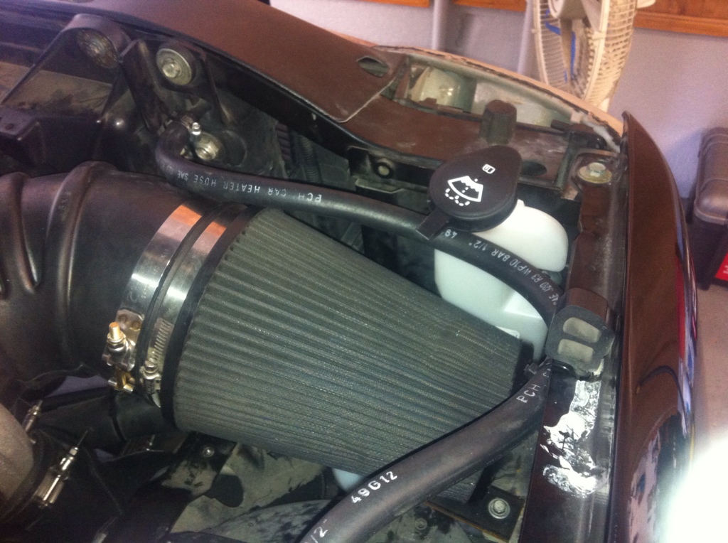

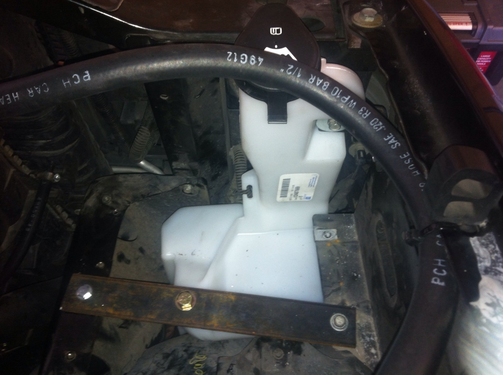

Next i installed my new washer tank for the meth. I had to make 2 brackets but that was pretty straight forward. Fits like a glove.
And yes the hood shuts just fine.

Erm....you put it on the wrong side bro

Kb said to put it after the BOV. Are you talking about the nozzles or the tank?

The tank..
As for the nozzles, I have found putting them a little bit farther away gives it more time to vaporize and do its thing, even if they are before the BOV.
Old Jan 18, 2013 | 04:02 PM
  #76
BlackGMC's Avatar
Resident Retard
iTrader: (31)
Posts: 17,216
Likes: 20
From: Fort Worth - TX
Yeah that was as far away i could get them to fit decently.
