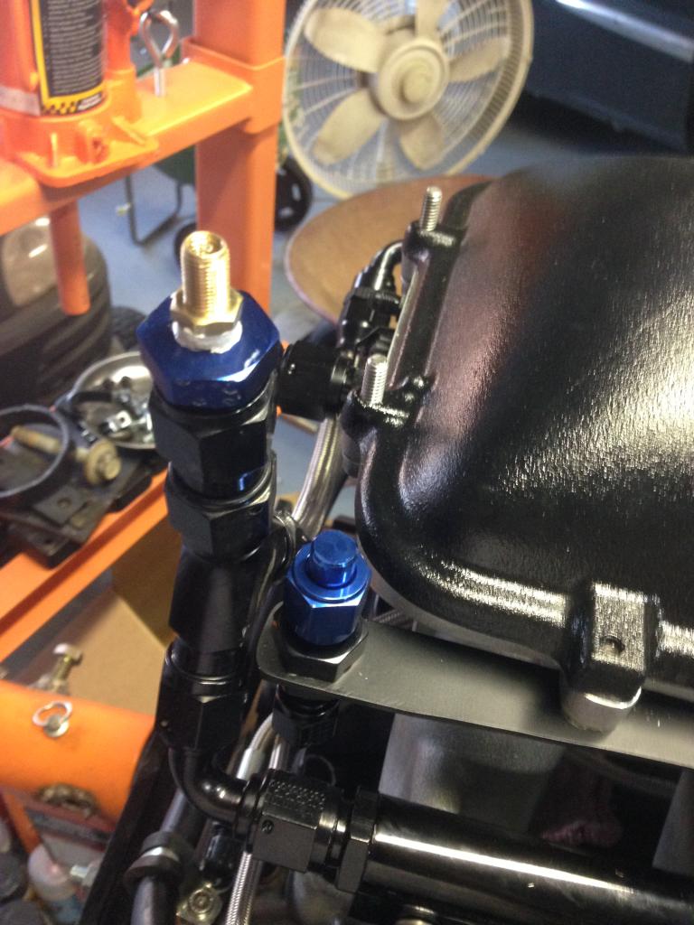

Ghetto pressure tester. 100psi of air made one of the hose ends leak so i gotta replace it. I must have screwed it up during assembly.

I got the hose swapped out. Aired it up to 97psi. It is holding so i am gonna let it sit overnight. BTW spraying soapy water on all the fittings and hose ends determined the leak. Just look for bubbles

Were you using Summit fittings?

Nope these are Fragola PTFE fittings.

More fittings = more places to fail

True but it is still holding the same pressure as a hour ago so i think i am good.
