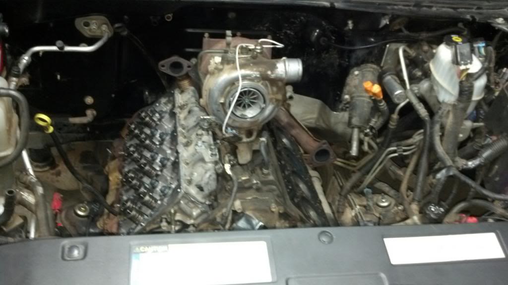

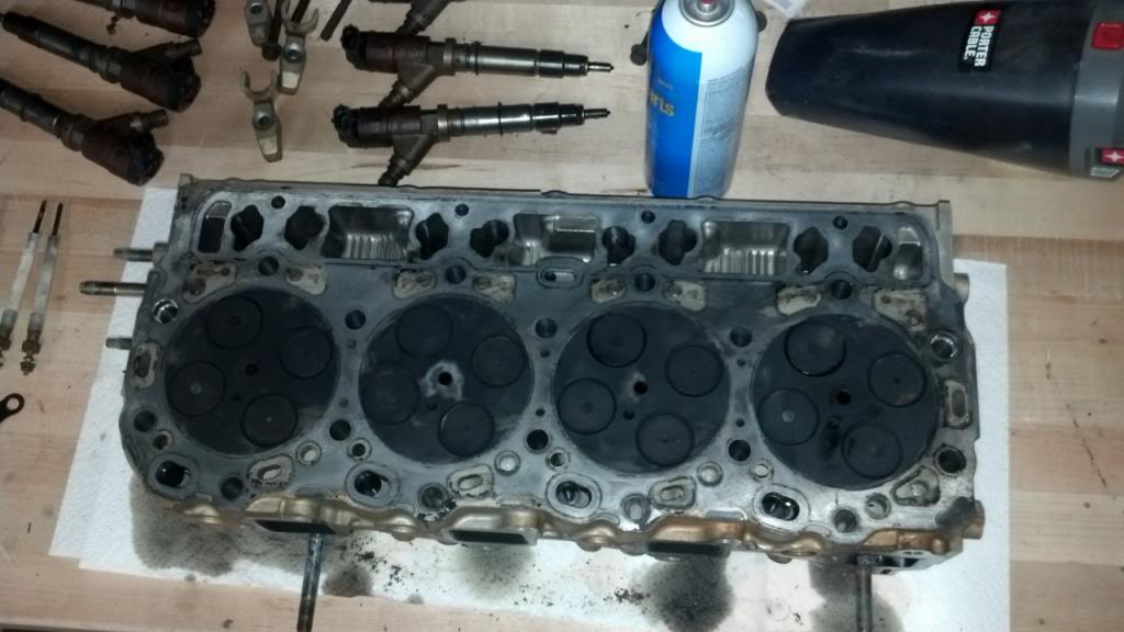

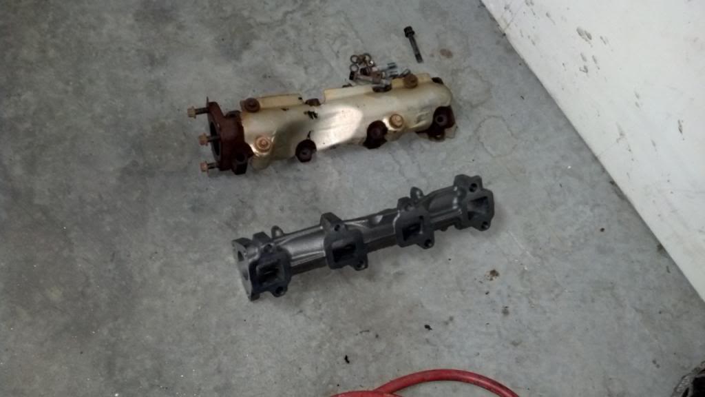

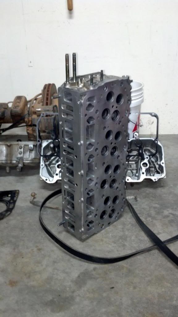

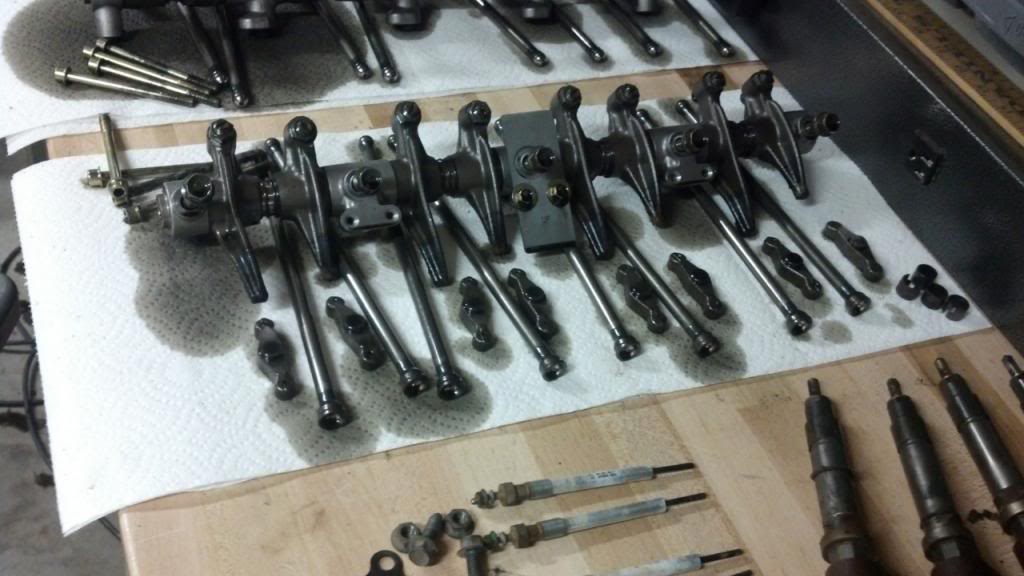

Yep they are push rod engines. The rods are quite a bit longer than the LS motors.
Here's one side with the rockers removed

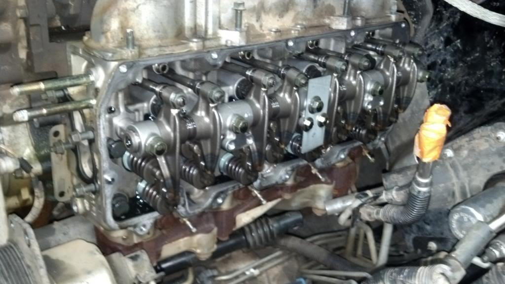

Other side with the rockers still on

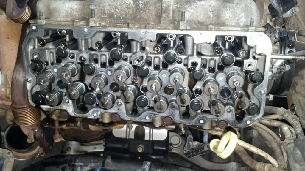

Bottom of heads
Valvetrain

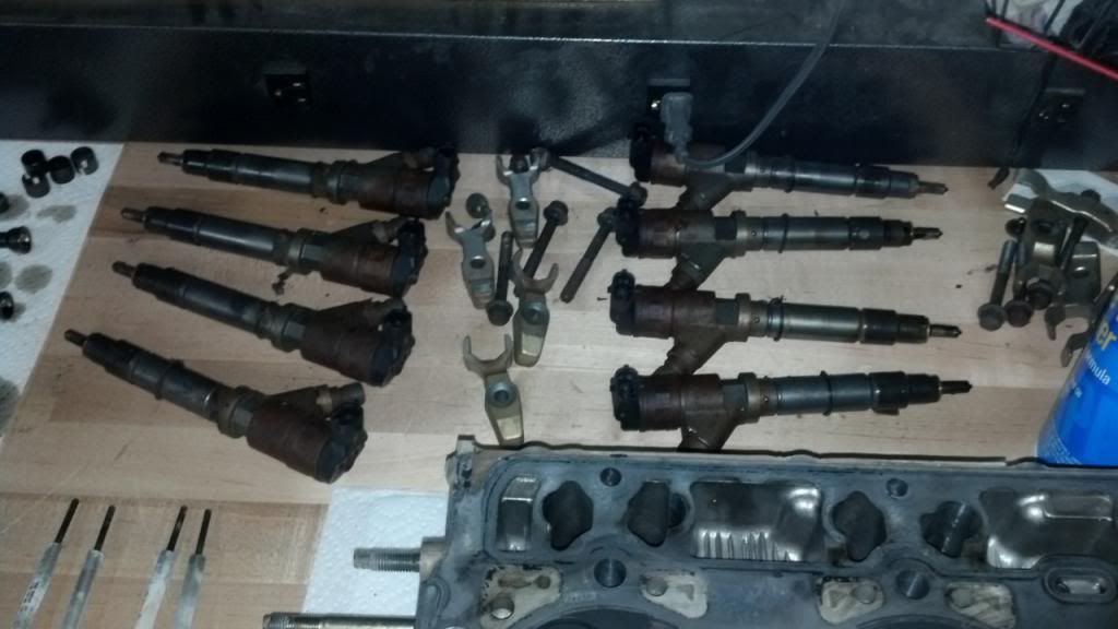

Injectors

Alot of work! Did the injectors on my l 7 and there was a lo to remove to get to them, what your doing is even more! I must have missed the reason your doing this?
Old Aug 2, 2013 | 07:17 PM
  #473
thunder550's Avatar
High on diesel fumes
iTrader: (70)
Joined: Mar 2005
Posts: 12,658
From: Phoenix, AZ
Head gaskets were bad...they were leaking and pressurizing the cooling system. It spit some coolant out the overflow, and when I opened the cap a shitload of it came gushing out. LLYs are notorious for bad head gaskets.

Got one cleaned up! Almost done with the second one too. Downpipe and gauges will be here tomorrow. Gauge pod, new gaskets, LML exhaust manifold, and LBZ mouthpiece will be here Thurs. Going to take the passenger side up pipe and one of the intake pieces in to have bungs welded on them for EGT and boost gauges as soon as I get the gauges in.

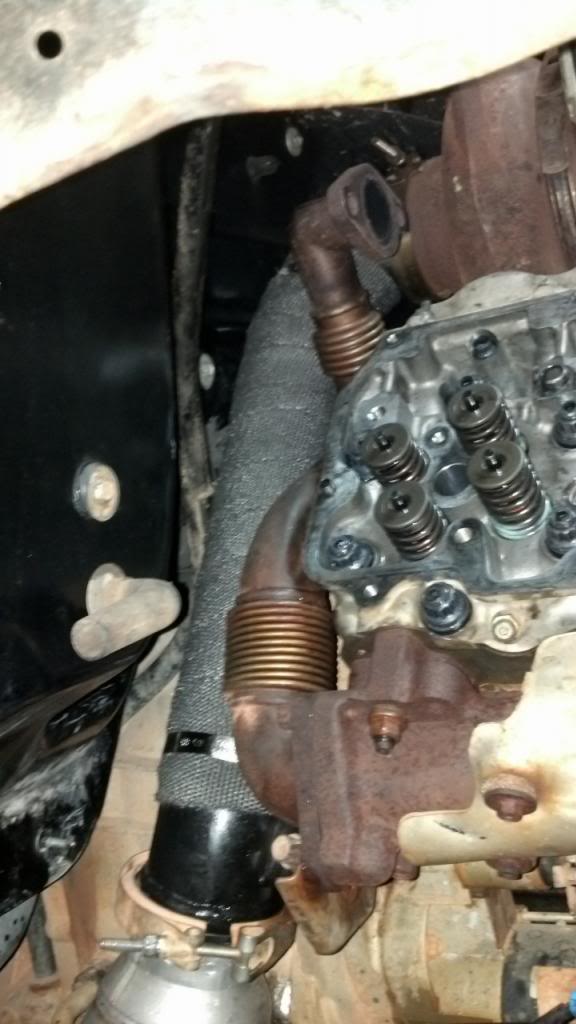

Today was parts day! Got visits from the brown truck and the green/purple truck....my favorite kind of day
I got one head reassembled and bolted back down, downpipe installed, and passenger exhaust parts all buttoned up.

SDP downpipe

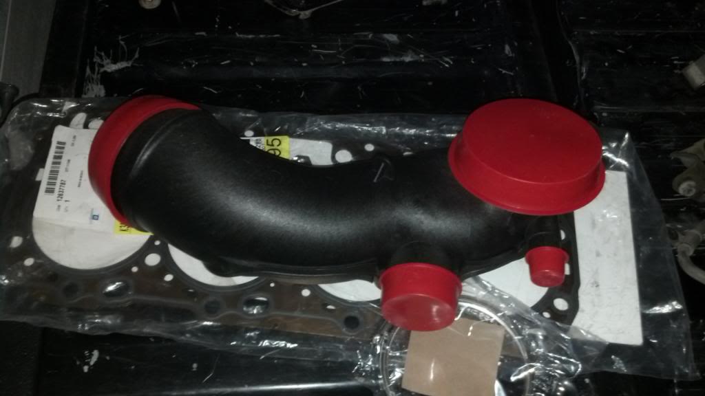

LBZ mouthpiece

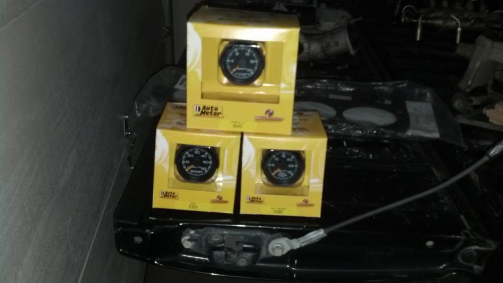

Autometer GM factory match fuel pressure, boost, and EGT gauges

Better pictures of the gauges please. Also a link to where you got them.
Also shouldnt you put the egt probe in the downpipe?
