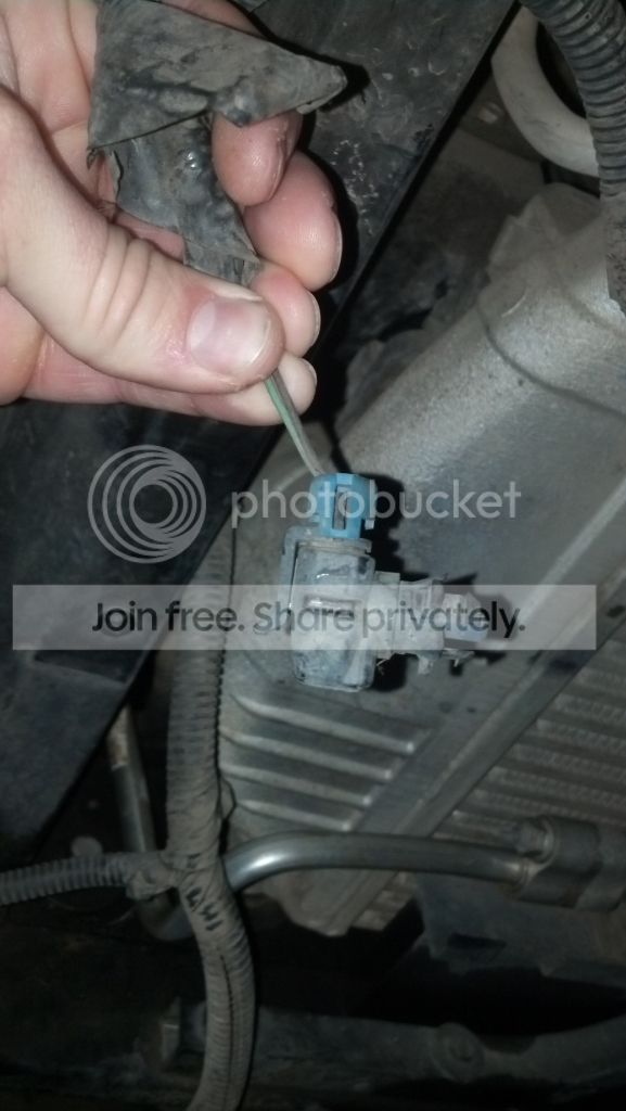

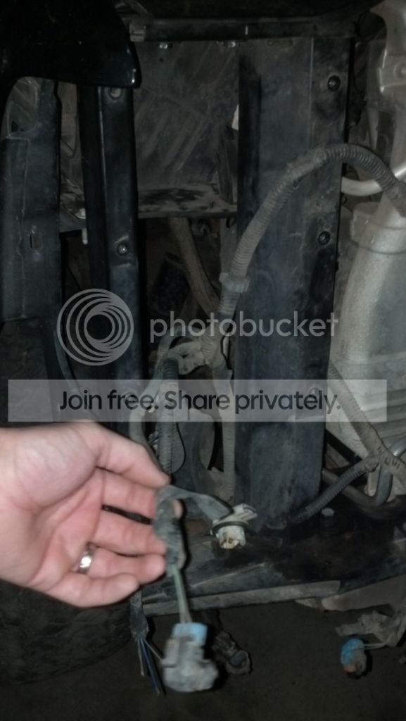

Originally Posted by thunder550
Here's the response I got over on dieselplace
I'm curious what these sensors do now...it's not the compass temp sensor, what else would it be?
Here's a couple better pics:
Here's the passenger side headlight/parking light harness that it comes out of
Most of the trucks have to outside temp sensors on for the ac system and on for the rear view mirror temp.

Ah gotcha, that makes sense. I guess I just assumed the A/C and temp display both ran off the same sensor.

Thanks! Someone else on another forum said he thought the missing connector was for trucks with an aux fuel tank, so it sounds like that one can stay disconnected. I drilled a hole in the passenger side gap guard thingy below the running light and mounted the other sensor there.

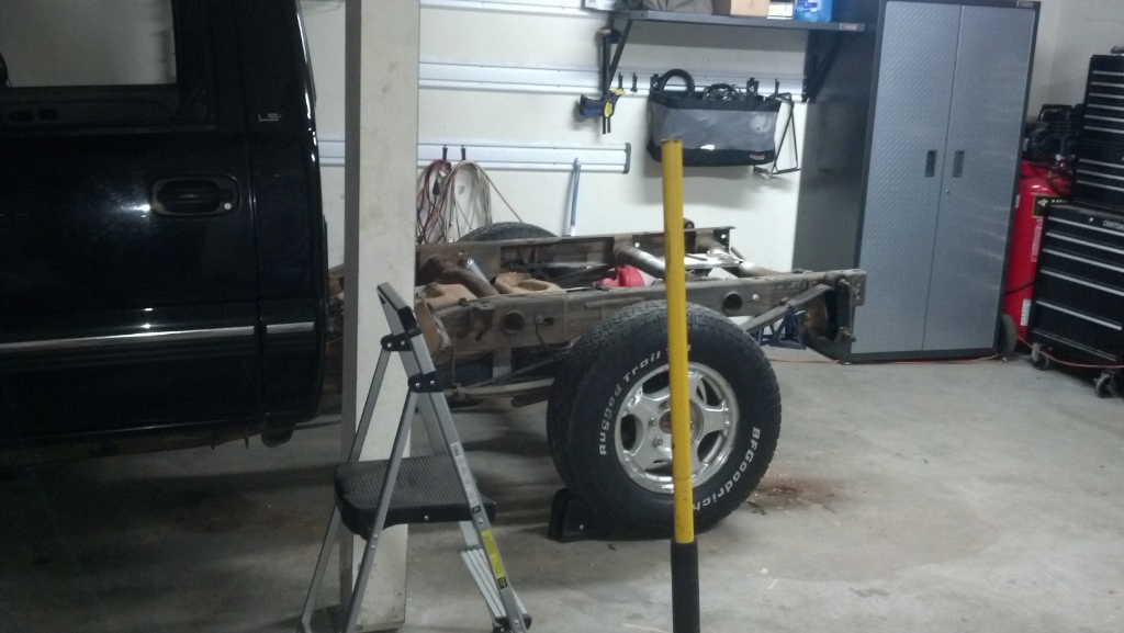

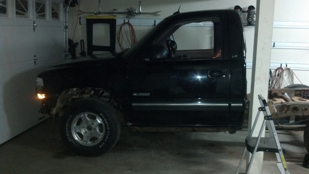

Well I ended up having to do a 3" body lift to get the fender/door gap to look right. The spacers actually measure 2-7/8". I had measured the LLY radiator support at 2-3/4" taller than the gasser, so I guess that's about right. I was hoping not to have to go that tall but it is what it is. Hopefully the suspension drop will compensate for quite a bit of that.

Too dark to see the body panel gaps, but this is how it's sitting now.
Lowering shocks, bumpstops, and drop shackles are in. I haven't pulled the lift blocks from the rear axle yet, will do that when I put my yet-to-be-procured 9.5 rear end in. I took 18 turns out of the torsion bars, the previous owner had them cranked as high as they would go. There's still a couple turns left that I can take out, but I want to wait until I have the rest of the truck together before I set the final ride height.
