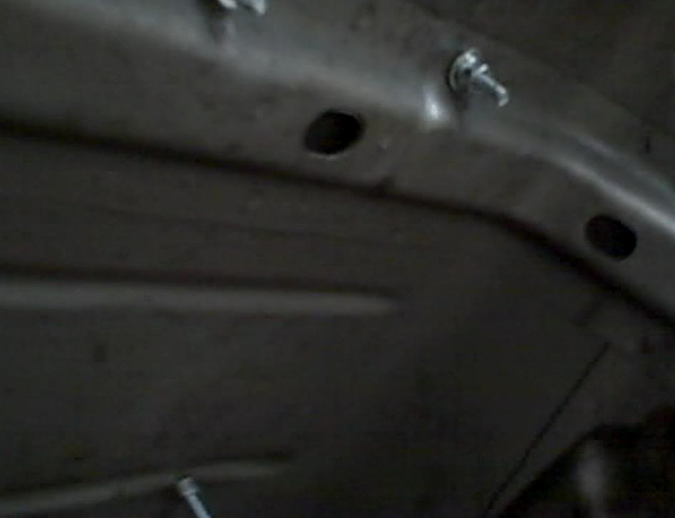

I managed to get two of the shifter mounting bolts to go through the cab support, and it's very sturdy. I was a little concerned the thin sheet metal of the floor wouldn't make for sturdy mounting. But I'm happy to say there is no shake or loosness at all.

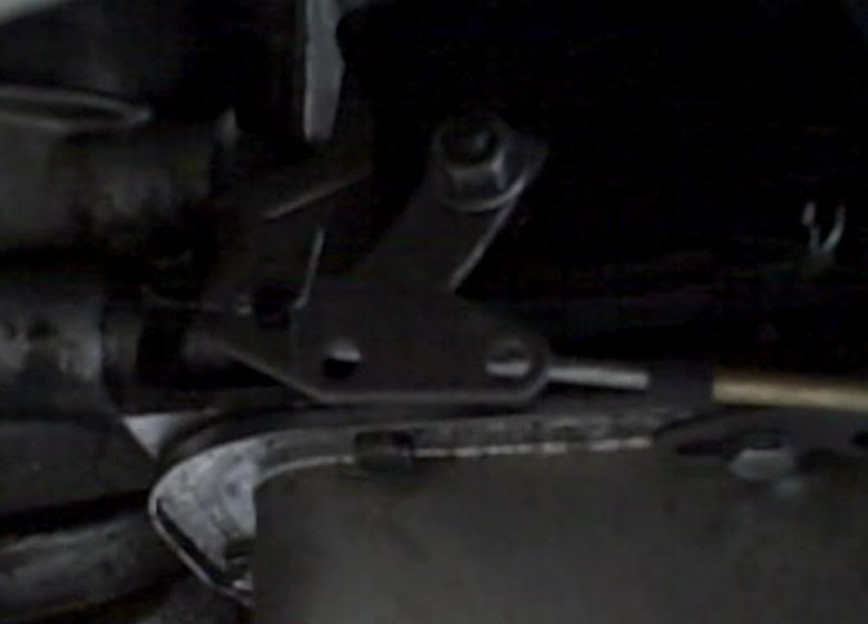

The bracket used for the 700r4 works the same on the 60E

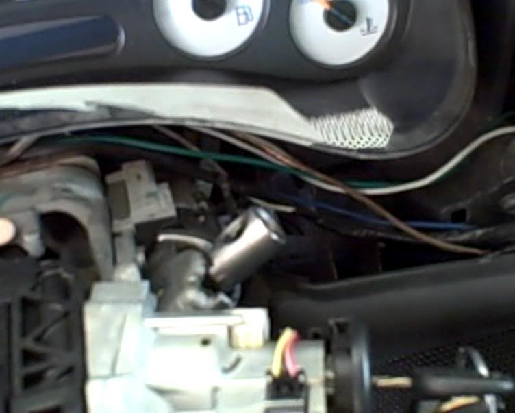

I just simply pulled the column shift arm out, and left the assembly in place making sure it was in the park poisiton.
