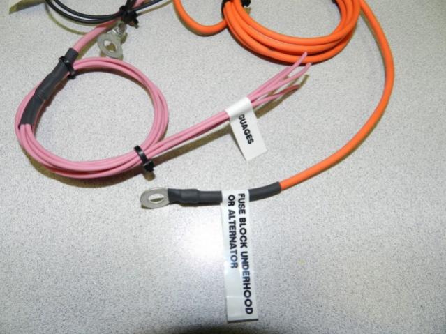

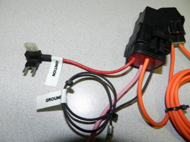

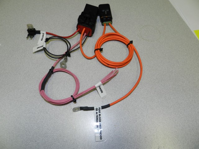

Sweet that helps a lot. I think I may go this route for the wiring if I can get a reply from Nelson soon.
I'm trying to do everything perfect this time around so I don't have to redo anything as the wife would kill me if I bought a new truck any time soon

Your pics didn't show up. Do I have to be a member on LS1truck to see them??

Probably, they were an attachment to a post Nelson made in the veterans section on his site. I'm uploading them to Photobucket now and will edit the post.

Can you see them now?

Yup. That one going to ignition looks identical to what I did. Good luck, let me know how it turns out.
