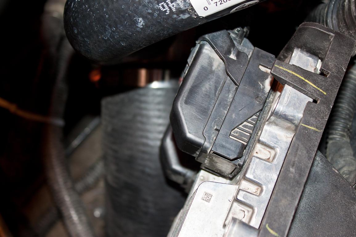

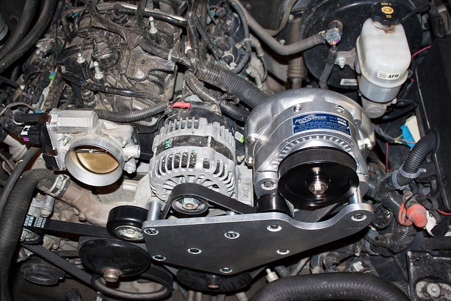

Got the PC installed, intercooler installed and all the pipes ran. Ran into some snags mounting the PC that required grinding down some of the aluminum behind the alternator so everything woulld fit nicely. Also had to modify the bracket for the ECU so the pipe leaving the PC would route the way it suppose to to the intercooler. Still not sure if I like how I have the ECU mounted or not, the wiring harness is touching the pipe off the PC. Not sure how warm that pipe will get and if thats a concern or not.

So I finally got everything installed. Still a few little tweaks here and there that I need to do to clean it up but everything is installed and working. I like the look of the wideband in the door pod and the boost and fuel pressure in the pillar mount. I still need to paint the pillar mount but I can do that later.
Roger showed up after work (props to him btw for showing up off the clock and at my place) and got a very basic tune loaded so we could start it up, check for leaks and I can drive it (as long as I stay out of boost) to his shop tomorrow to let him have it for the day.
So as I mentioned about that plug being a PITA. Well apparentlly when I changed my plugs the one on the passanger side closest to the firewall decided to pop off so it was only running on 7... so 2 seconds leaning over the hood, slid the boot over the plug till it snapped into place and we were rocking and rolling.
So I don't want to drive it to much till after Roger get's it all tuned and dialed in but I made a quick trip to the store and back and just the purr of the Procharger under the hood gives me a hard on. The sound is just beautiful. It's 10 degrees outside and I am driving with my window down just to listen to it.
