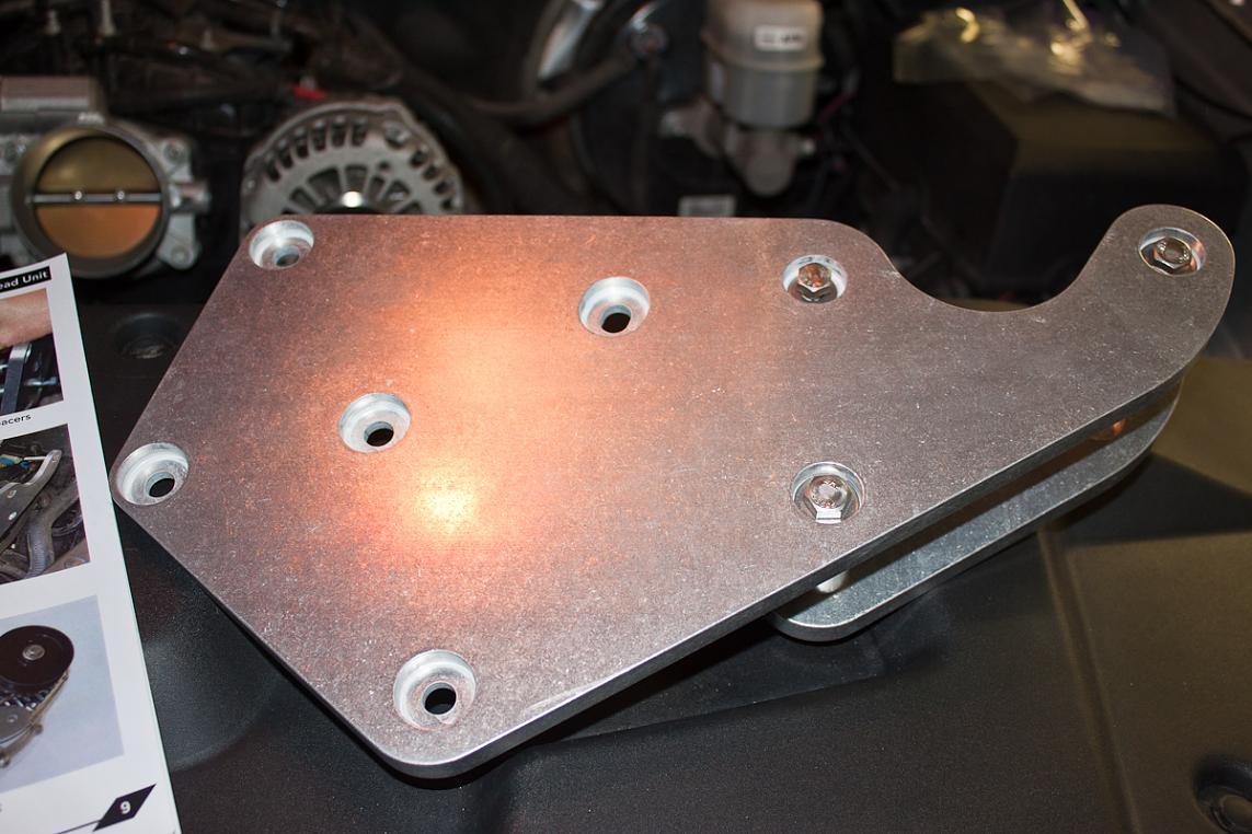

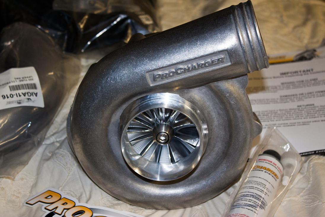

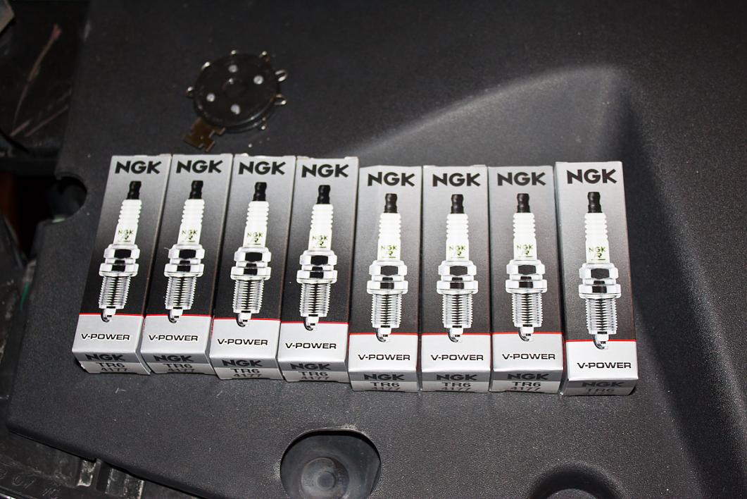

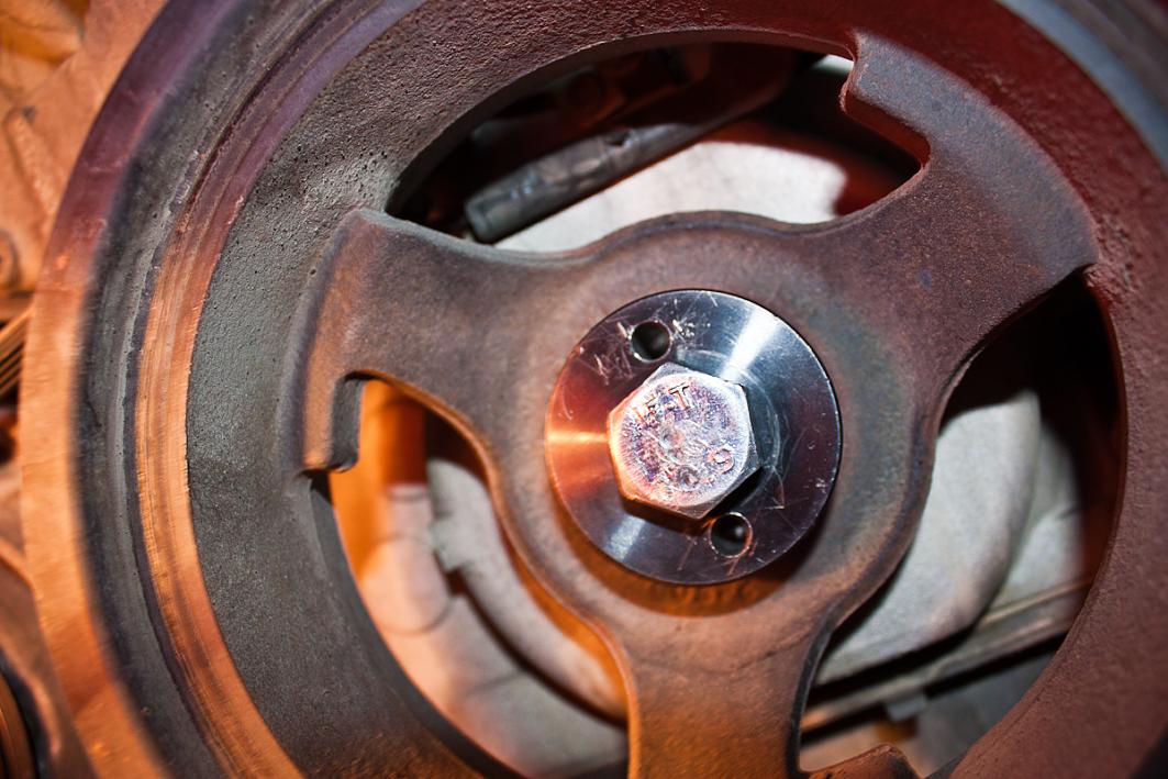

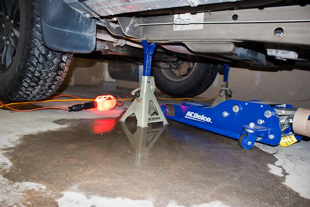

Well I was hoping to get into this earlier in the week but was hooked up with getting my house on the market and then had plans most the weekend so didn't get to working on it till later this afternoon. So far I have pinned the crank, changed the plugs...of which the one closest to the firewall on the passanger side can kiss my ***, and got the bracket installed. Was going to bolt on the Procharger to the bracket but there is no safe way of doing that with just two hands so will have the wife give me a hand tomorrow.
Oh.. and while it is embarassing I got a good laugh out of it. I relevied all the fuel pressure from the valve at the manifold and then used a valve stem tool to remove the inside since I am later going to use it for my fuel pressure gauge. Well me and my logical thinking didn't think about that when I went to turn the key on so I could play the radio in the truck. Next thing I know I see a solid stream of fuel shooting up from my engine bay. So quickly turned the key back off, cleaned up the mess and dissconected the negative terminal LOL
Pictures so far.
