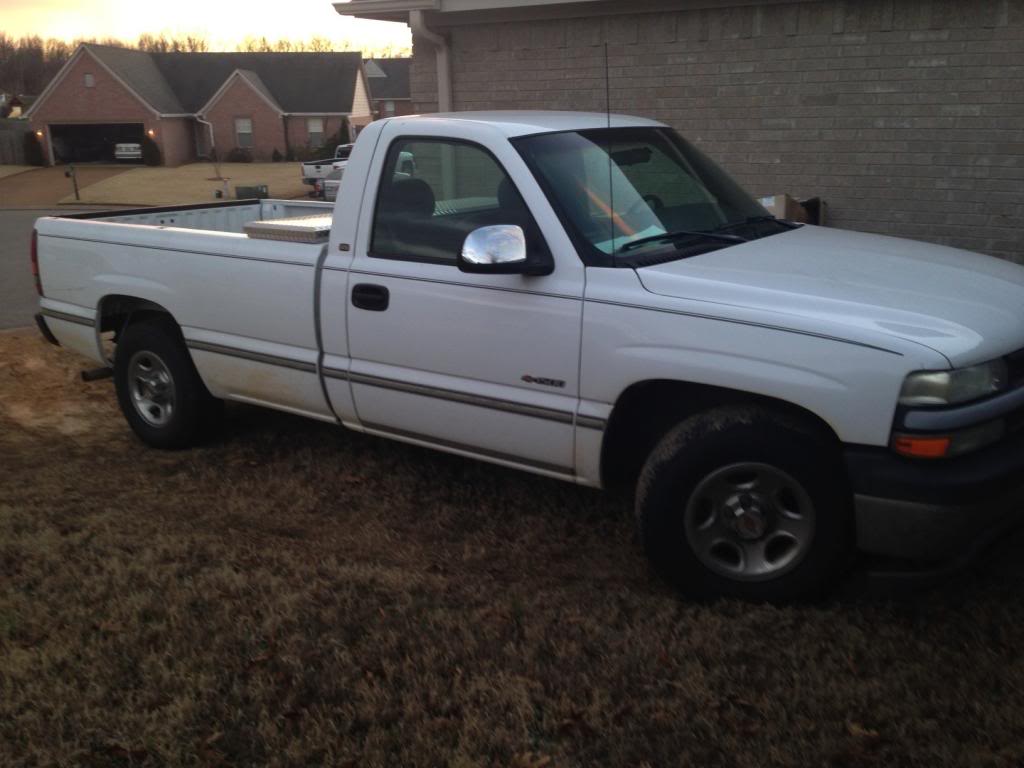

Hey guys. I have been contemplating this for awhile now, and it is time to get started. I will be taking my rclb and making it a short bed. You say why don't you go buy one? I tried, but I can't get out of this truck without losing a lot of money. So it will be modified!
my email is treyhughes@me.com I ask you to send me any pictures you have of your RCSB frame or just a pic with the bed off the truck, I plan to be very thorough and take many pictures!

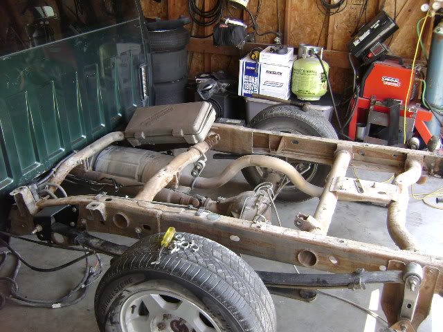

Original 2001 rcsb frame

Thanks Joey, are those bell tech drop hangers in the front?
