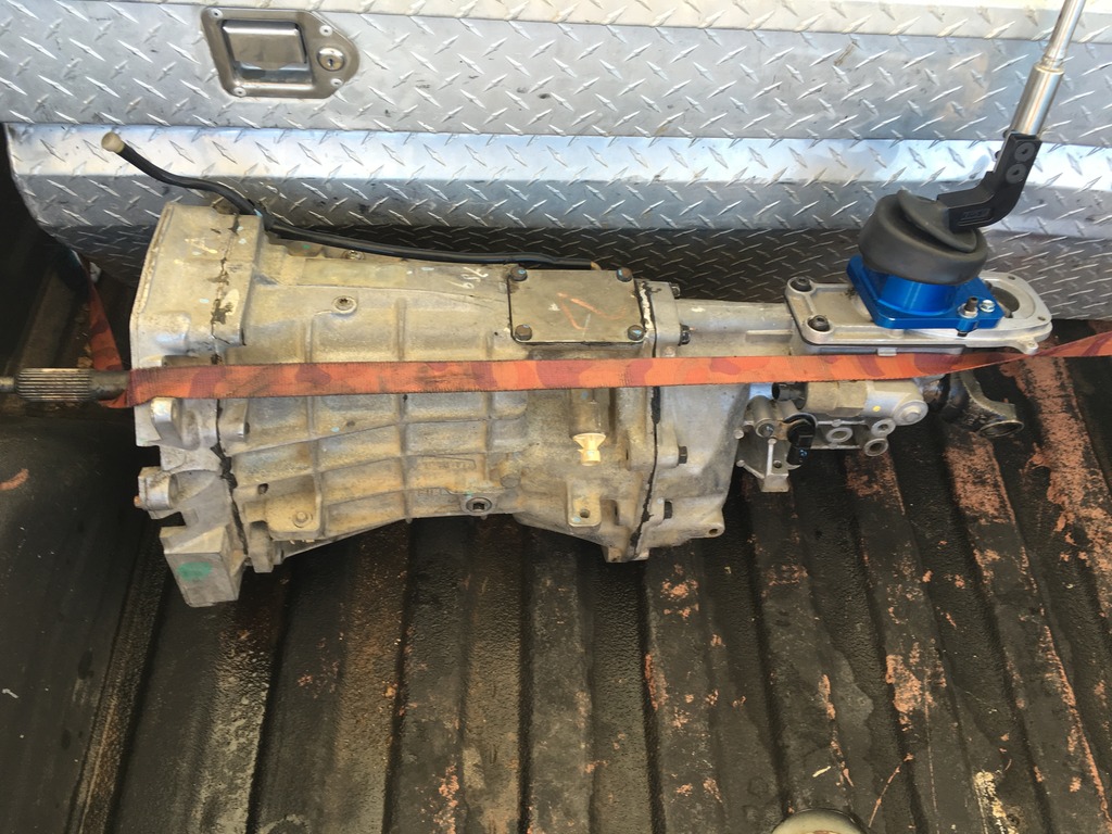

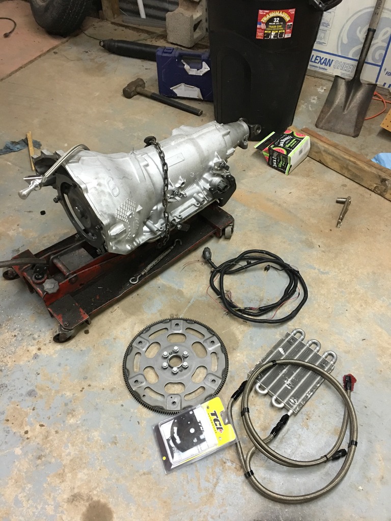

Got the shift solenoid changed and got the trans working. Then I decided to get rid of the 80e. I pulled everything and traded it for a t-56 swap. M12 t-56 out of a GTO, Monster Stage 4, and a B&M Ripper.

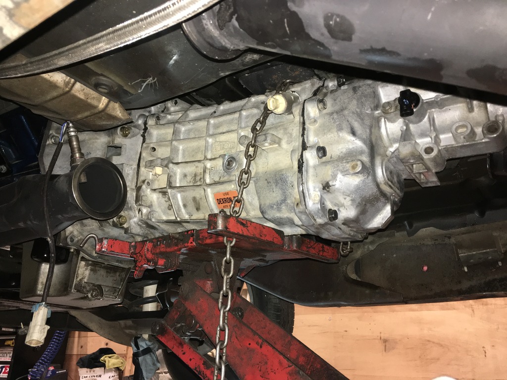

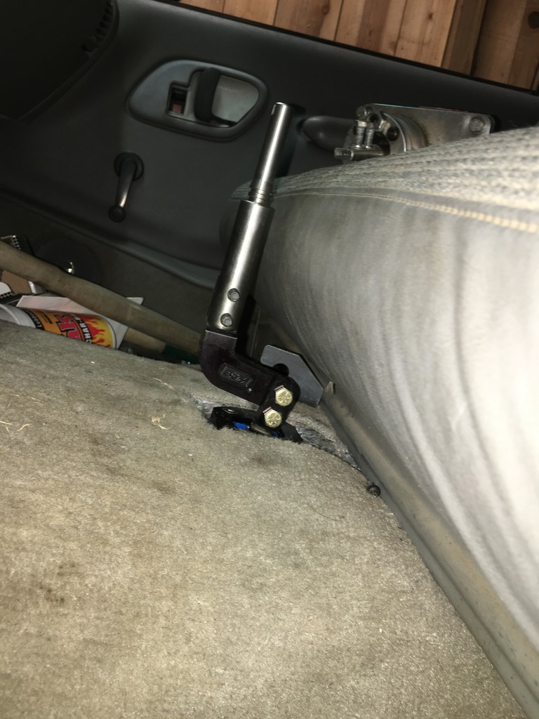

Got the t56 in for mockup. The shifter clears the bench seat surprisingly.

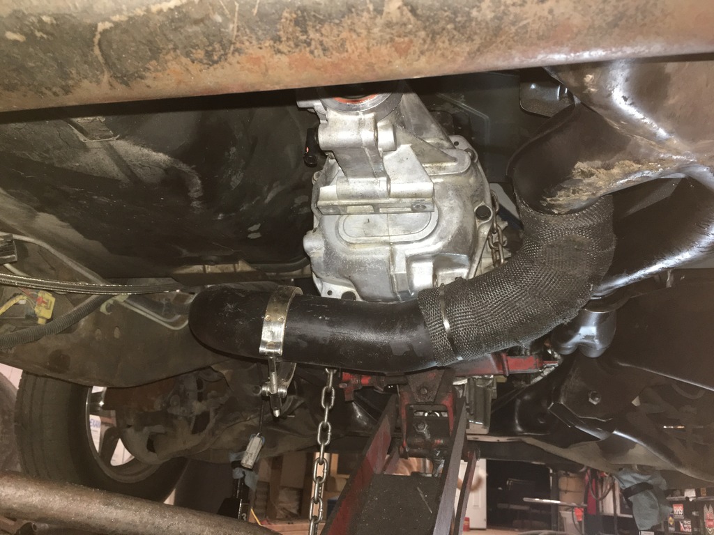

It also clears the exhaust.
