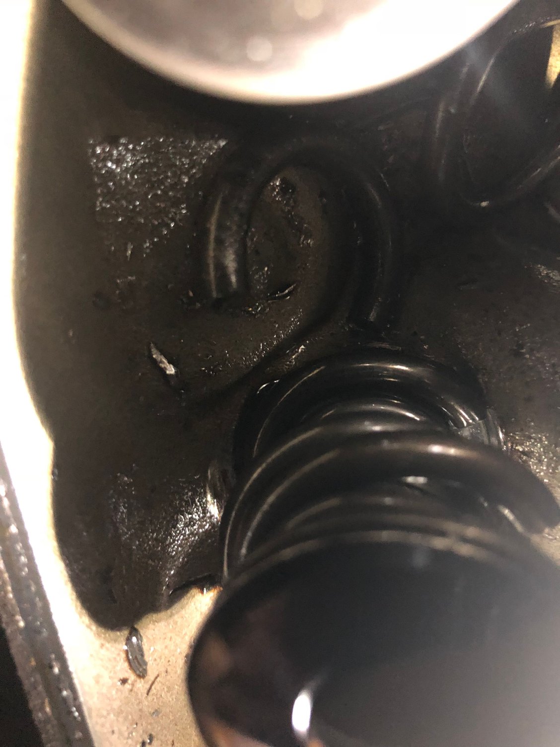

So i found the culprit.....FML!!!
Number 4 intake valvespring

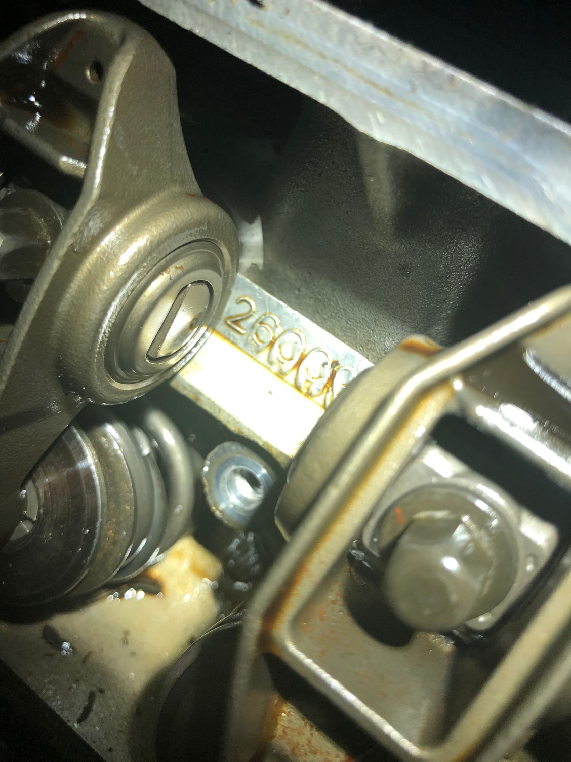

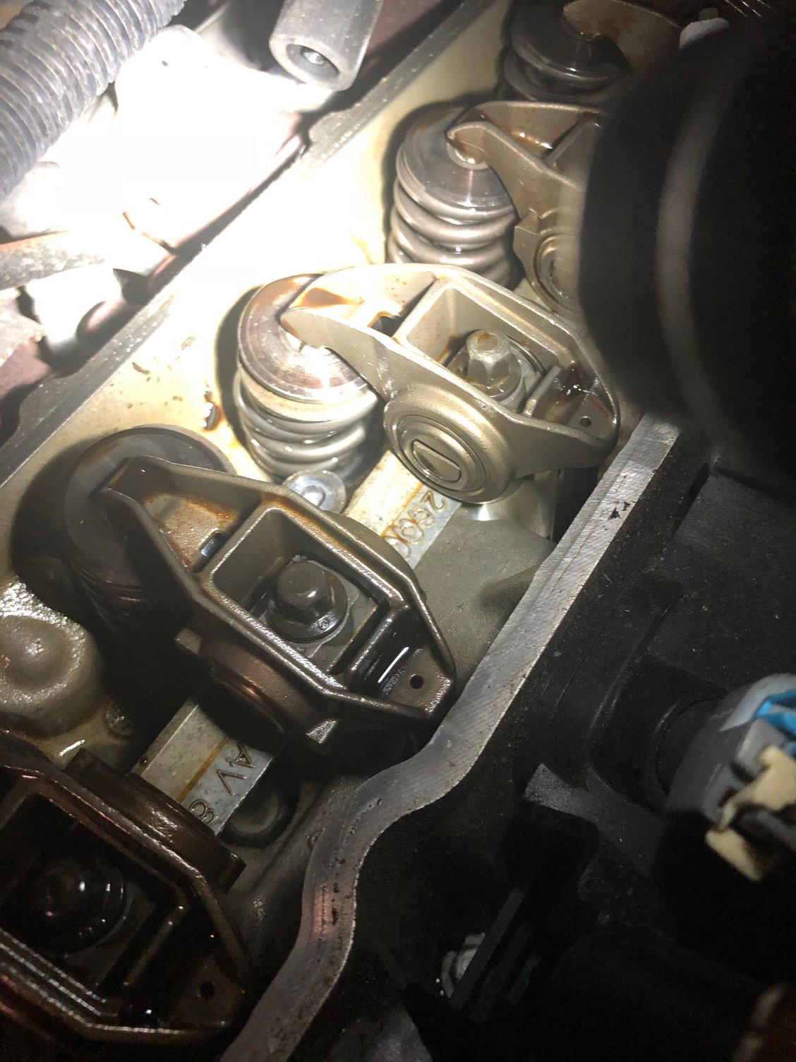

Guess its a good time to go ahead and put those pushrods and correct timing chain tensioner in too.... FML!!!! Part of me really wants to put one of the stockers i have in temporarily until i get a chance to buy another set of valve springs!!!! FML!!!

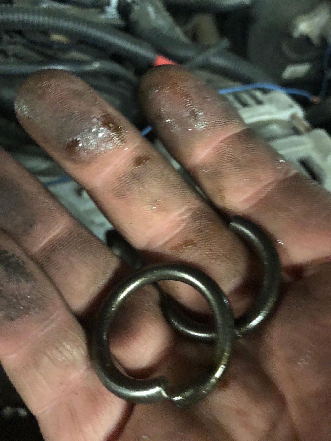

Ouch!!!

Not aure what it is about the #4 intake valve but i seem to have issues with it period, same one i broke the bolt off in on the silverado.....

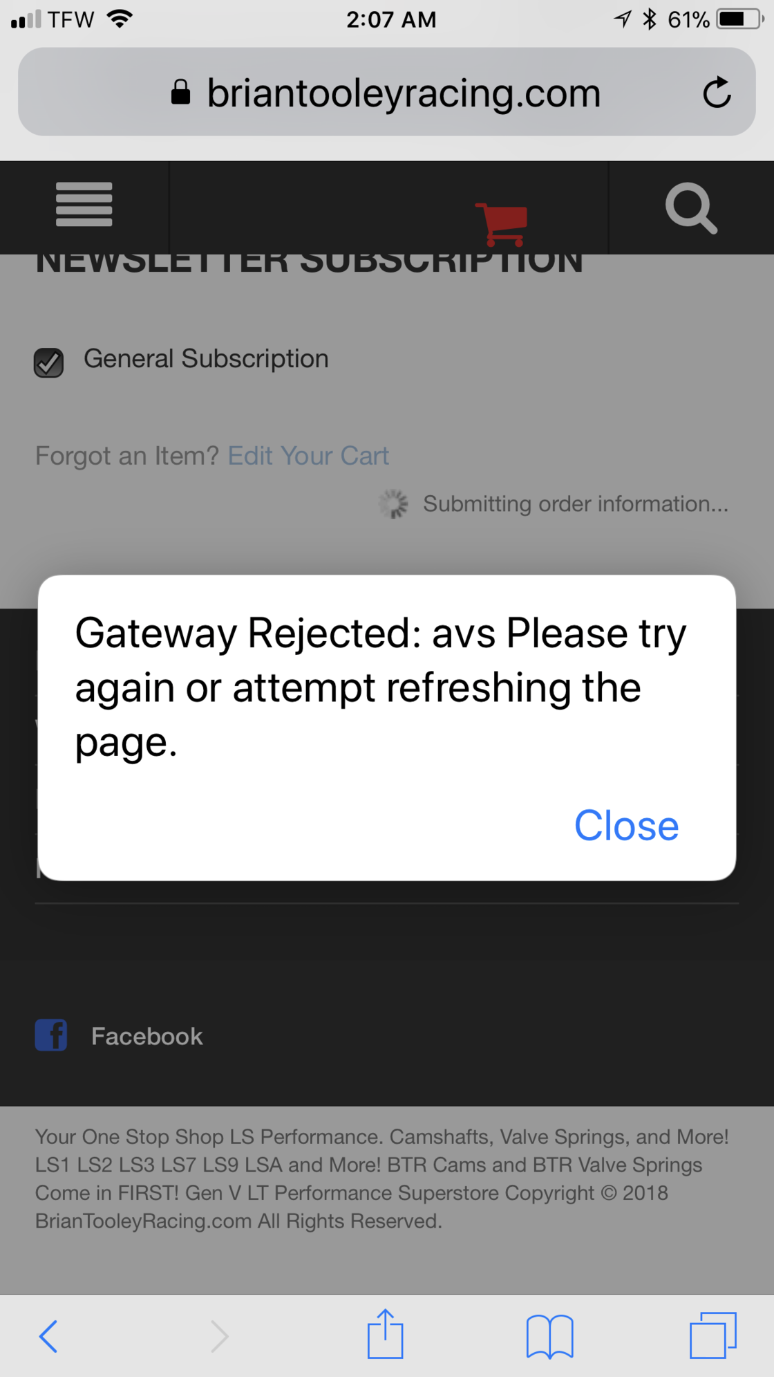

Thanks wretched73 i found those last night, after i asked and started searching, ended up having to order it through little john motorsports because btr’s site kept giving me this.....
