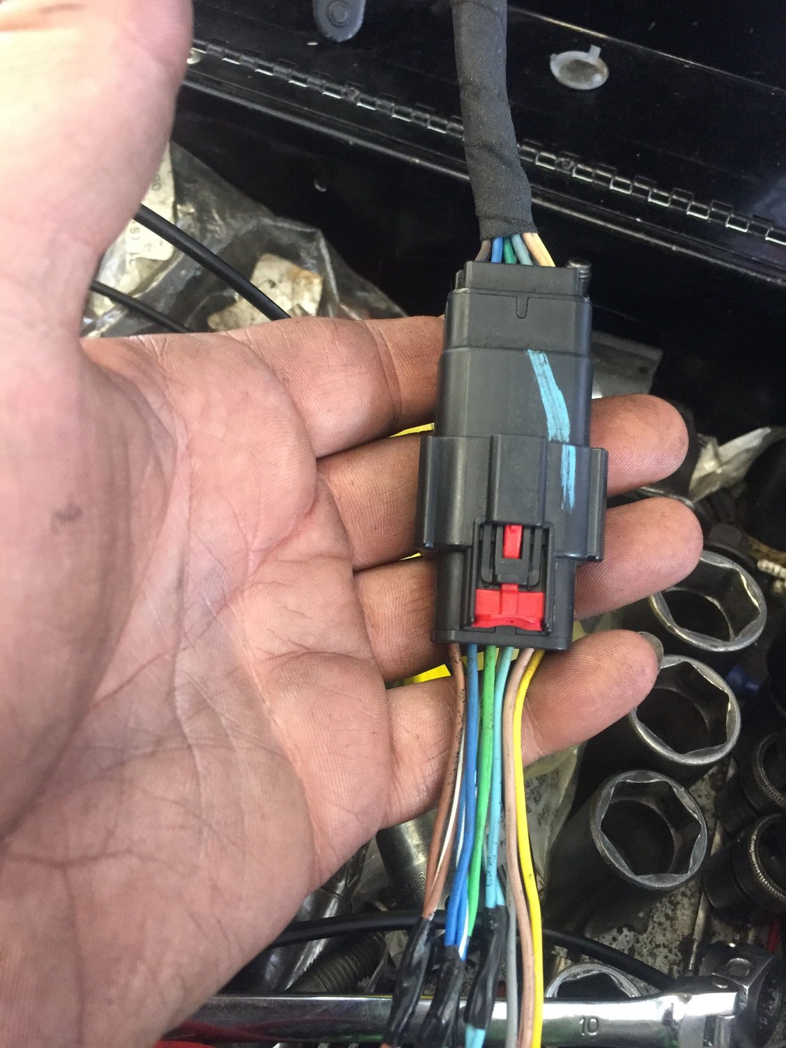

Found a connector to use to replace the bundle of butt connectors i currently have to conect the fpcm and bank 1 downstream o2, sadly it is a fuel injector harness connector from a 2.4 equinox.... my other option is to find an 09ish impala and get the chassis harness connector and splice my original connector back in

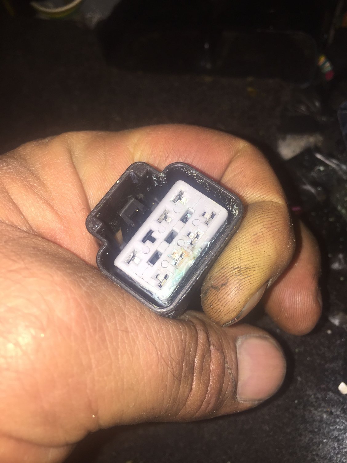

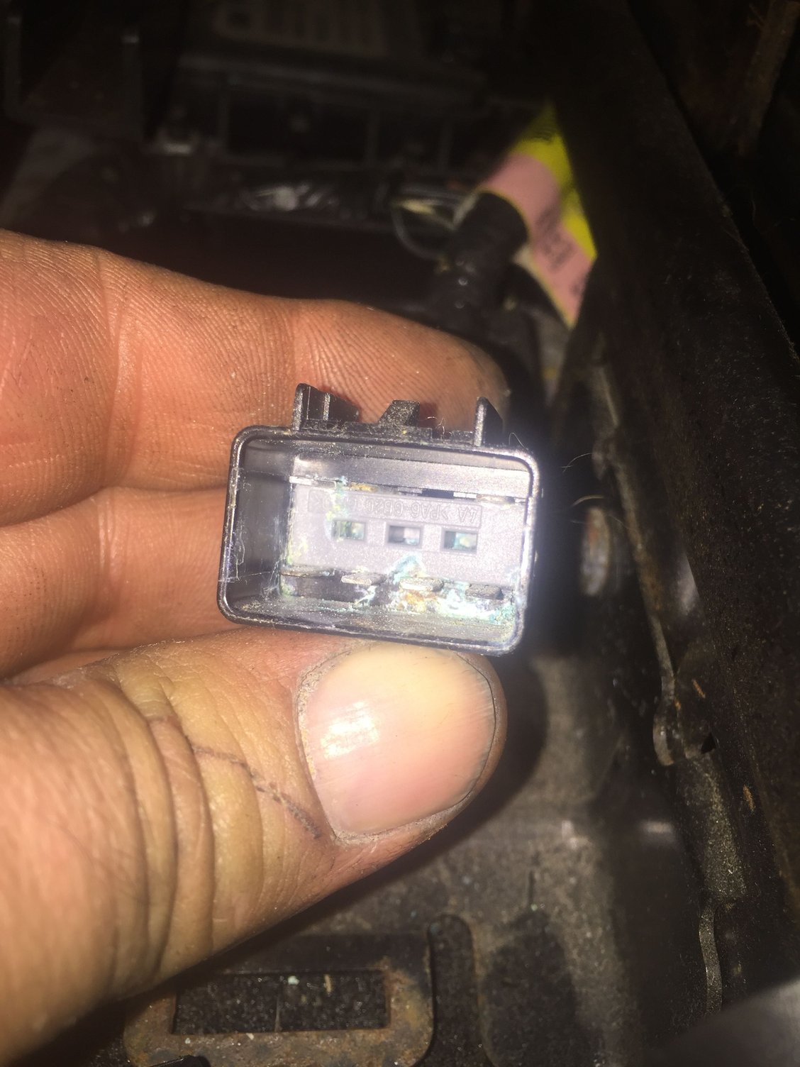

Just got xm back though.... unplugged it for a couple minutes..... and plugged it back in and it works again.. wanted to check the object sensor module connector to see if maybe it had some water in it and found this
Seat harness connector is corroded pretty good on passenger side, but for ow seat is working fine!!!
Going to pull the rear object senor harness at the rear bumper by the tailpipe apart and let it sit after i blow it out and spray it with brake clean to get the water out of it.. its partially melted so it will need to be replaced eventually but for now i just want to get it working again.. hoping that is the communication issue with the module but i an sure i am not that lucky...
