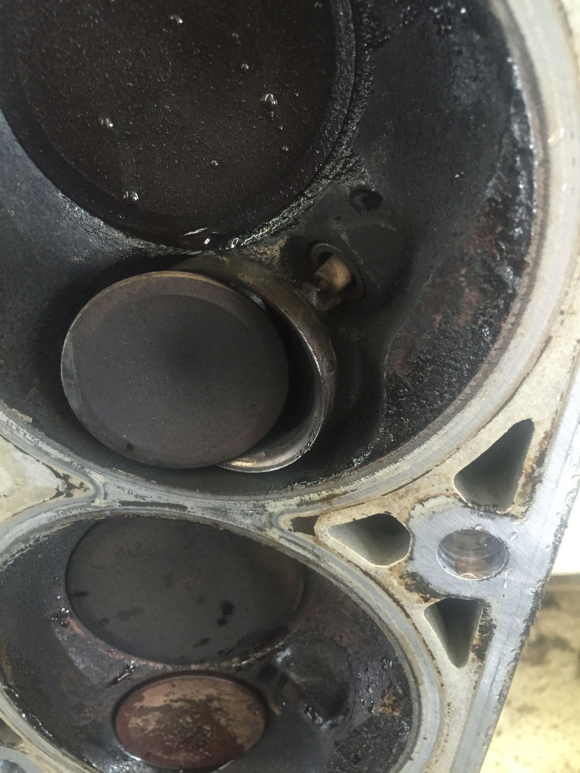

Had a caprice ppv at work today with a knocking noise.... Pulled codes, checked data, between engine and misfire, confirmed what i was hearing that it was coming from the left bank, so i pull the valve cover.... The #3 exhaust rocker has just about losts its trunnion on the side closest to the front of the engine, something told me to pull the pushrod just to check it, turns out pushrod was bent... Get new rocker and pr and button it up enough to start it... Still has a noise..... Realize the valve is keeping the spring compressed and at this point is sitting about 3/8" or so lower than the rest of the vavles... So i pull decide its time to yank the head and see whats going on with it, and this is what i found....

How old was the caprice PPV? It's crazy that the seat just droped out like that.
Was it overheated at all?
Does it look like the water pump might have been replaced?

13 with 55,000 miles.... Radiator was low butblock was full water pump looks to be oe...
