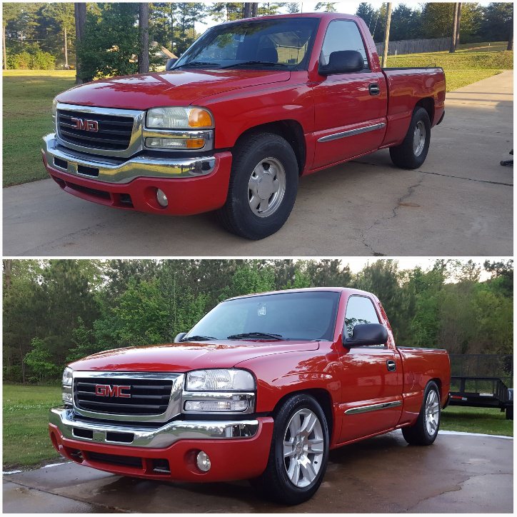

Little update here. I have been doing a little more cleaning up the truck aesthetically.
I bought new OEM style headlight off Amazon to get rid of the yellowed lenses (I couldn't quite get it all cleared up just by sanding/buffing). I didn't care for the fit and finish on the amazon housings, so I swapped the amazon new lenses onto the factory housings and added some clear reflectors from klearz manufacturing to clean up the look a little bit. I also got clear turn signal lenses.
I swapped most of the lighting on the inside and outside of the truck over to LED except the headlights and foglights due to the fact that I am still running halogen housings. I also still have to do my gauge cluster and AC controls in LED. I did buy a used Escalade cluster from a member here to replace my factory gauge cluster. It had started blinking and the odometer wasn't working anymore.
I just about have done everything I want to do to the exterior except maybe color matching the handles and mirrors, removing the side molding, and tinting the windows. It'll take a whole new paint job to make it look much better that it does now, but that'll have to wait. It's about time to start on more performance mods.
I have included a 1 year "transformation" from when I bought the truck to now. Excuse the flipped GMC emblem on the original picture. I had to flip the picture to get the same point of view.

For a second there I though somebody had stolen my truck when I scrolled down to the second pic! Yeah color matching the handles & mirrors and deleting the chrome spear moldings will really clean up the look.

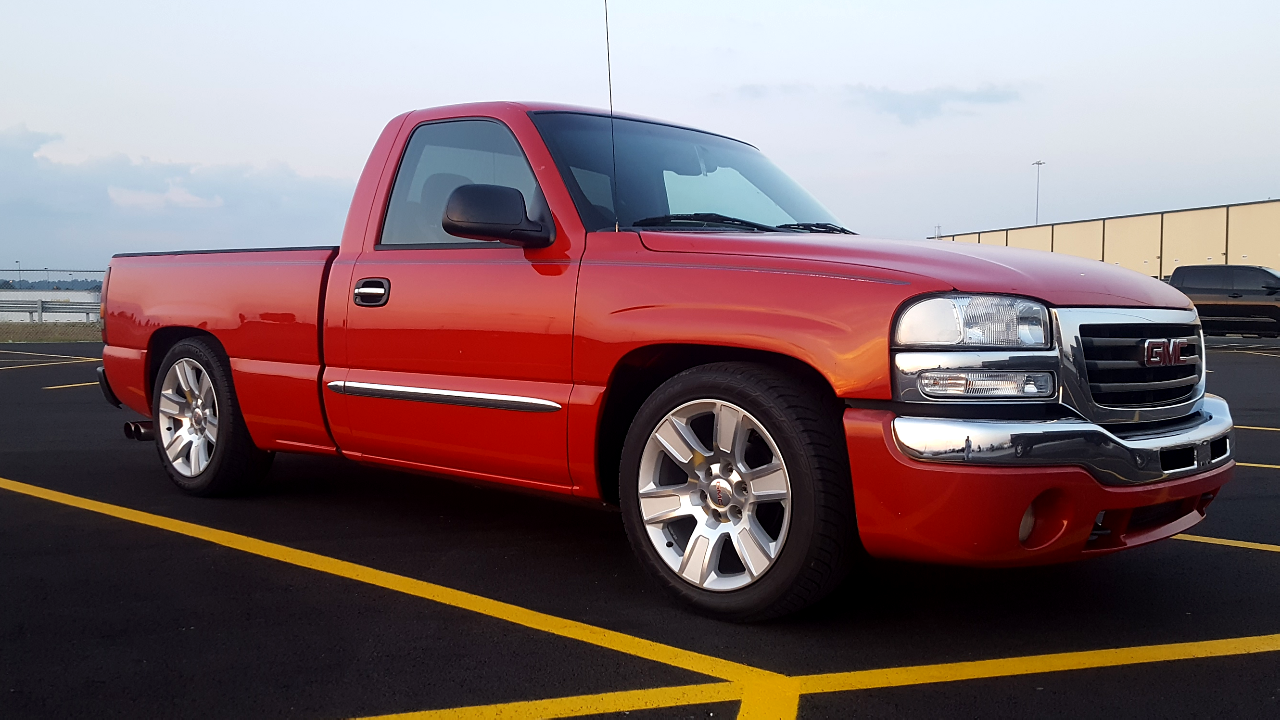

Small update here. I went in last weekend and replaced all of the front steering/suspension components to help the ride. The truck was getting dangerous to drive due to the amount of vibration and stuff it had when hitting small bumps, etc. Kind of reminded me of "death wobble" that Jeeps have...
Anyways, got new upper control arms, inner and outer tie rods, sway bar end links, and both wheel hubs for the front end. Also ordered some Hankook Ventus ST in a 275/45/20. I had the 2015 Sierra factory tires on it before that were a 275/55/20. I like the new stance more with the slightly shorter sidewall, and the truck rides like night and day from before. The main culprit of the bad ride were the inner tie rods. They would rattle around by just shaking them once I got them off the truck.
Quick updated pic this morning.
