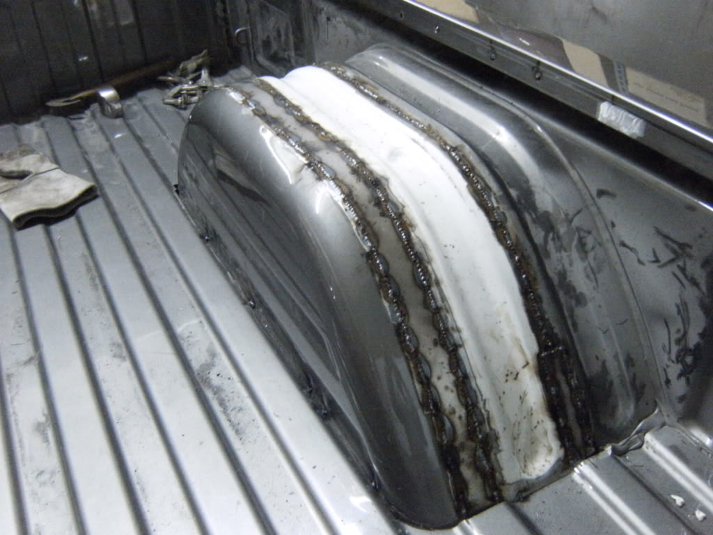

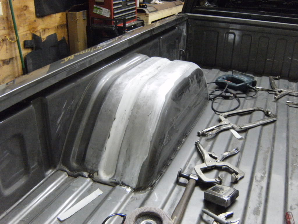

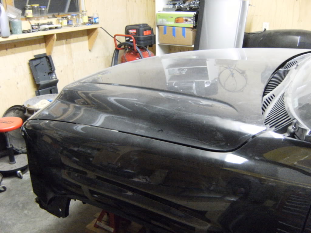

Well figured I'd share a couple pics...
Got the driver side done, it's "pretty" smooth, enough for a skim coat of rage and then line-x

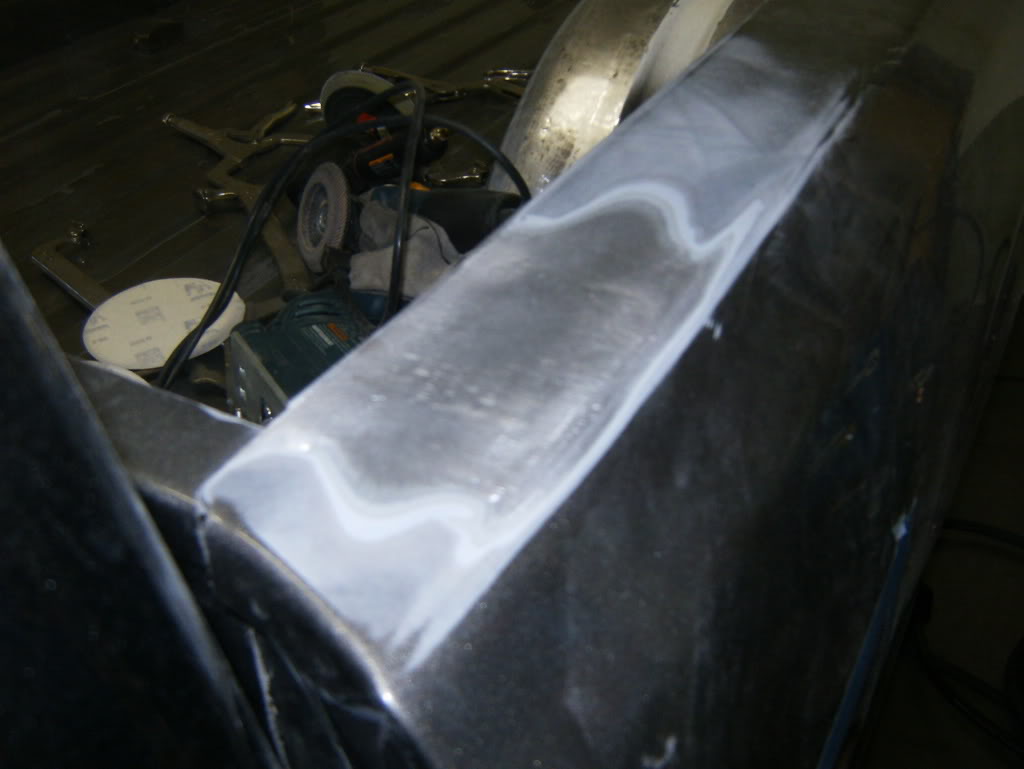

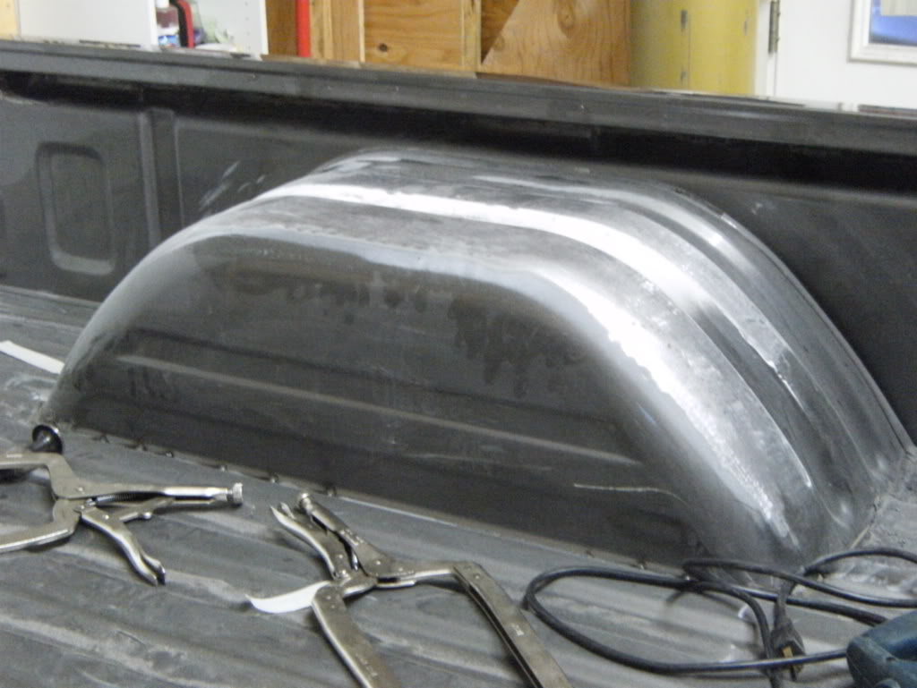

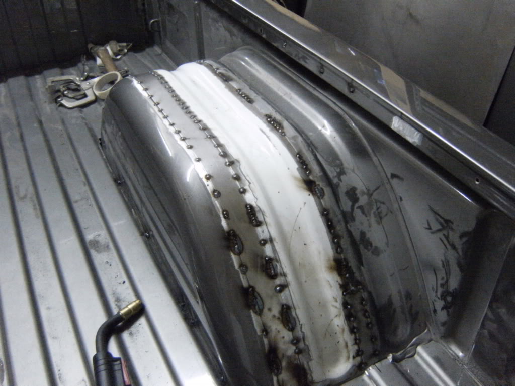

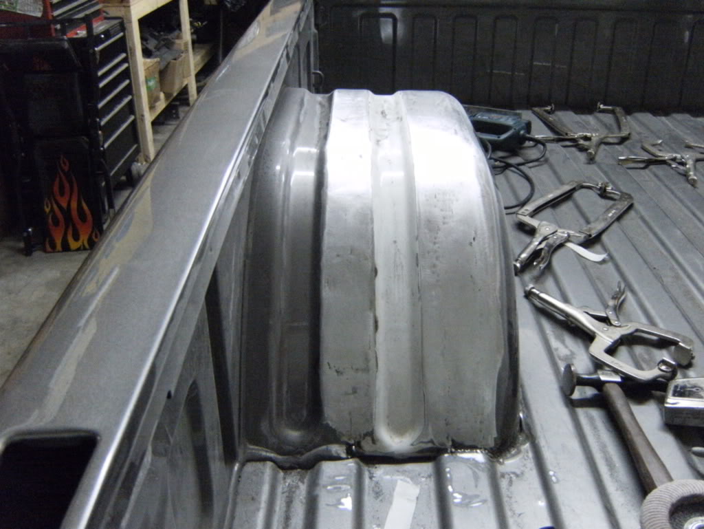

Then the passenger side

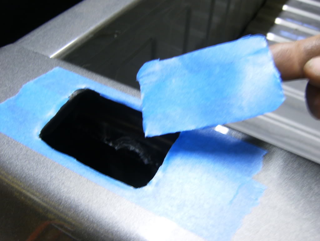

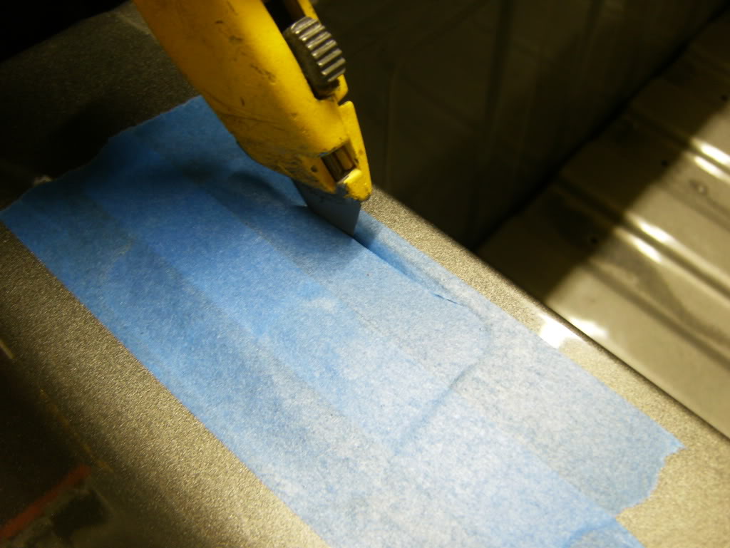

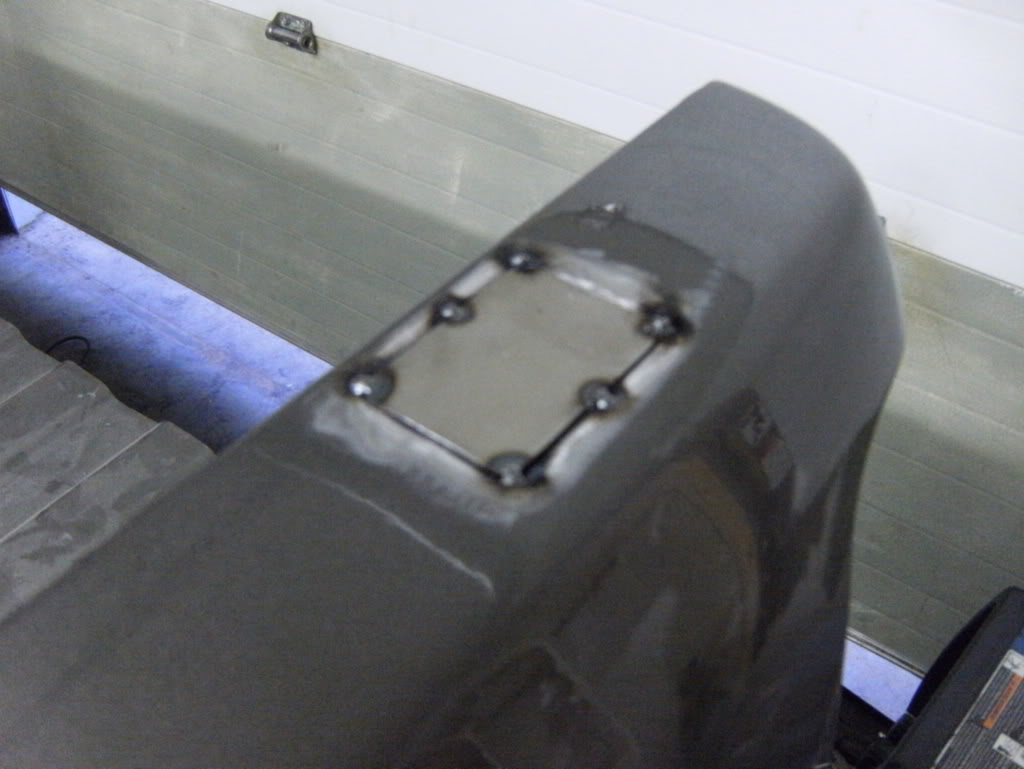

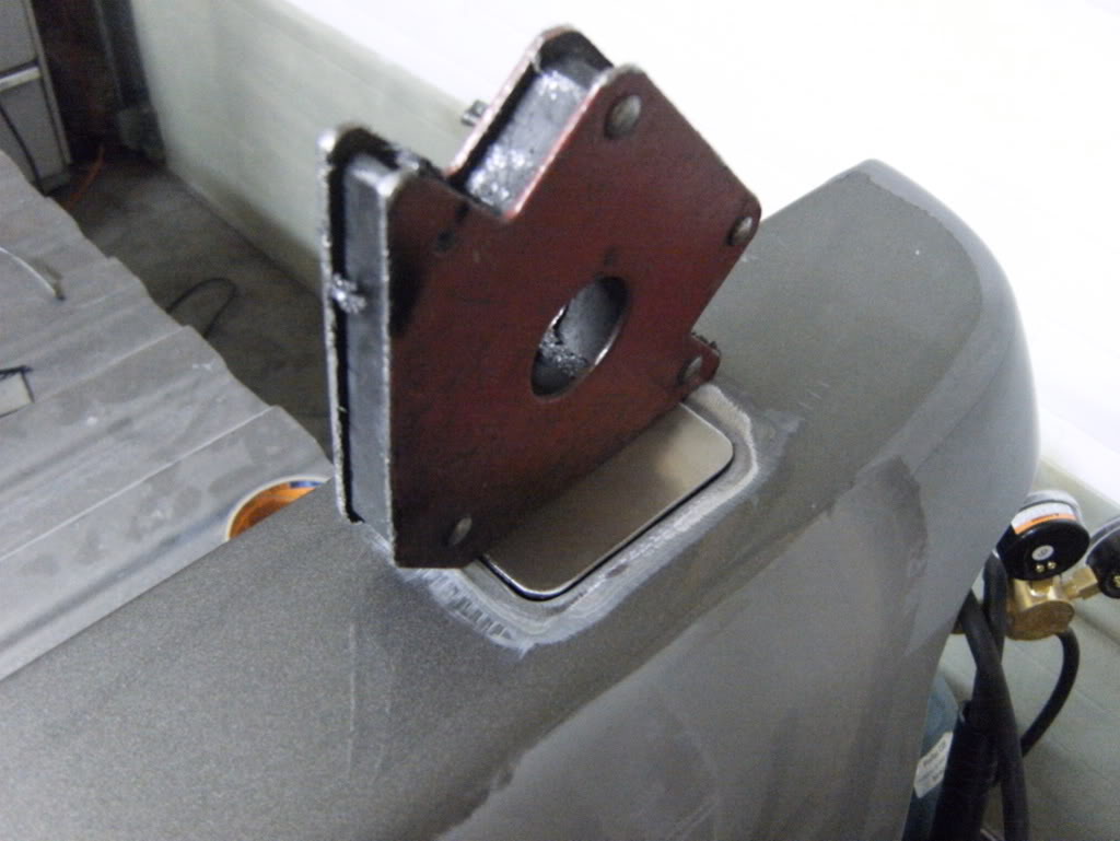

I ended up finishing it, then started on the stake pockets, shaved.

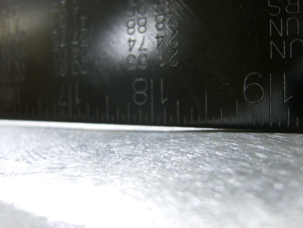

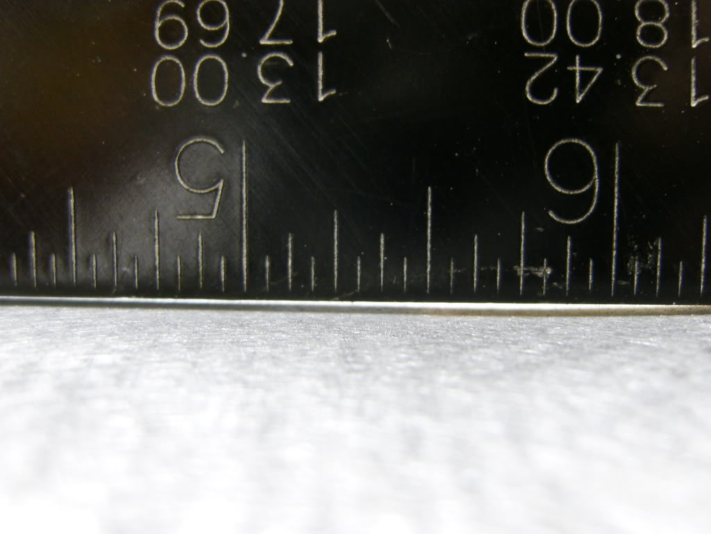

Got the stake pockets nice and smooth and pretty close to flat, just a little filler, but on the sides I'm on paint and this shows the height from the paint to bare metal. Less than 1/16"
Another pocket
