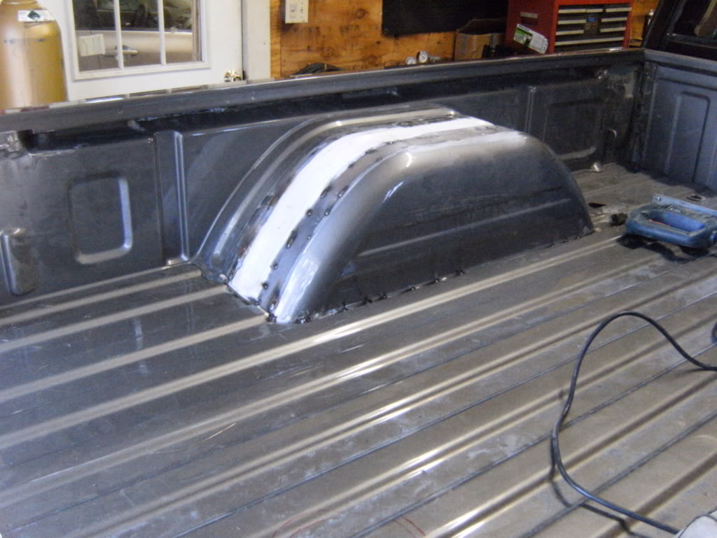

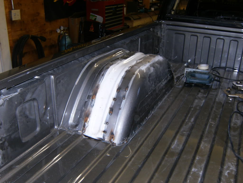

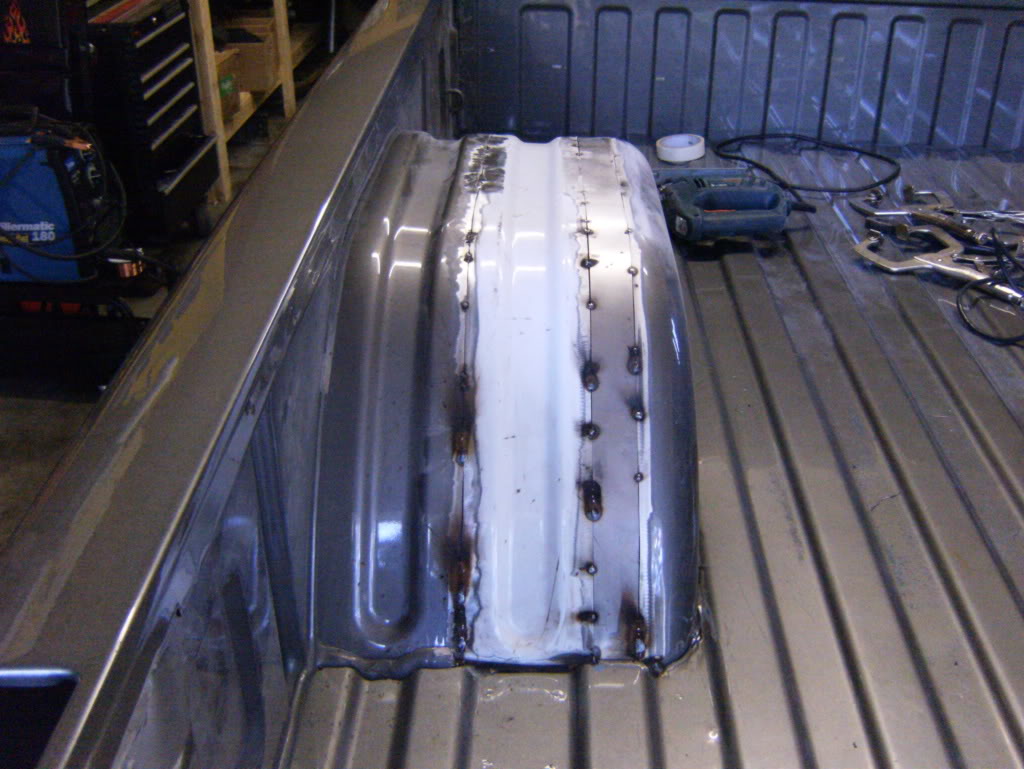

Little update... been working on it here and there, but trying to save my money so I can order the rest of my ART stuff.
Well you all know I've been waiting for a set of stock tubs, and well I got some and used about 4.5" of them haha, just so I could mimic the dimple the same. Then I added a filler and side piece and what I have is a "stock looking" tub widened 6"

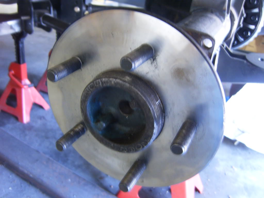

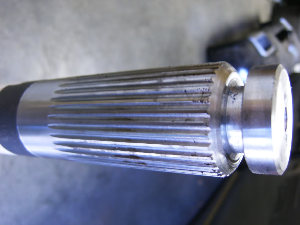

I was asked for pictures of the filled and redrilled axle ends, and resplines, so here you go

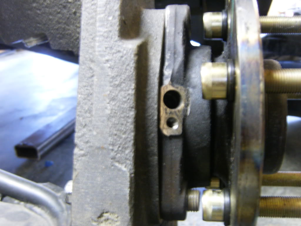

Another thing I noticed, going to have change out the studs Moser used, or find a 3/16" nylock nut since on the McGaughys spindles, the upper bolt is now a stud, it's going to hit the wheel stud otherwise. You can see how close they are on the bottom

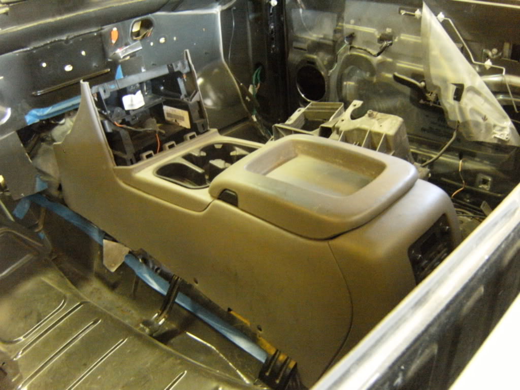

Picked up a 03 Console, $100

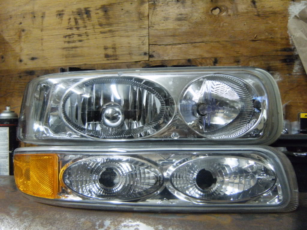

Finally, my corners. I felt they matched my Xenarcs pretty well, I plan to order a set of clear corners and take the lense with a clear reflector and install that lens
on this housing. Depo makes these corners, if anyone is wondering.
