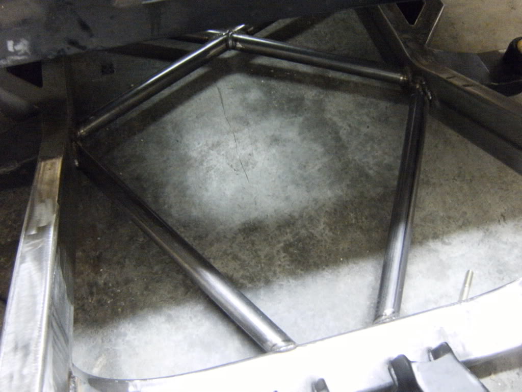

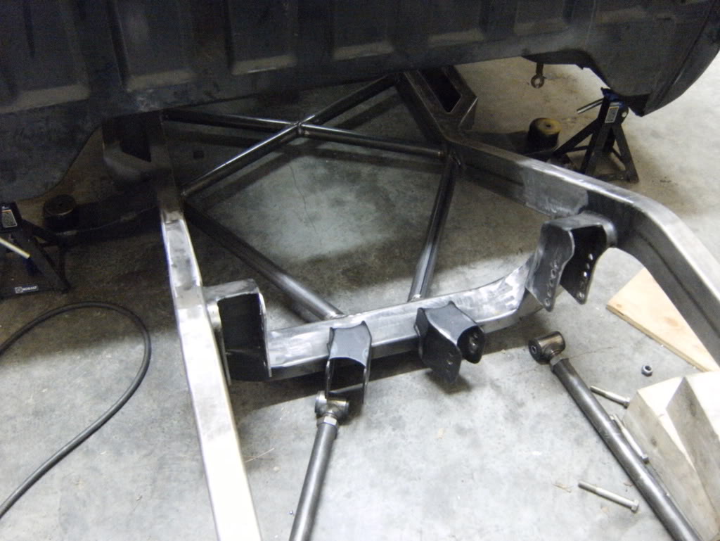

Well I found a slight flex out back wanted to add another triangulated brace

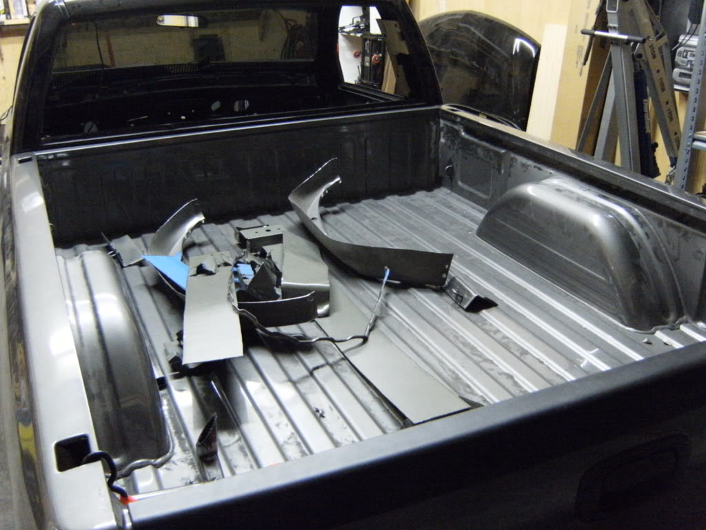

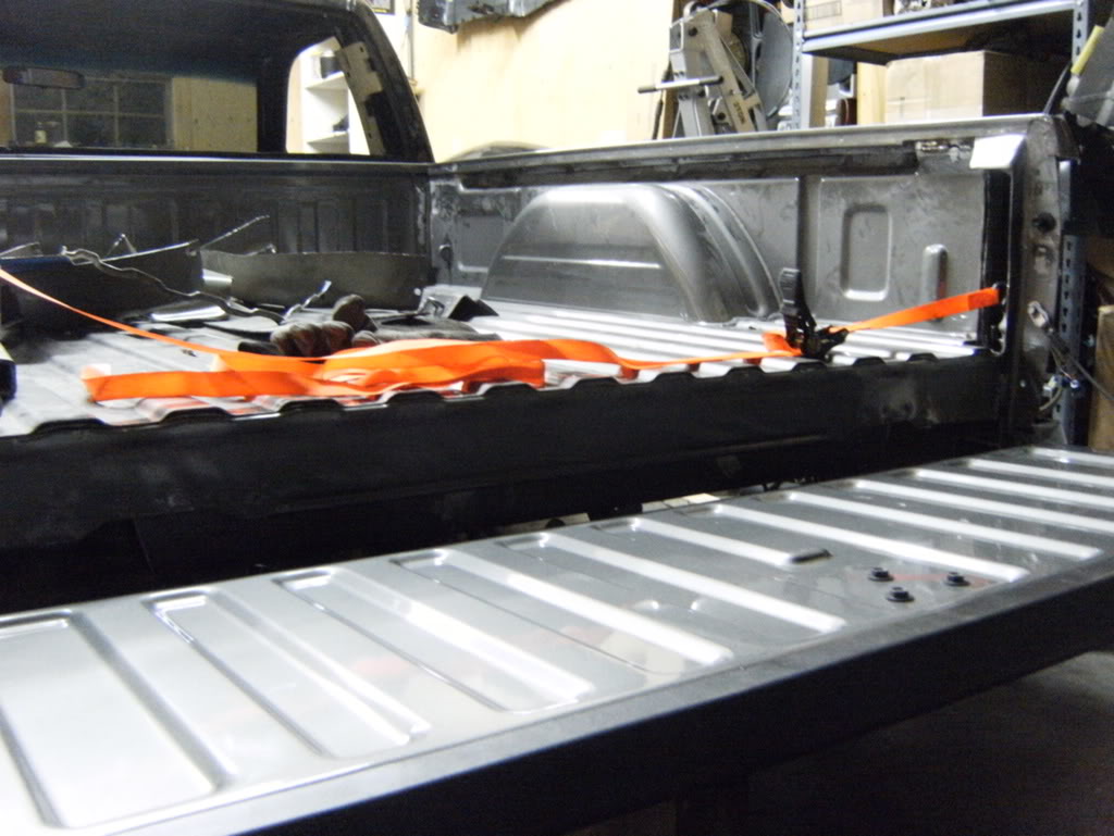

Brand new, perfect condition bed...
Now all cut and section bed floor raised 5.5"
I didn't want to go more then 5.5" So to get the last >1" I'll section the bed crossmembers over the frame.

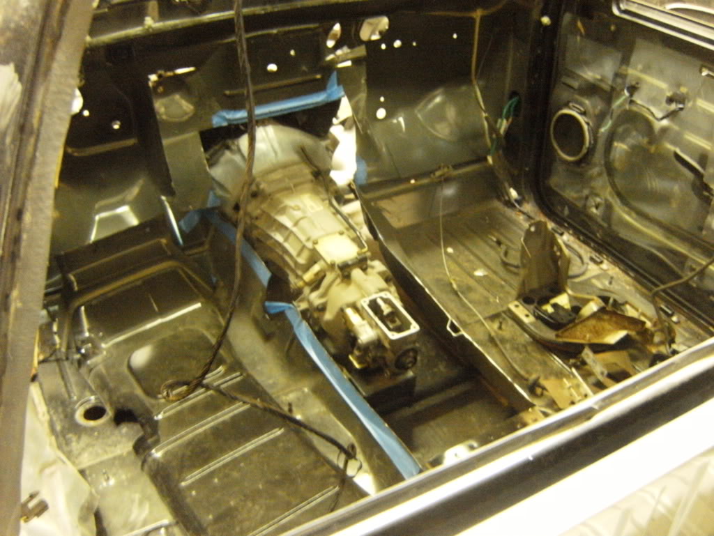

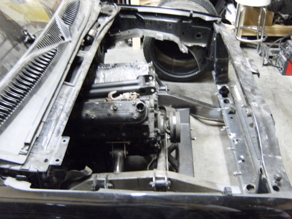

Cut the firewall and trans tunnel out to accommodate the motor, (body dropped 2", motor raised 1" and moved back 1.5"

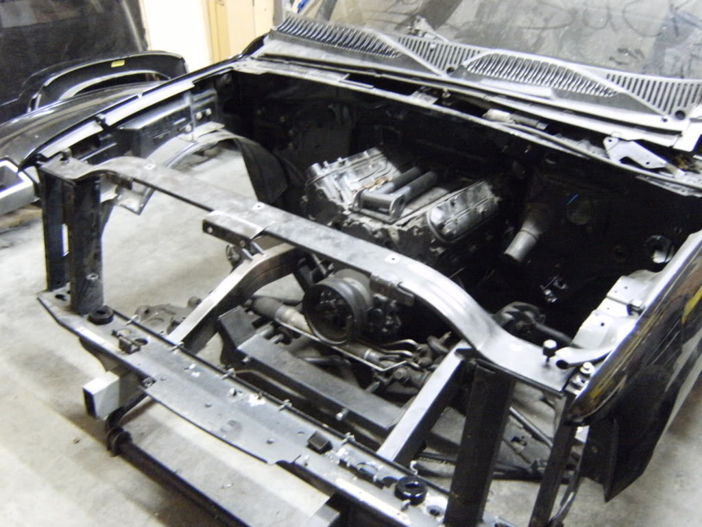

Motor view, looks pretty far back without any accessories on it

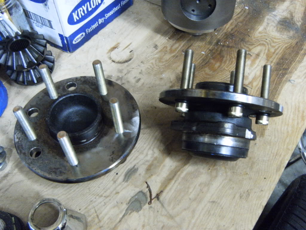

Got my hubs from Moser Friday, should have my axles this coming Friday
5x5 lug pattern, 1/2"x120 screw in studs

dude its looking awesome! that bed is bad ***! what are you going to do about the tailgate? are you going to have a functional gate or no? its starting to come along very nicely getting closer!
