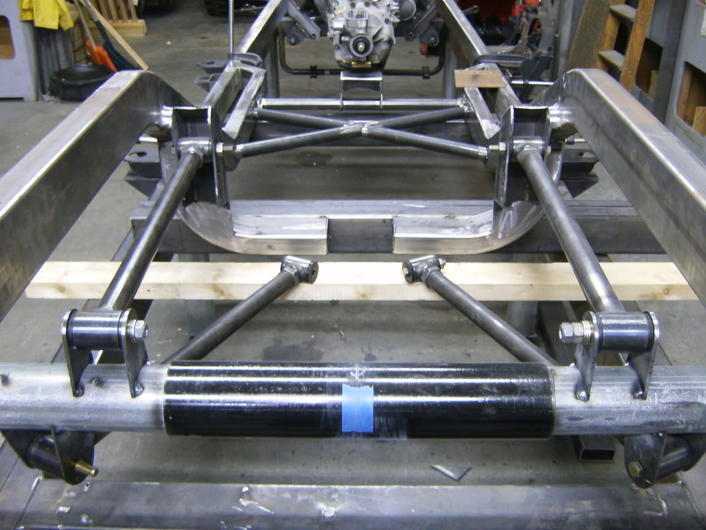

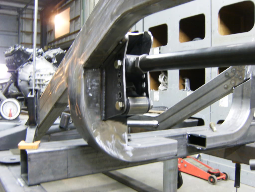

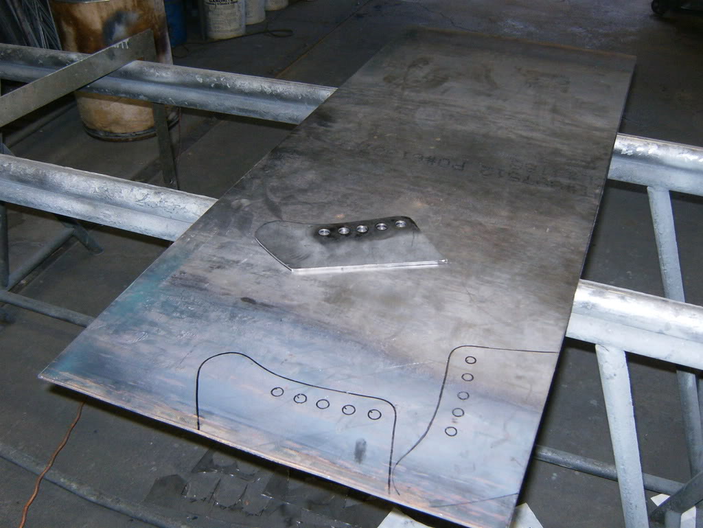

Grabbed another sheet of 3/16"

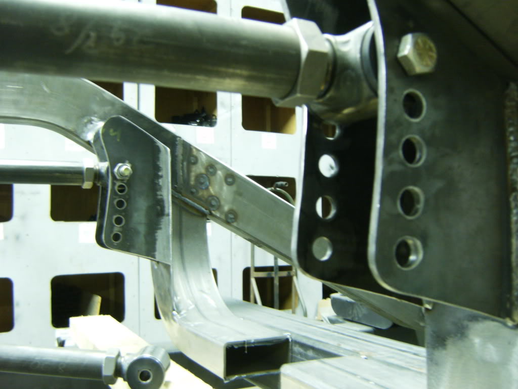

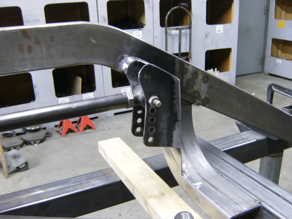

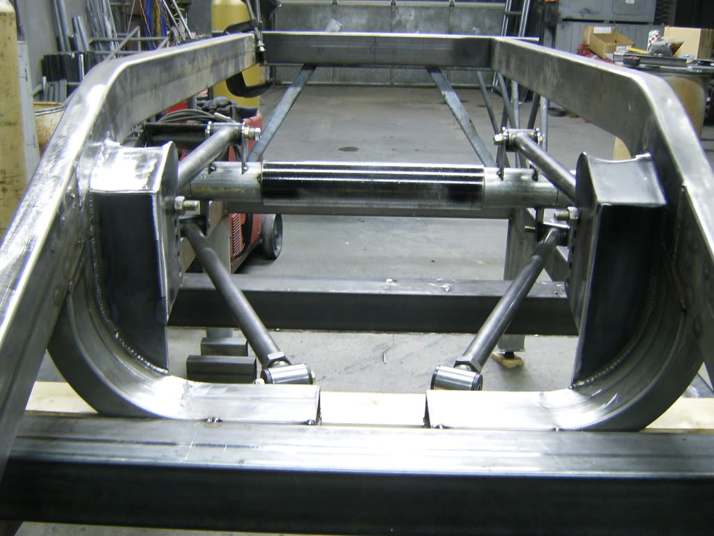

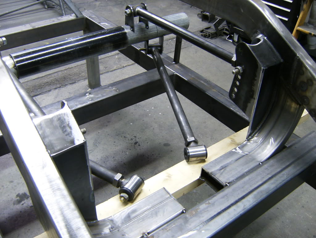

Built my upper link mounts, going to gusset behind them otherwise they are basically done

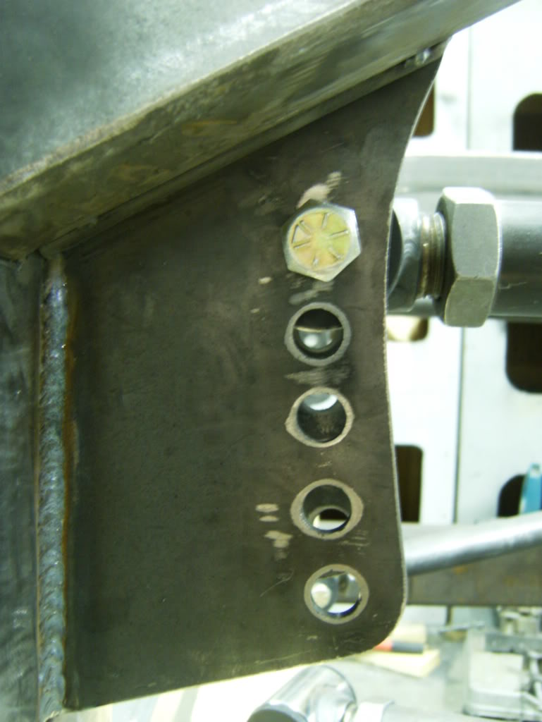

As you can see here the holes I drilled on a 25" radius (same as bar length) no need to re thread as I adjust my bar angles
