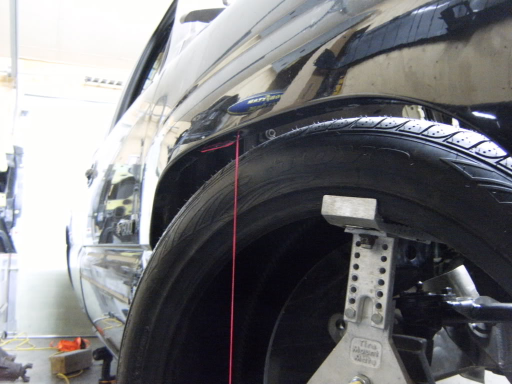

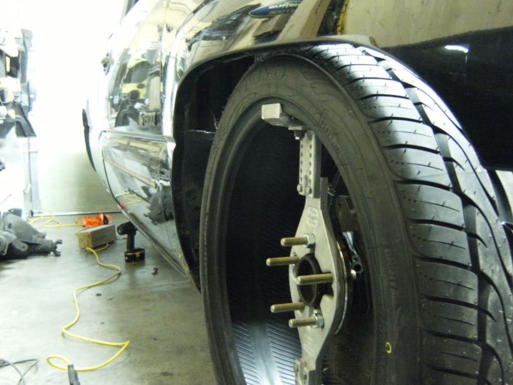

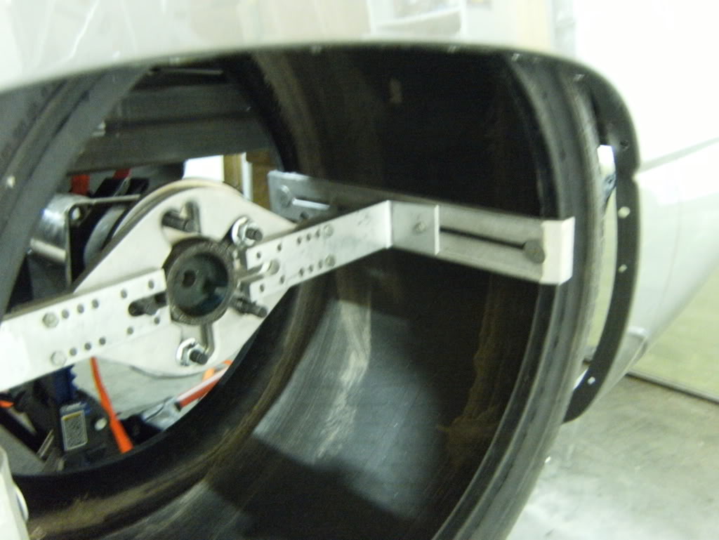

First of all big thanks to Marty, owner of the incredible http://www.syborgtwinturbo.com/ Big help in letting me use his wheel tool. Made it so easy to measure and check clearances.
I did however notice my wheel wasnt perfectly centered in the wheel well, and that pisses me off, however I'll be able to adjust it once I get the bed permanently mounted I'll figure out just how much I'm off.

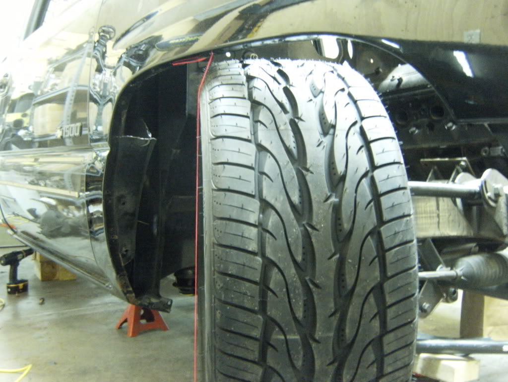

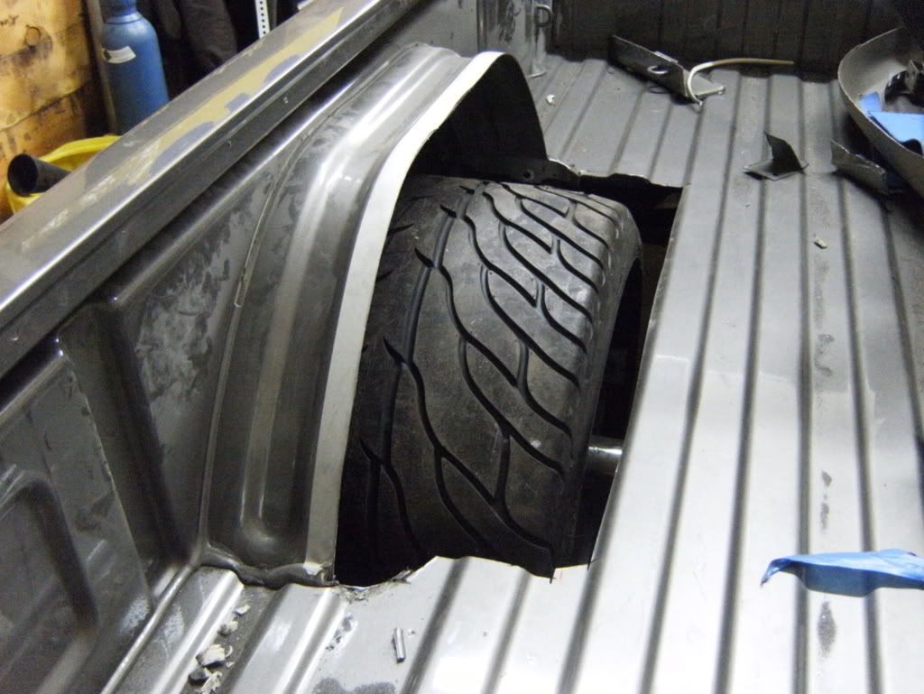

Cut out for the tubs, still looking for a spare set of factory tubs if anyone has any laying around. Basically I want to mimic the factory just 6" wider.

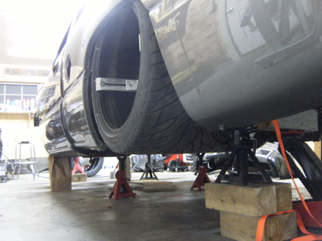

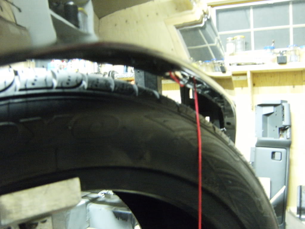

One thing I hate is when people run big wheels, or such and the tires and wheel are soo tucked in leaving a huge gap between the bedside and tire, even though sometimes it requires that to fit way up top. I kept it tight, here you can kind of see the tire just touches that lip, well I plan to roll that edge so the wheel will be pretty close to the actual bedside. Laid out I still have a fingers gap up top against the bedside

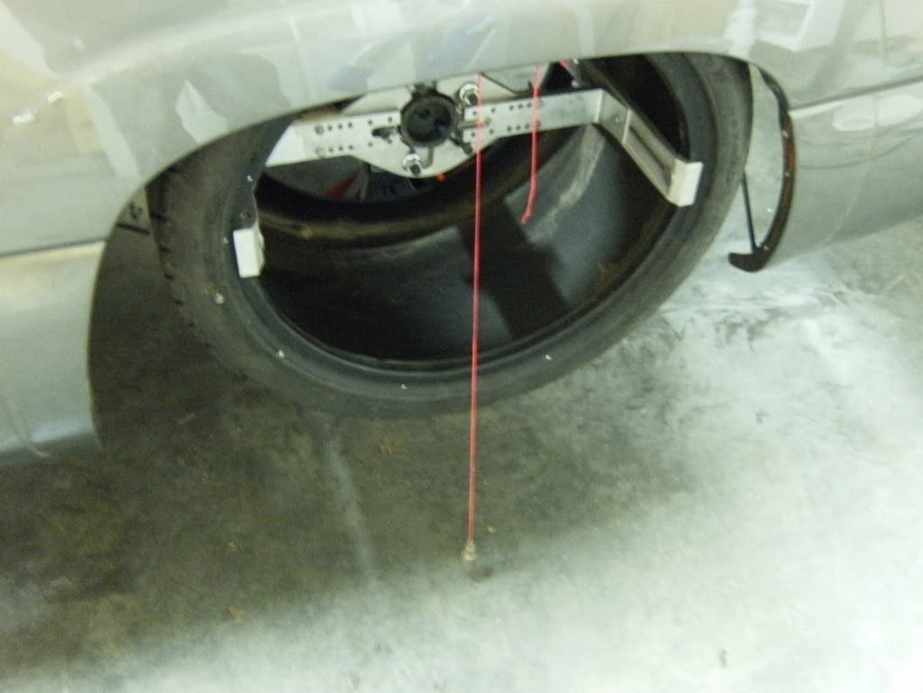

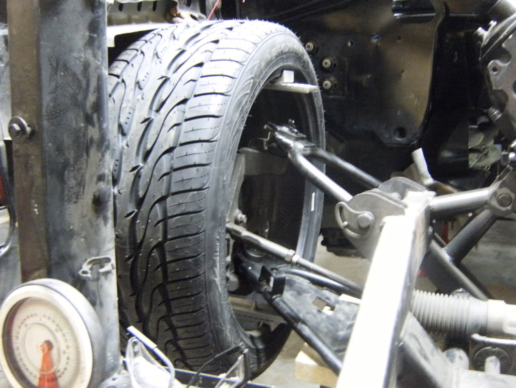

Measuring for backspacing

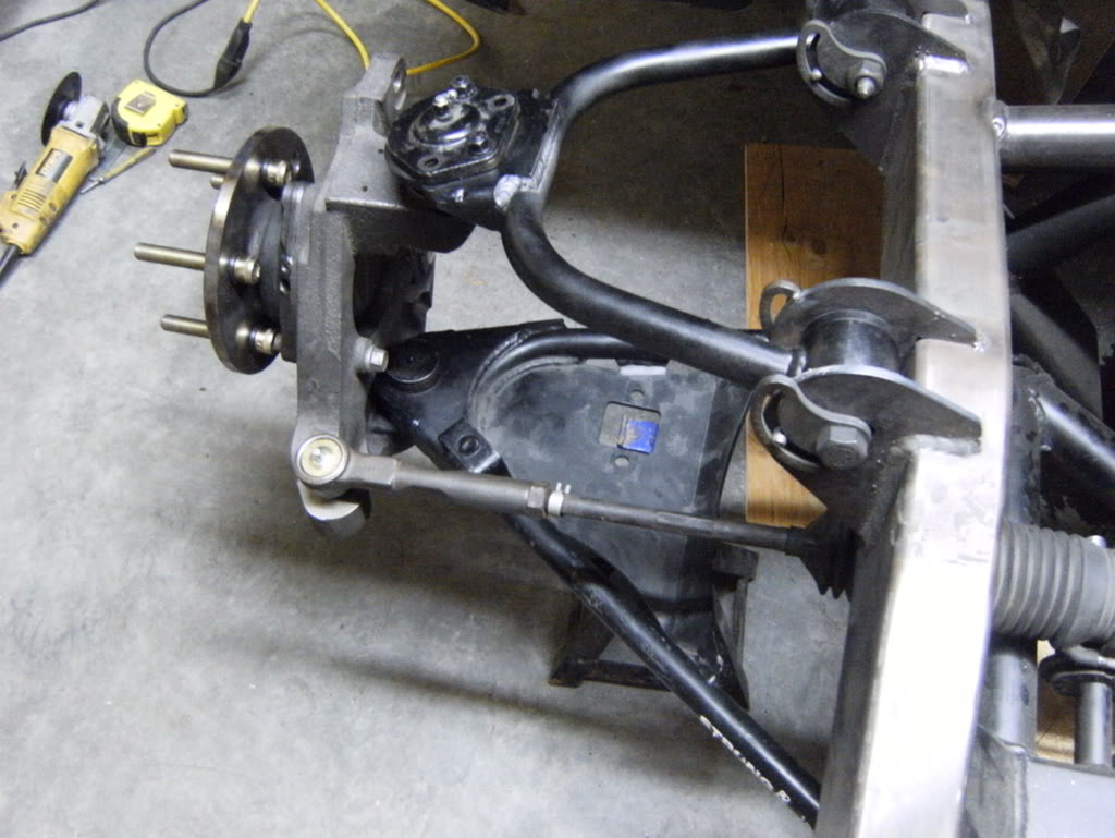

Moving up front

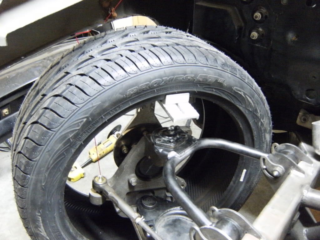

This is set at ride height

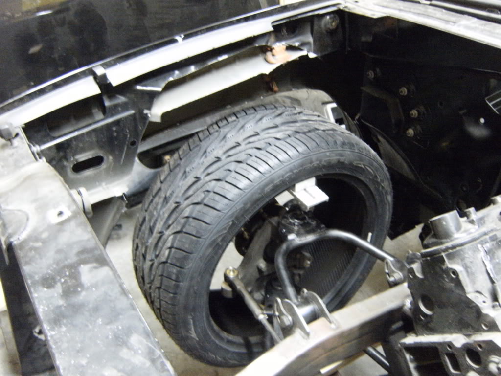

Lock to lock

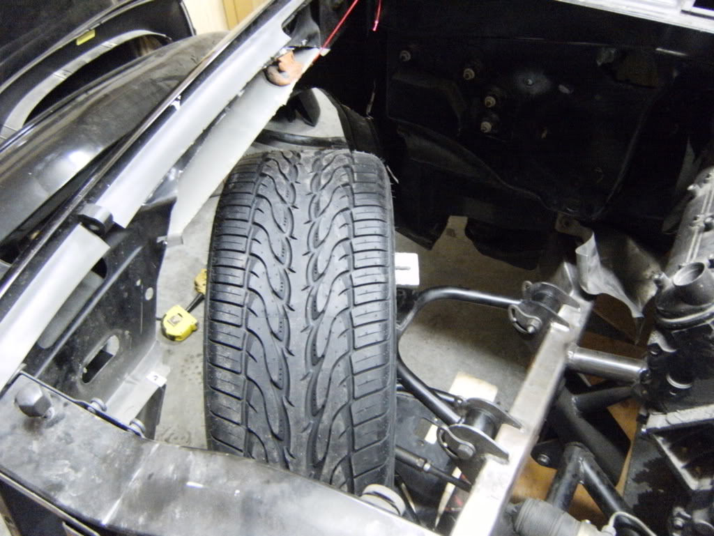

Almost laid out, need to trim some more.
