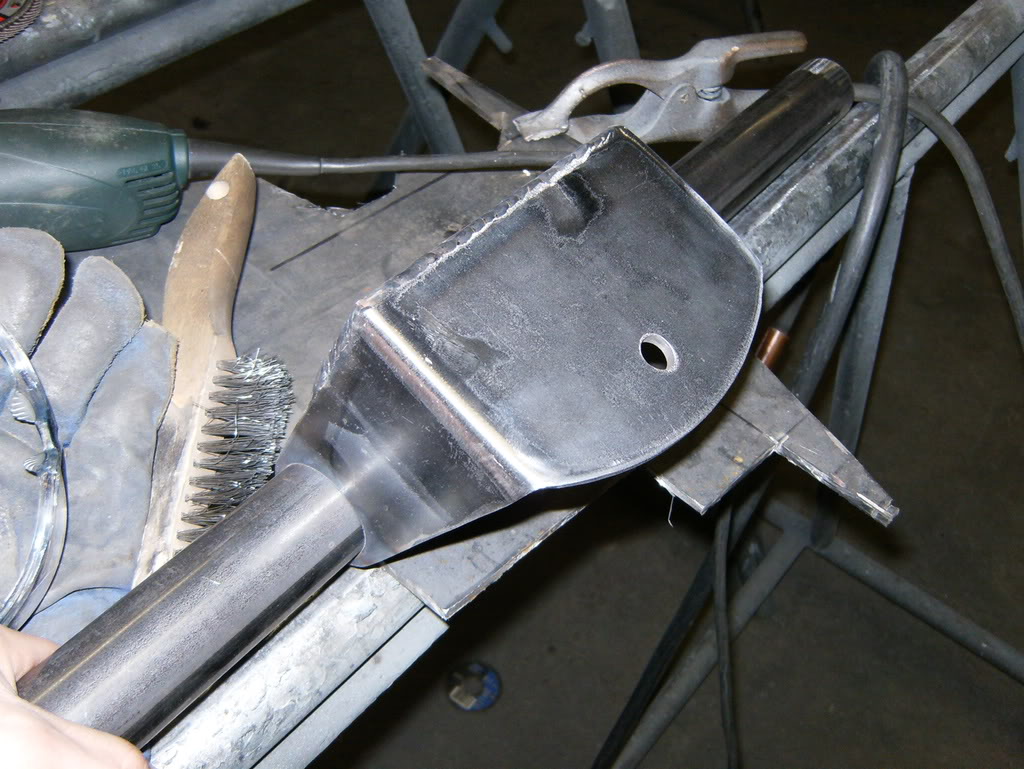

Finished up the trans crossmember...

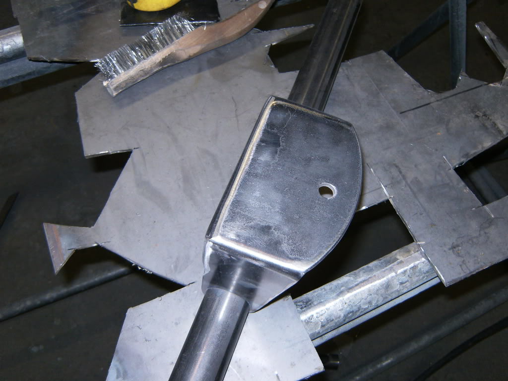

Smoothed out the welds real nice

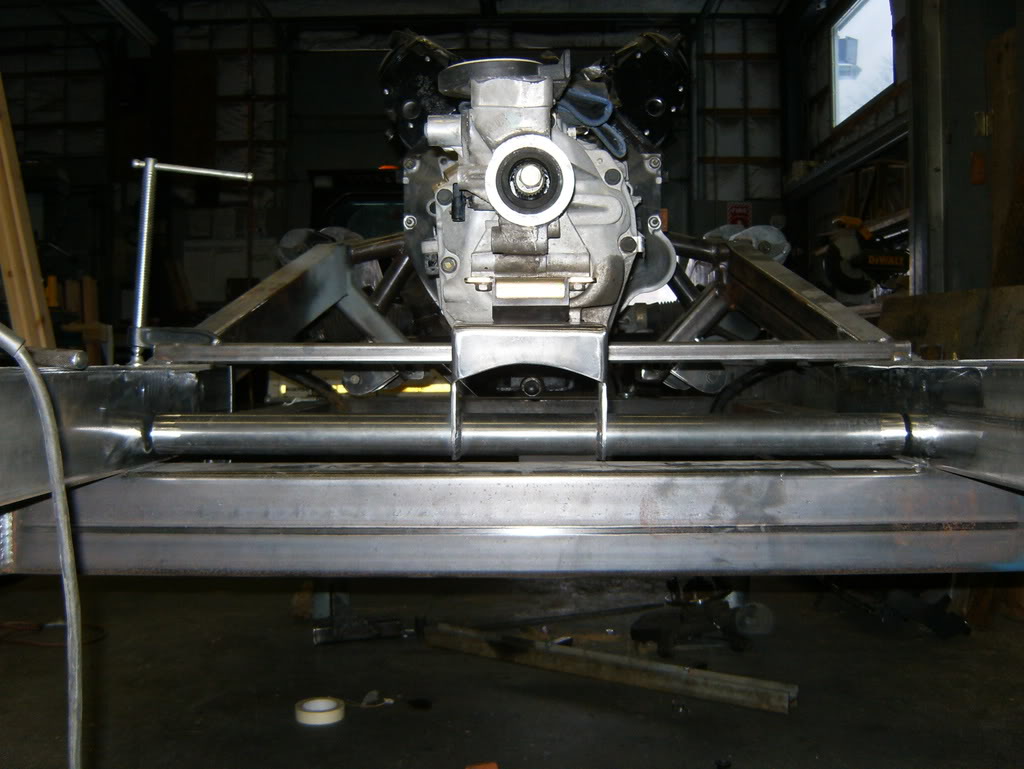

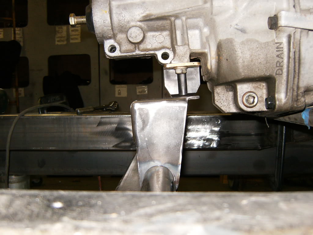

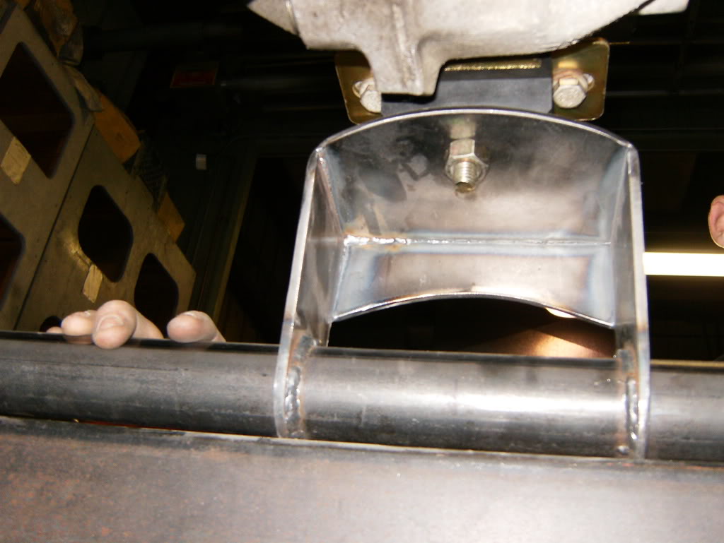

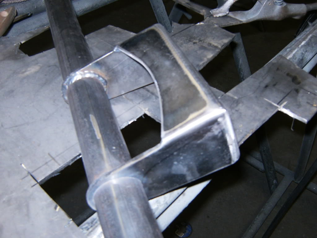

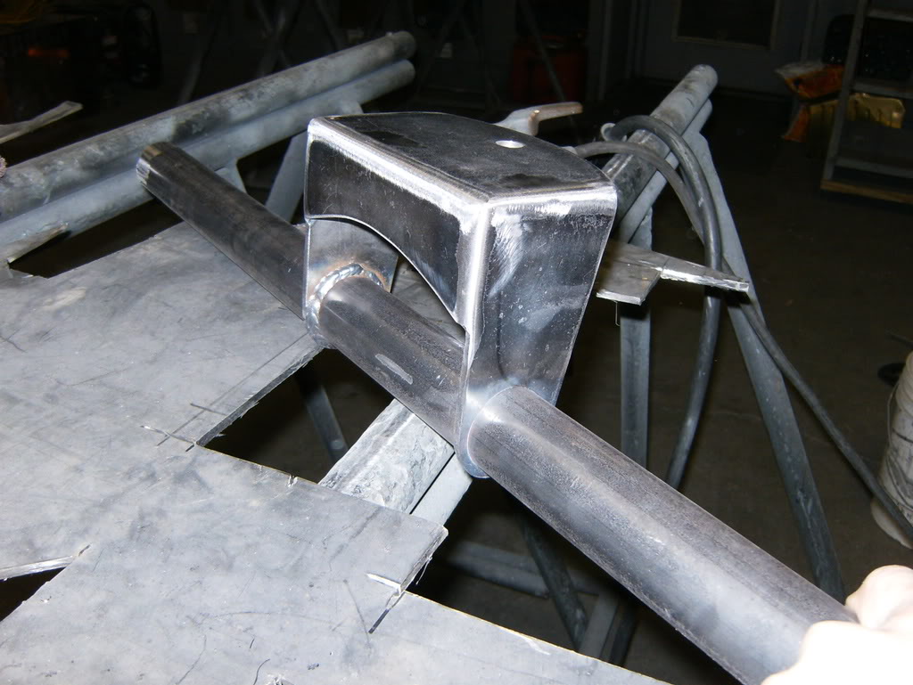

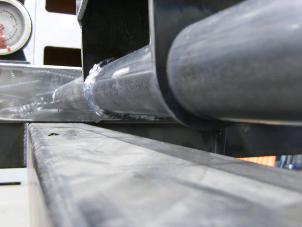

Mocked it up

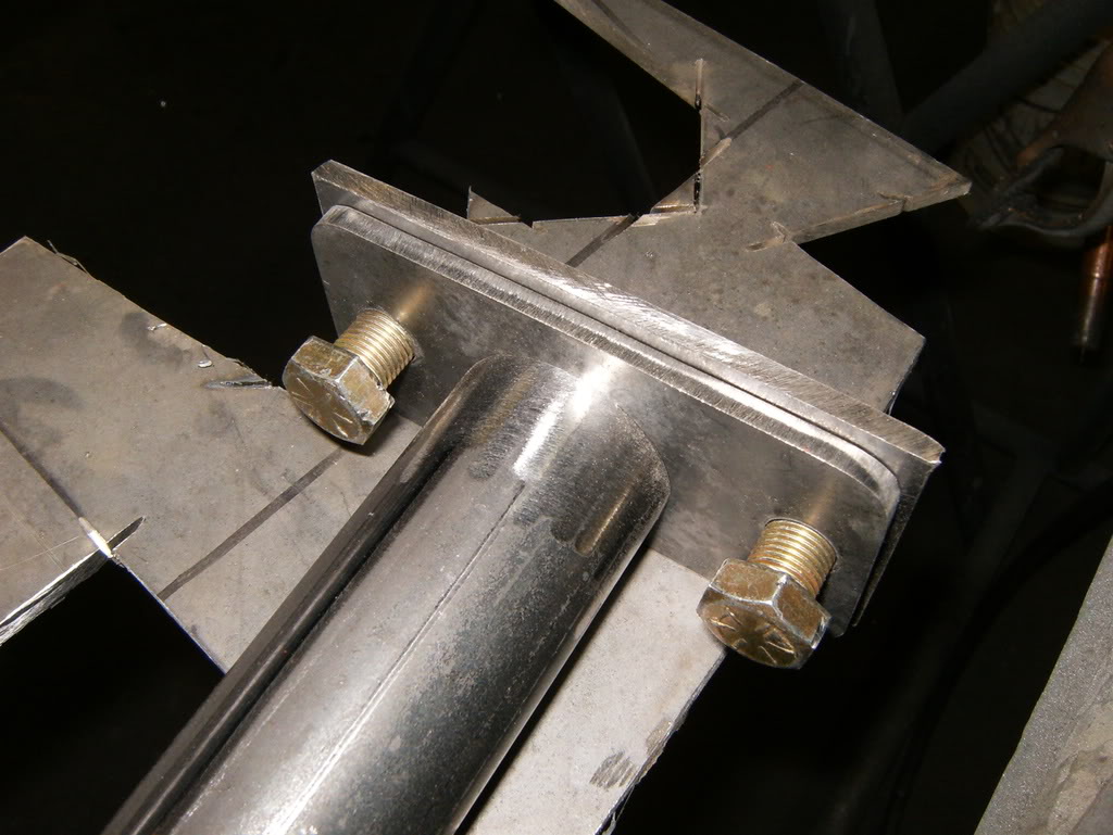

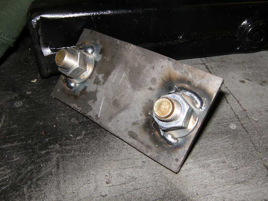

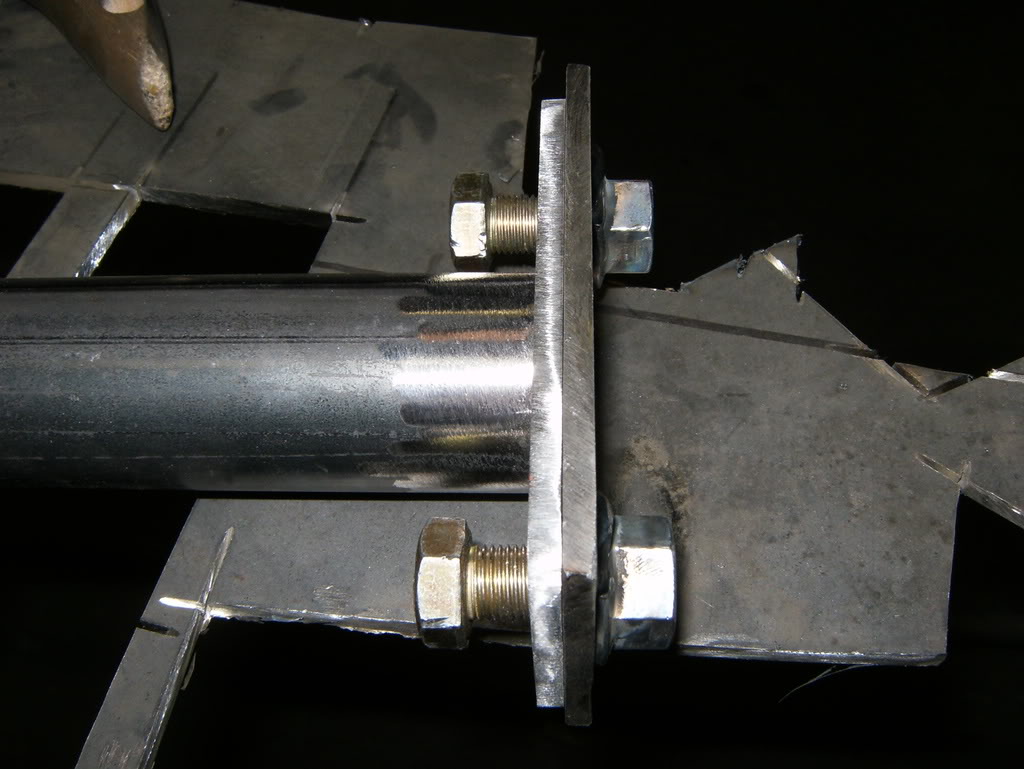

Now this plate will be welded to the frame and the nuts will be on the inside, a hole will be drilled to clearance the nuts and the plate will sit flush on the frame and welded all around.

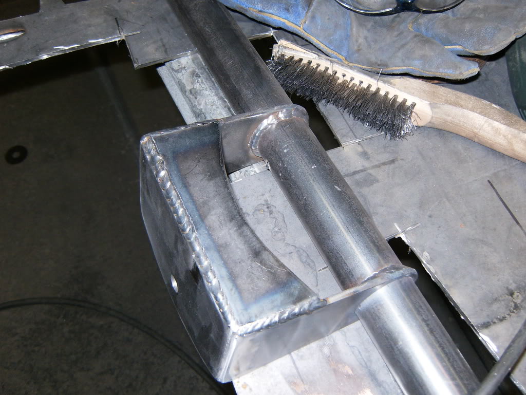

Then the other plate will be welded to the crossmember and allow it to be bolted in
