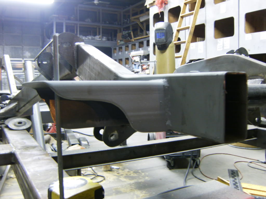

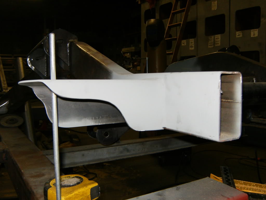

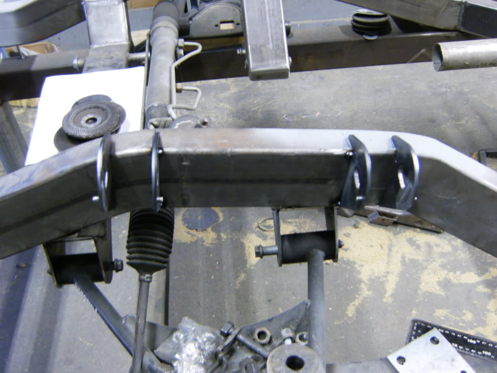

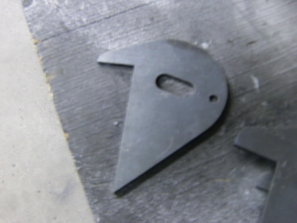

Bout time I update, ordered some brackets through SD so I was waiting on those... got a call and they told me they shipped my custom cut duck heads, I was confused, but then soon realized that they do resemble a ducks head :crazy: Here they are
Upper control arm frame mounts to be exact, with stock alignment adjustment.

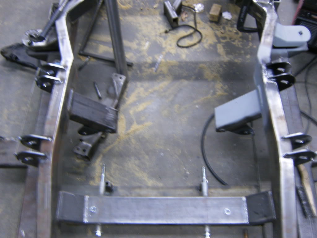

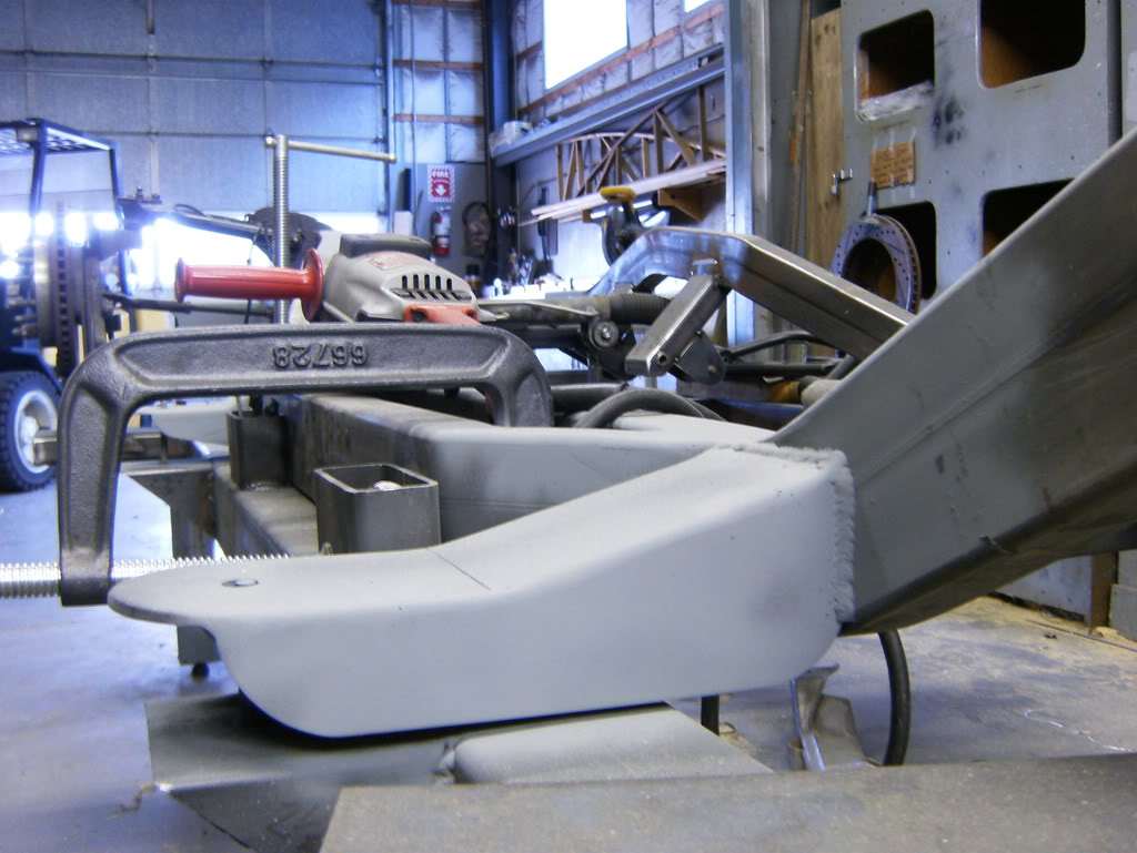

First took care of the rear crossmember, doubles as a bed mount, however I'm considering a tilt bed, not to be a show off, more so for ease of maintenance and such

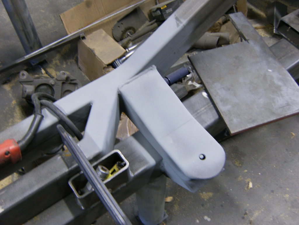

Then got the rear cab mount done... wish I would have planned the frame a little more I don't love the fact it's so long, but that's what happens when you do the first one, you learn as you go

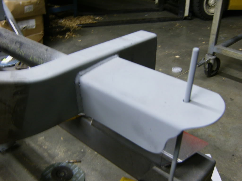

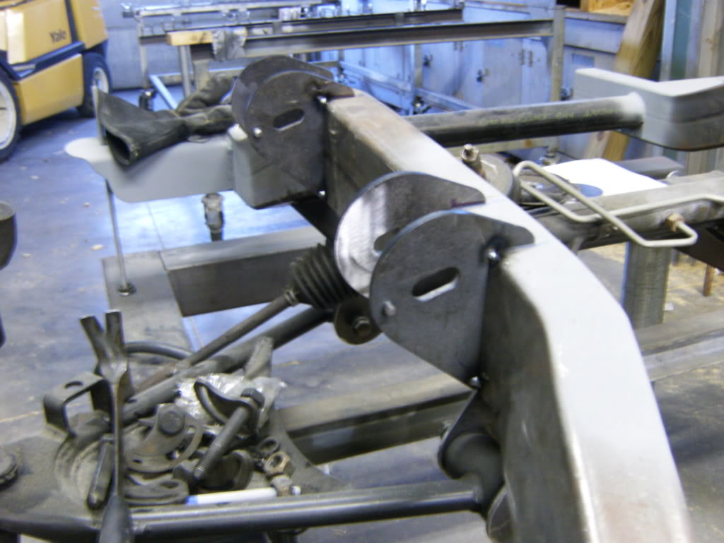

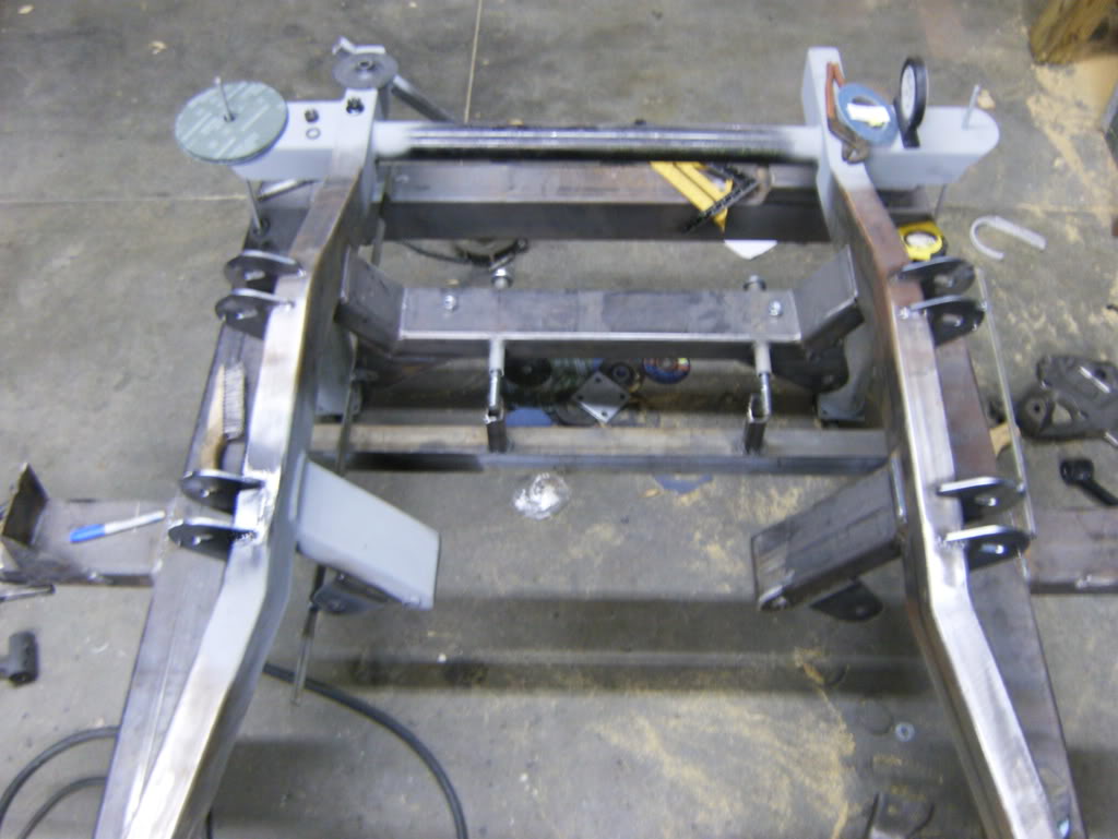

Then I wanted to finish the front suspension so I waited to do the last cab mount till later
Mocked them up

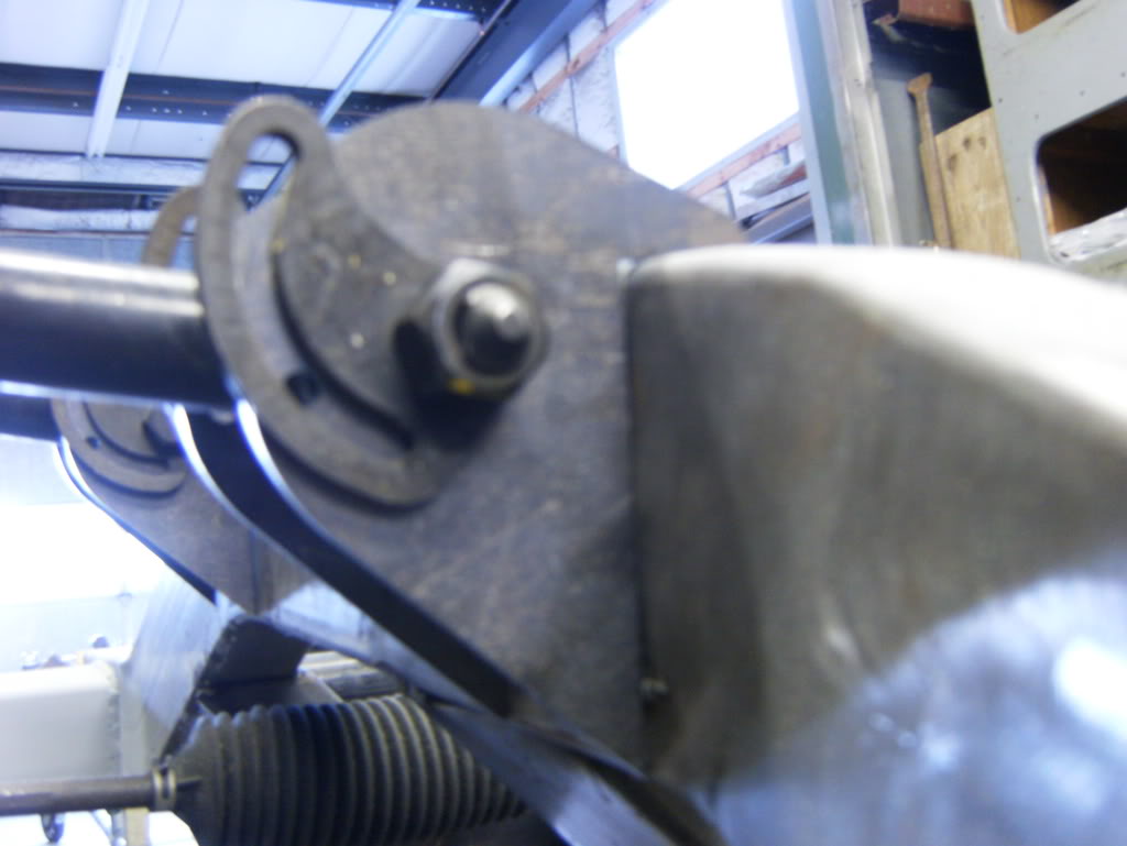

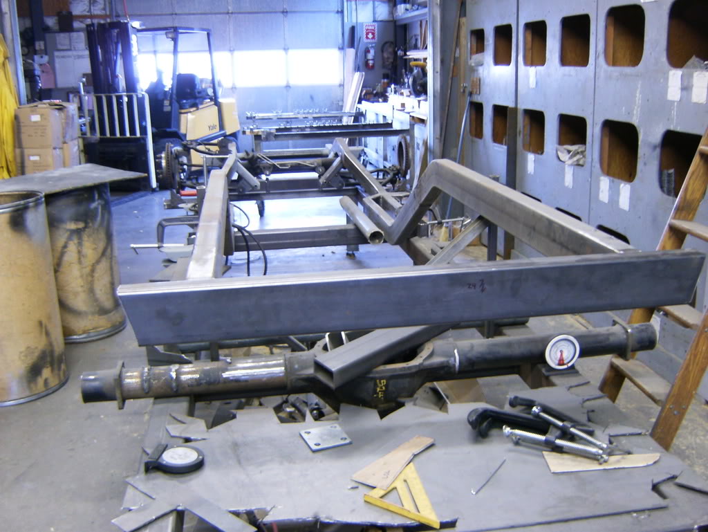

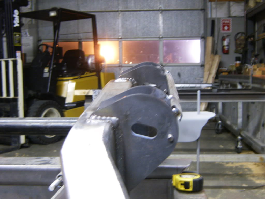

Needed to add the alignment pin
All pin installed welded and smoothed

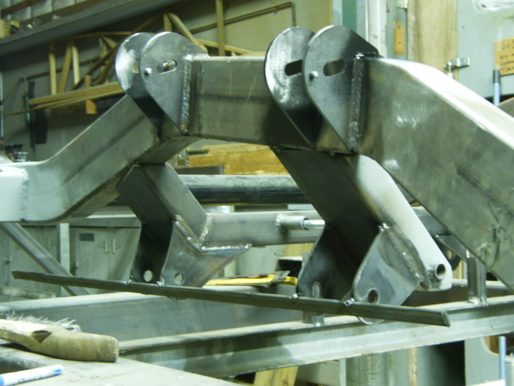

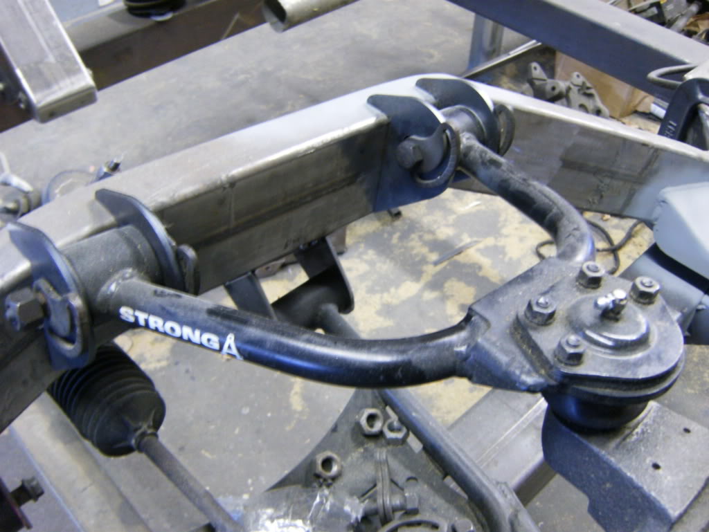

All welded up

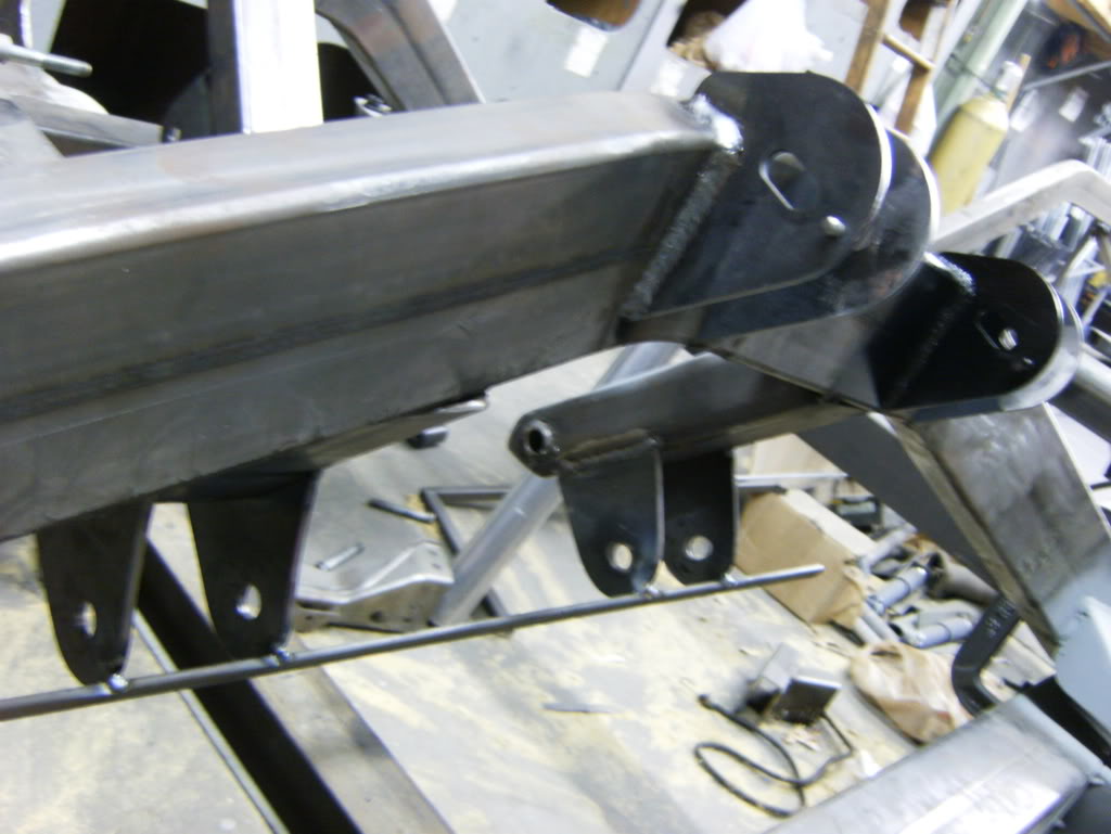

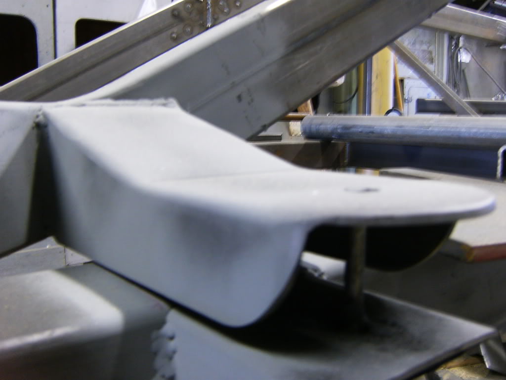

Finally the core support mounts, wanted to retain a factory design
That's it for now, I'm looking for a T56 atleast the case so I can finish the last of the crossmembers, having trouble finding one for cheap.
