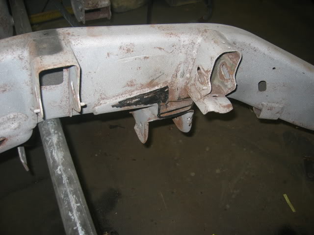

I saw how Kdubas did hes front section, but I hated the "non-factory" look...
So I marked and cut it
