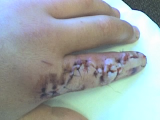

Ouch... I cut my index finger open across the nuckle at work almost 3 mo ago ( 9/10/07) and it is still healing... Still Trying to get all the movement back. It toke almost 2 months to be able to bend it 90 degres on with its own power... Talk about bad accedints. I Even got before surgury and after surgury pictures... I just went back for my check up and I told them there was some discomfort around this little bump near the scare... Guess what, there is still some foreign material in there and if the discomfort does not go away on its own they will have to go in and remove whats left....
Take your time and follow your doctors advice. Oh btw my employer did not have workers comp and my personal insurance was screwed up at the time ... I got it fixed but I have not been able to see a physical therapist on my own yet.

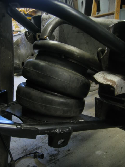

So I finally got the rest of the part I need to finish the frame work... started with the front end this weekend
Bolted everything up to set up the torsion brackets
Cut the plates down to size
Cut some blocks of wood to the minimum bag height... 2.9" I just made it 3"
Cut the 1/4" think 1" DOM Tubing
Tac'd everything in place
Only place it really scares me... but it never touches the frame unless its all the way laid out and its not really a scrub it just a tap kind of touch, but since that is just extra metal from the bump stop or whatever I can grind out enough clearance.
