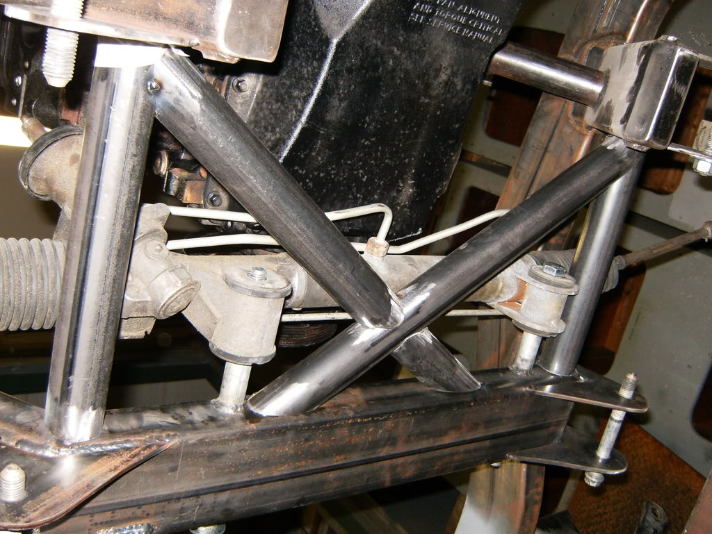

UPDATES!!!!
Xmas break is hear and I want to get this frame done... so without further or do, tonights progress...

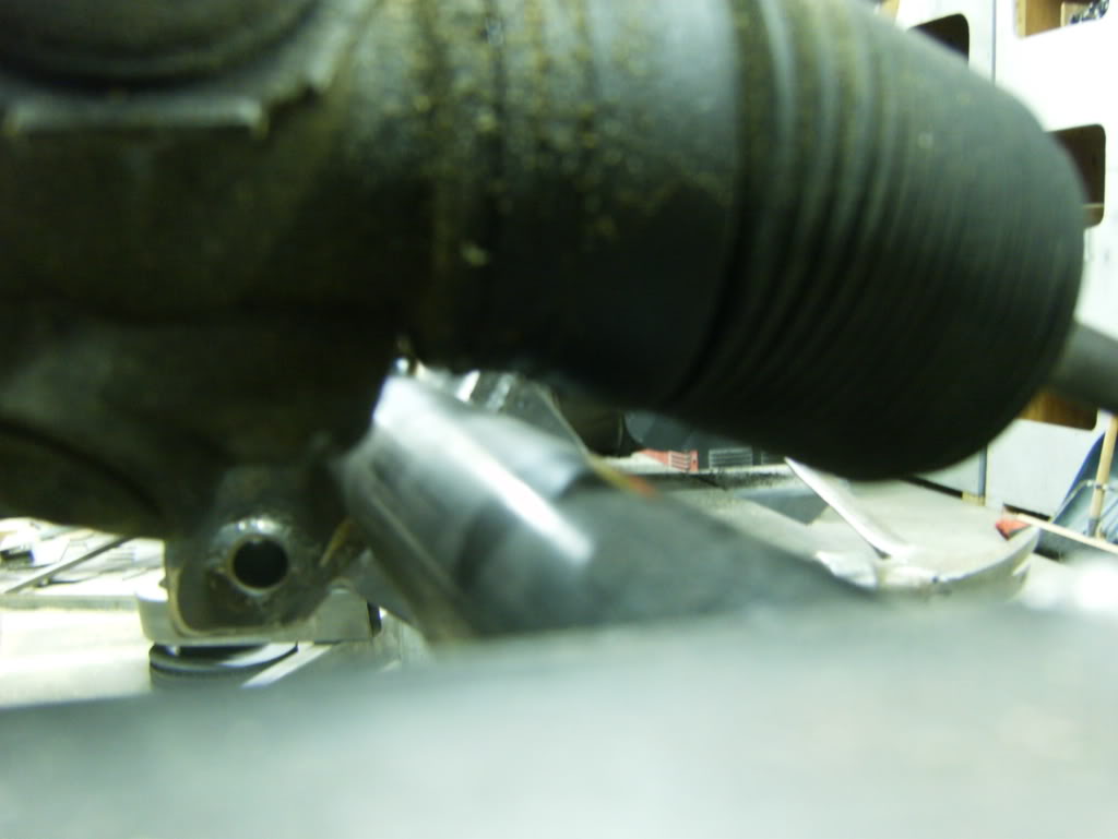

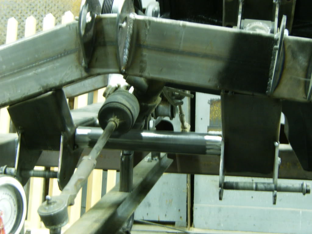

I wanted to tie in the two front crossmembers, so I began with some tubing

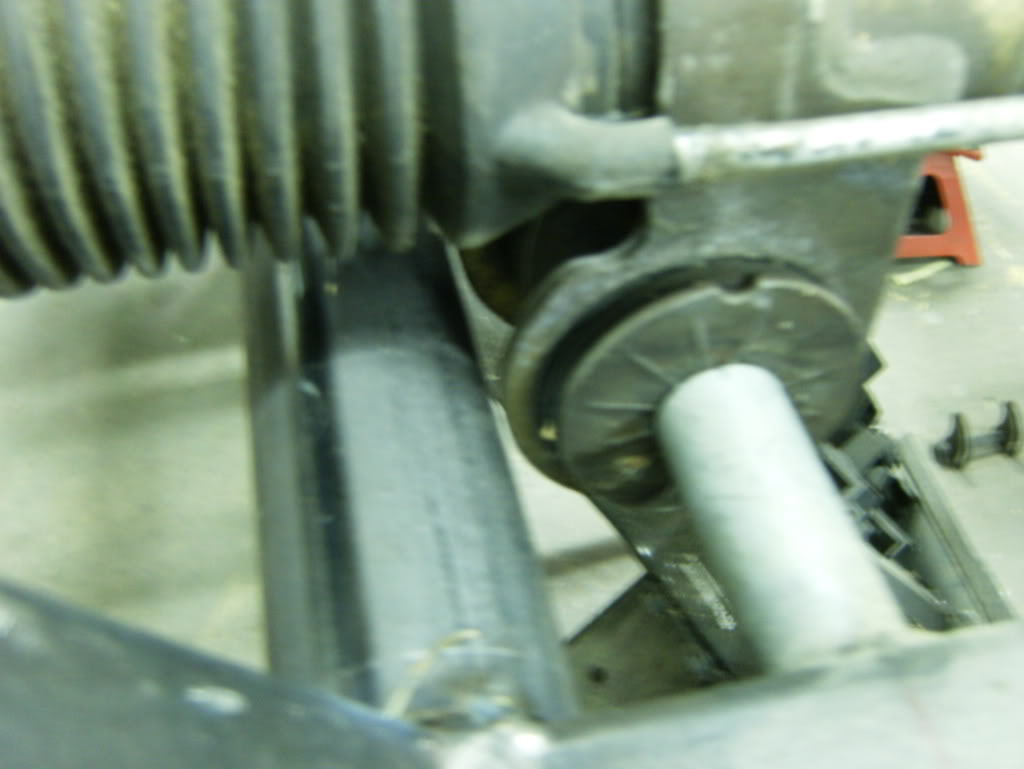

Checked all the clearances

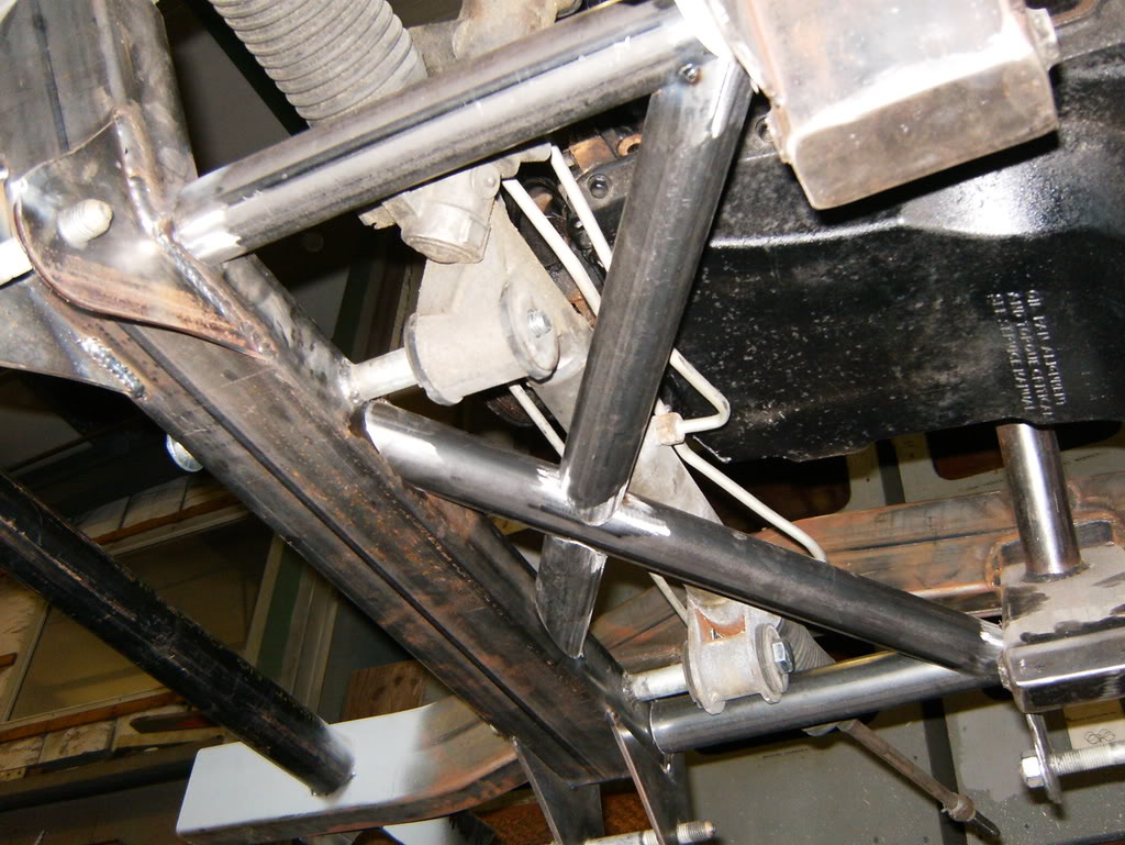

Now those tie them in, lets add some strength to the front end, what's stronger than an X?

Can you back that bolt out on the right side of the rack????

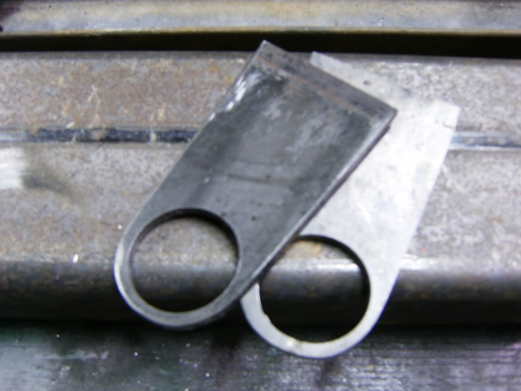

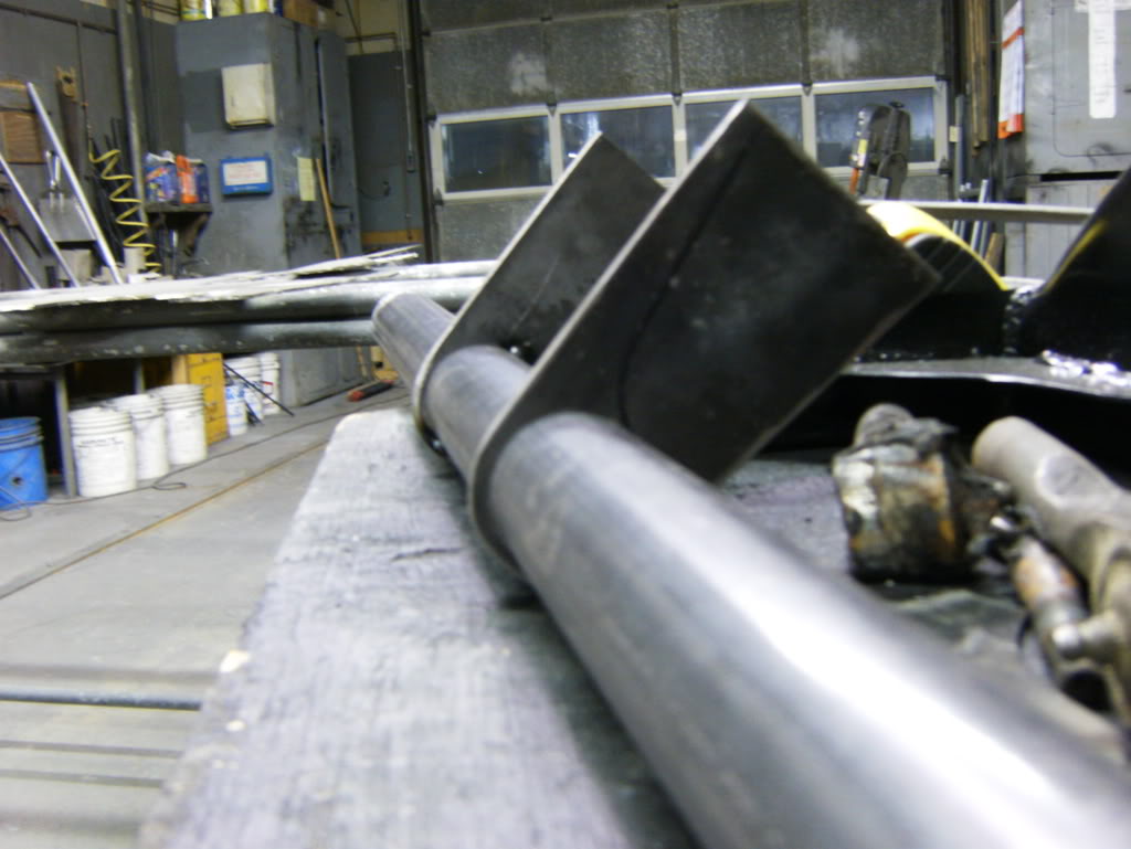

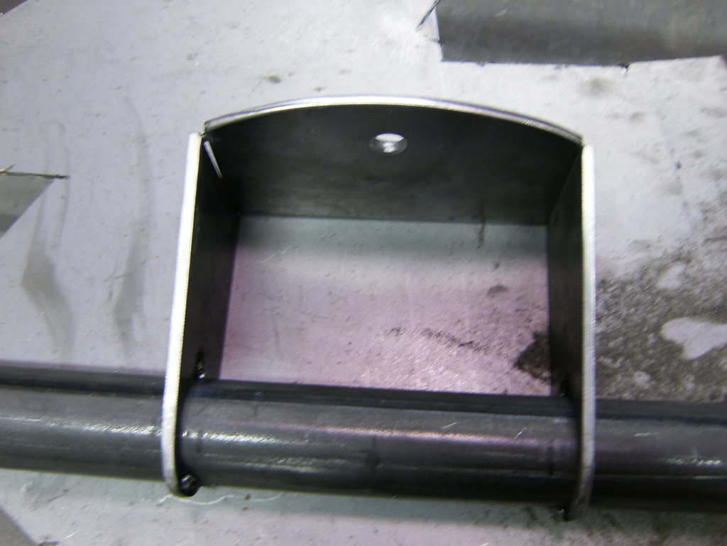

Trans crossmember, the start
Cutting away with a cutoff wheel, and my almost gone sheet of 3/16"

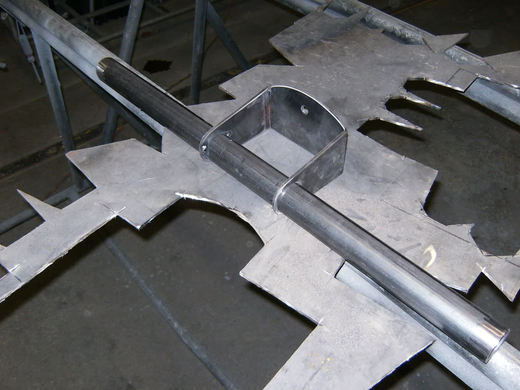

The outcome, well I used a holesaw for the holes
Nice and tight fit

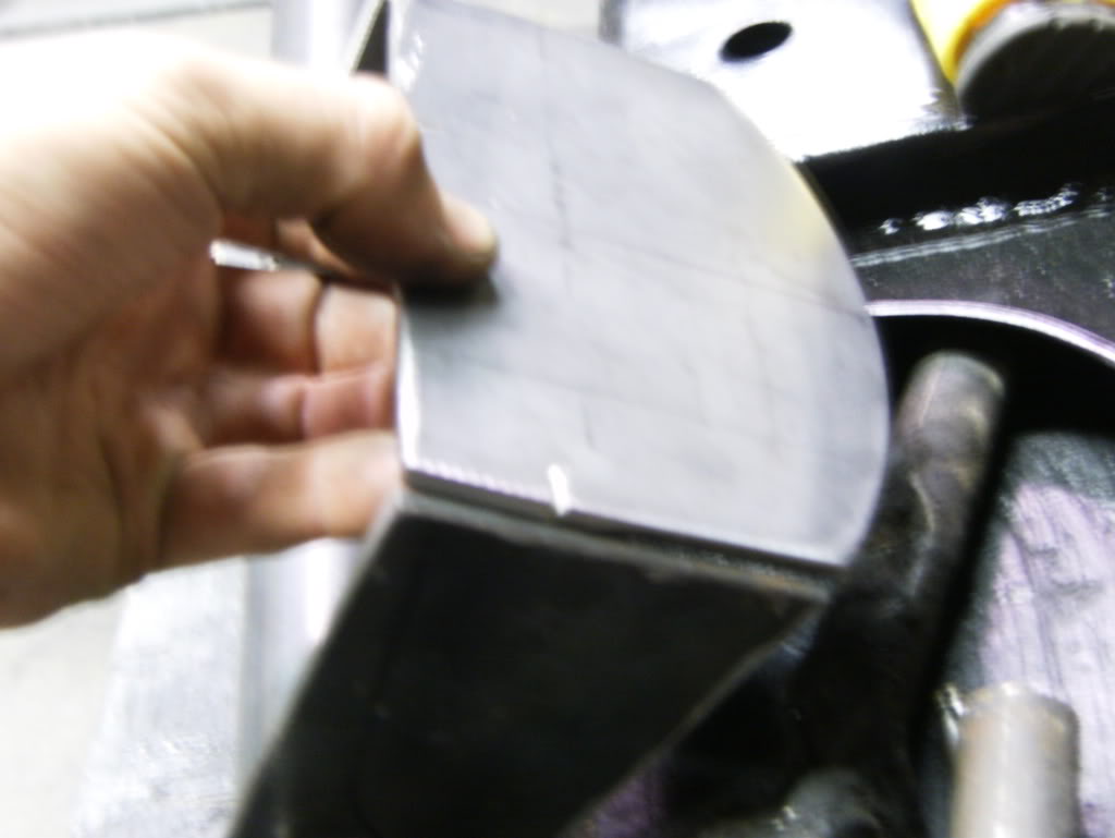

Cut the top piece

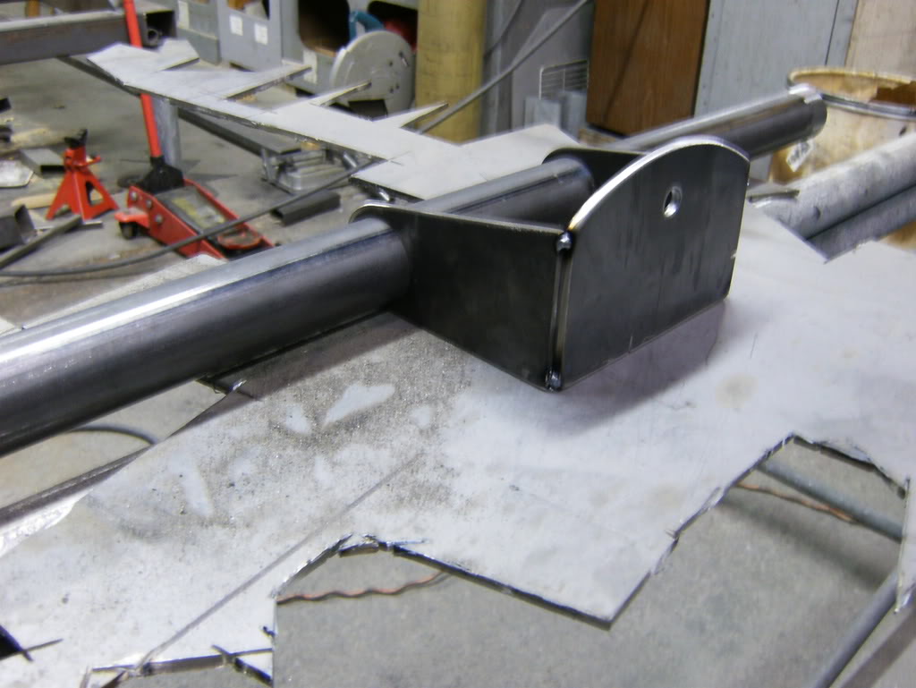

All tac'd

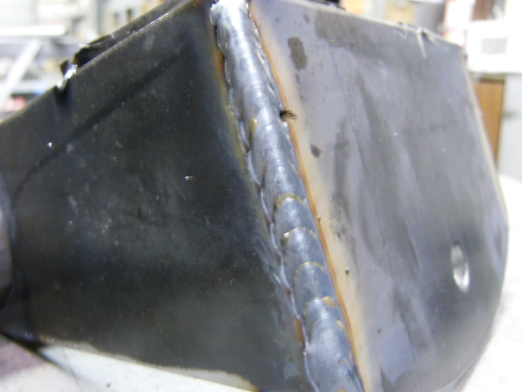

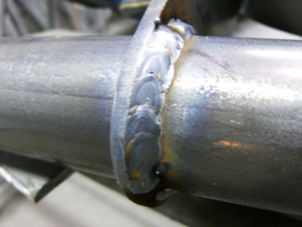

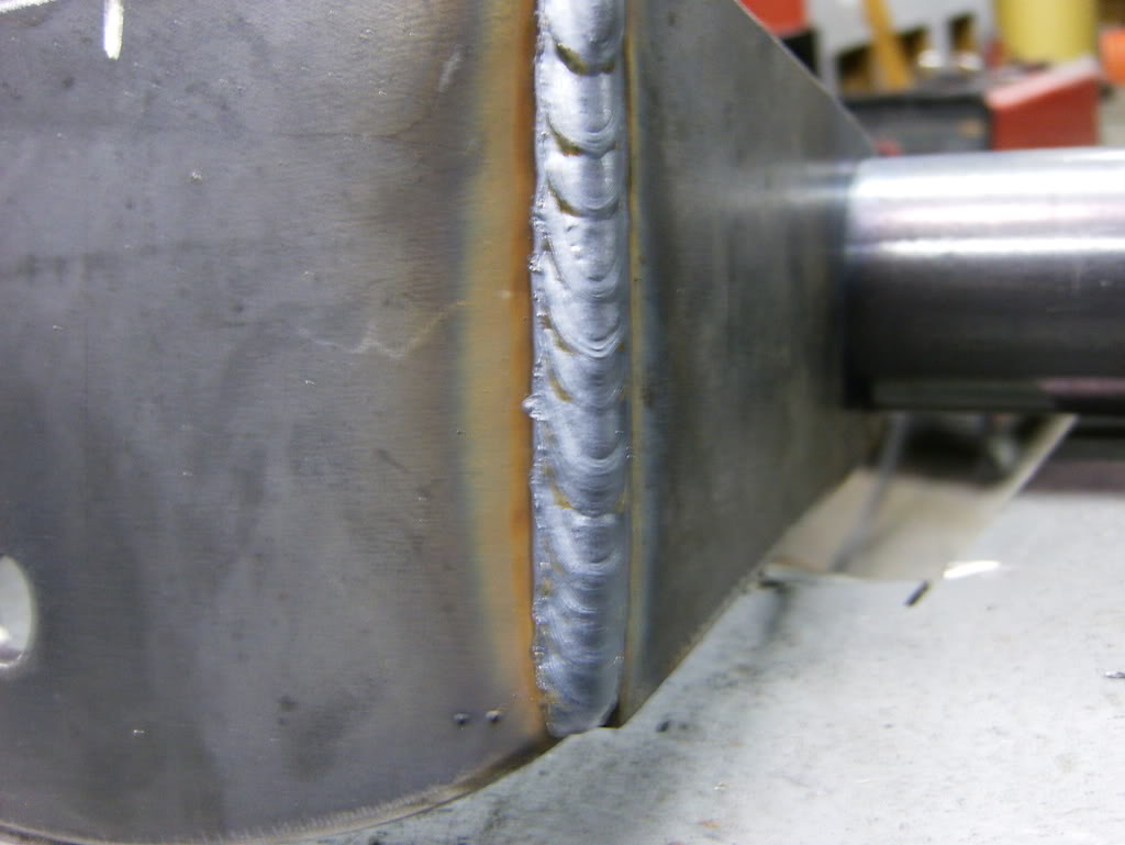

The welded it all together, the corner gussets are temp, going to make one piece for it tomorrow
