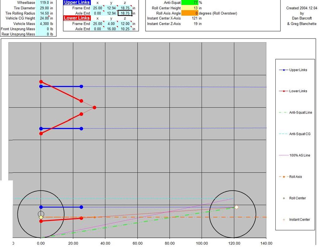

Just been designing my rear suspension, running it through calculators, trying to set it up perfect, going to be adjustable for the street and the strip. As for layout, it's going to be a Satchell 4link.

ok ok I worked on it, haha
been working on designs, this one I believe I'm going to use for street then I lower the upper bar 1" and I will have 2* understeer with 100% AS, if I lower the bar 1/8" from the picture it keeps it at 0* but put its into understeer instead of oversteer, so I will probably do that, which in turn bumps my AS to 80% on the street

What program Is that???

just an excel spreadsheet I found off pirate4x4
