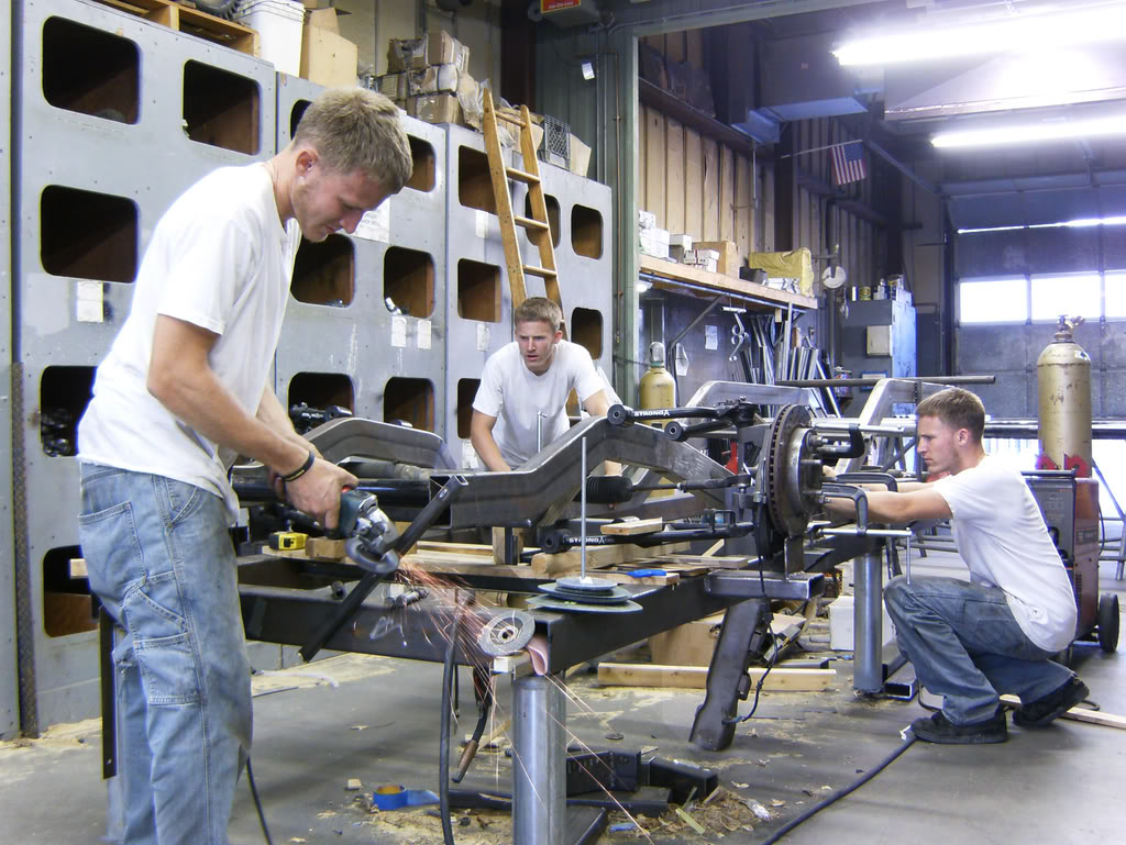

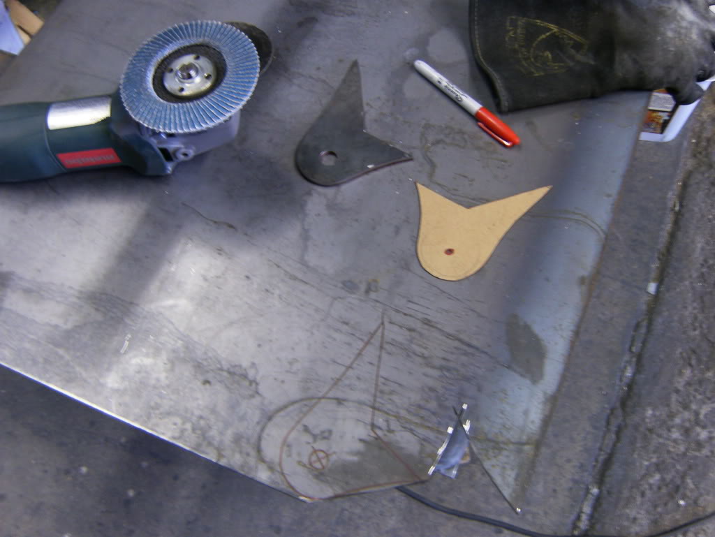

had a few extra hands...
haha not, I wish though.

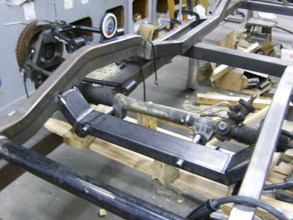

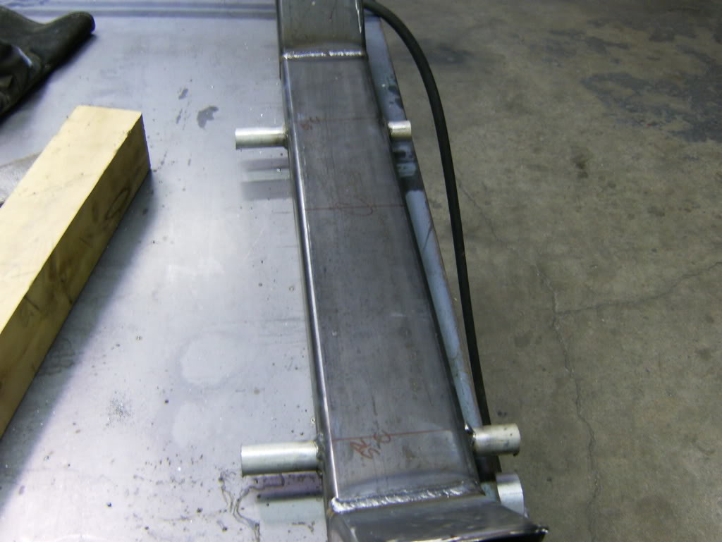

So I continued with that crossmember, made stock styled rack mounts.

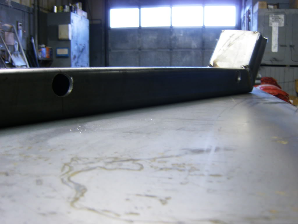

Going to cut down some of the excess on the opposite side

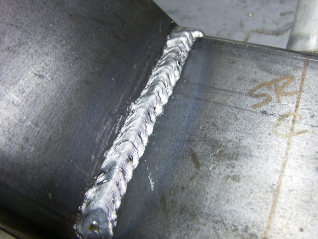

Beveled edges and a nice solid bead

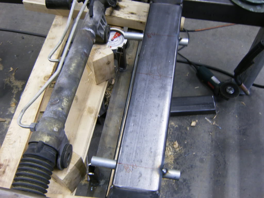

Back on the frame
Temporary bolts holding it in place

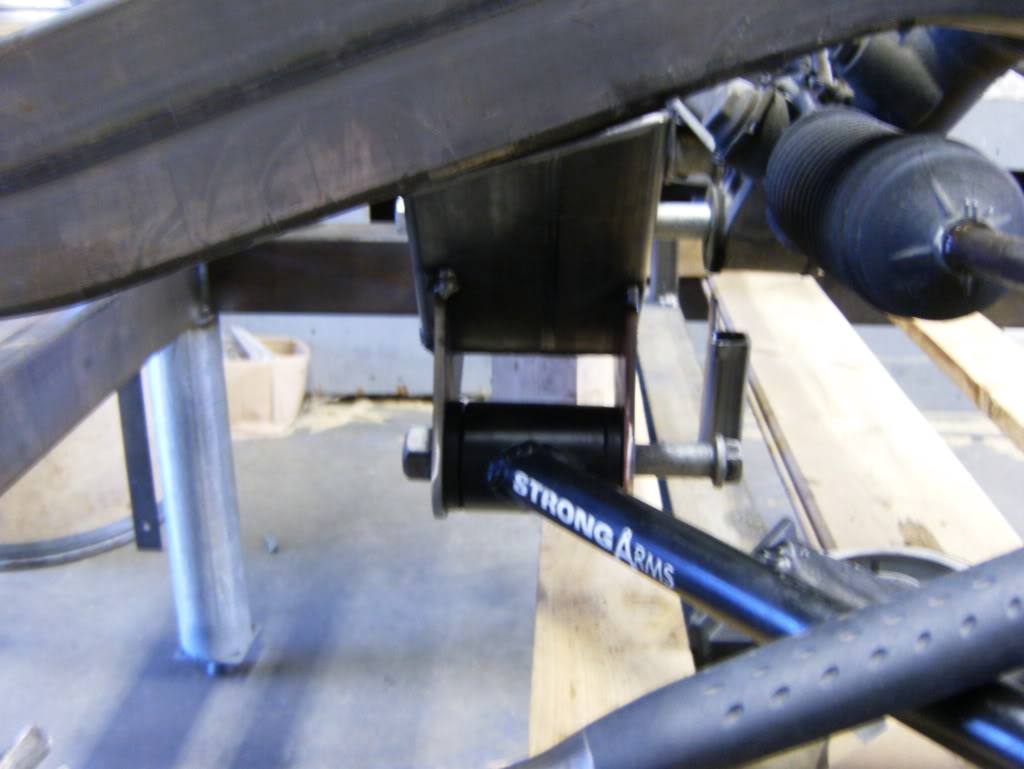

Lower control arm mounts, I was going to have them laser cut, but seemed like a waste of money and time for what I will need
