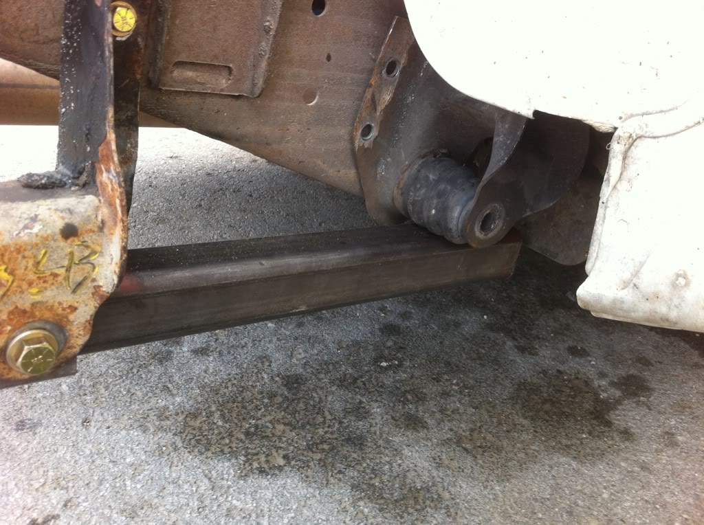

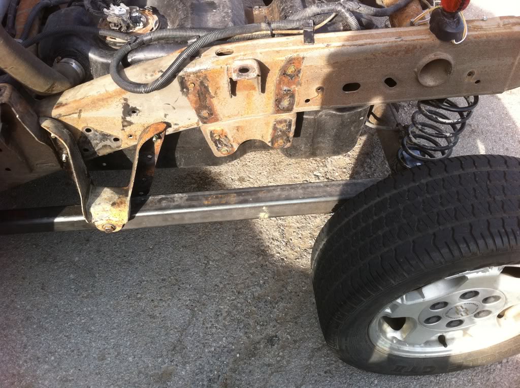

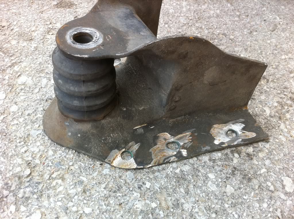

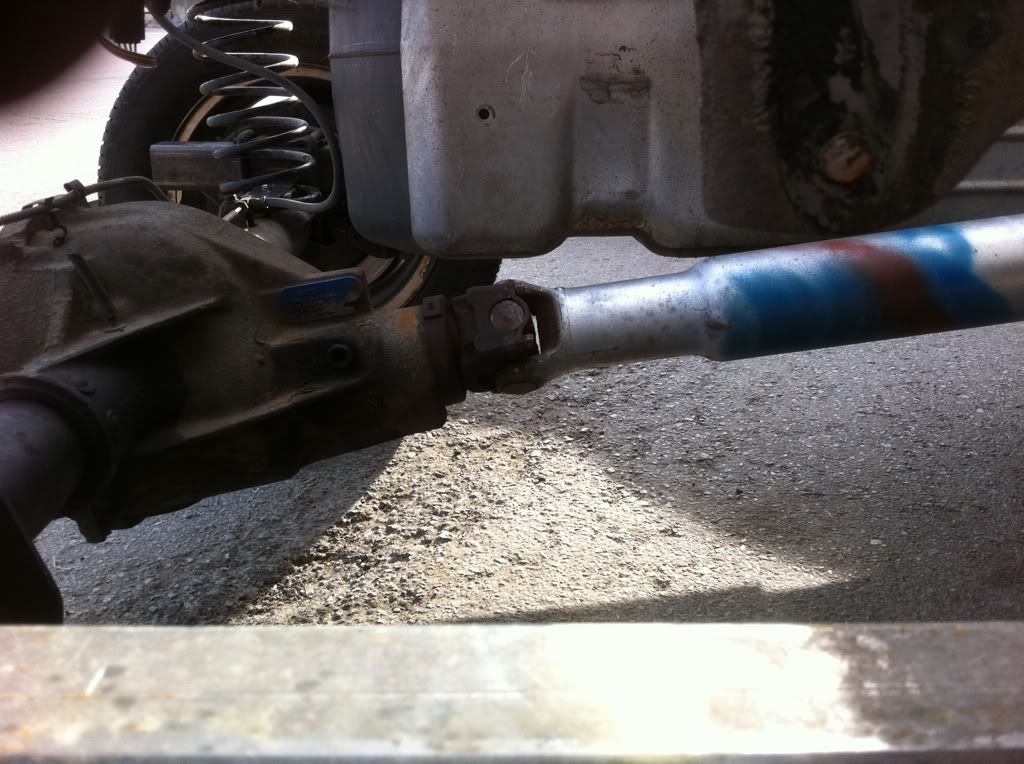

I figured out a suspension setup that'll lift the front and load the tires. I extended the 2 link 16" forward and am attaching another spring hanger to the front. When I hit the throttle it'll try to lift and apply pressure to the front hanger.
Since it only contacts under torque and isn't rigidly mounted it'll still cycle the suspension normally.
