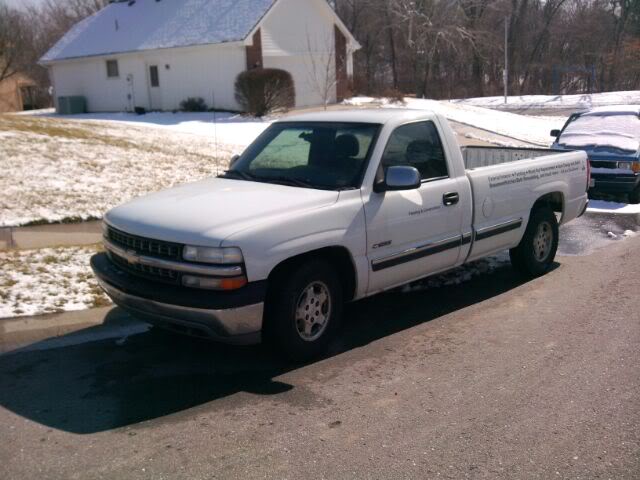

Here's my 00 1500 rclb the day I brought it home
201,000 miles
3rd owner
Window sticker
Brand new shocks, transmission, tires with receipts
Stack of service records
Ls model fully loaded minus leather
2wd auto
3.42 posi
Tinted windows
Alloy wheels
$2500

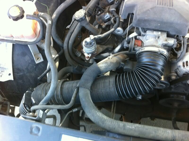

I should mention on the latest run I removed a bunch of random brackets and installed a $25 cold"er" air intake.
All runs were made in drive in tow/haul mode yet I can feel my torque management shut down my party. Tires are hankook dynapro asm in 245/75-16 flavor. That's 30.5" tall and according to tire rack they weigh 43 lbs a piece!
But they are really good tires for people wanting a good quiet smooth ride and lots of miles from their tires.
I personally don't care so I'm looking for 205/50-16 fronts that are y rated and 255/55-16 sticky y rated tires for the rear. unless someone knows of a lighter combination that'll work with my stock gearing and keep my truck from redlining at 140+ mph

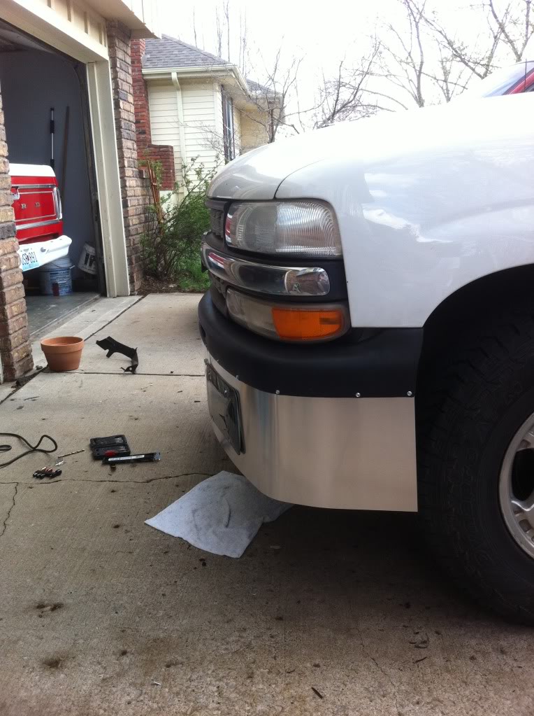

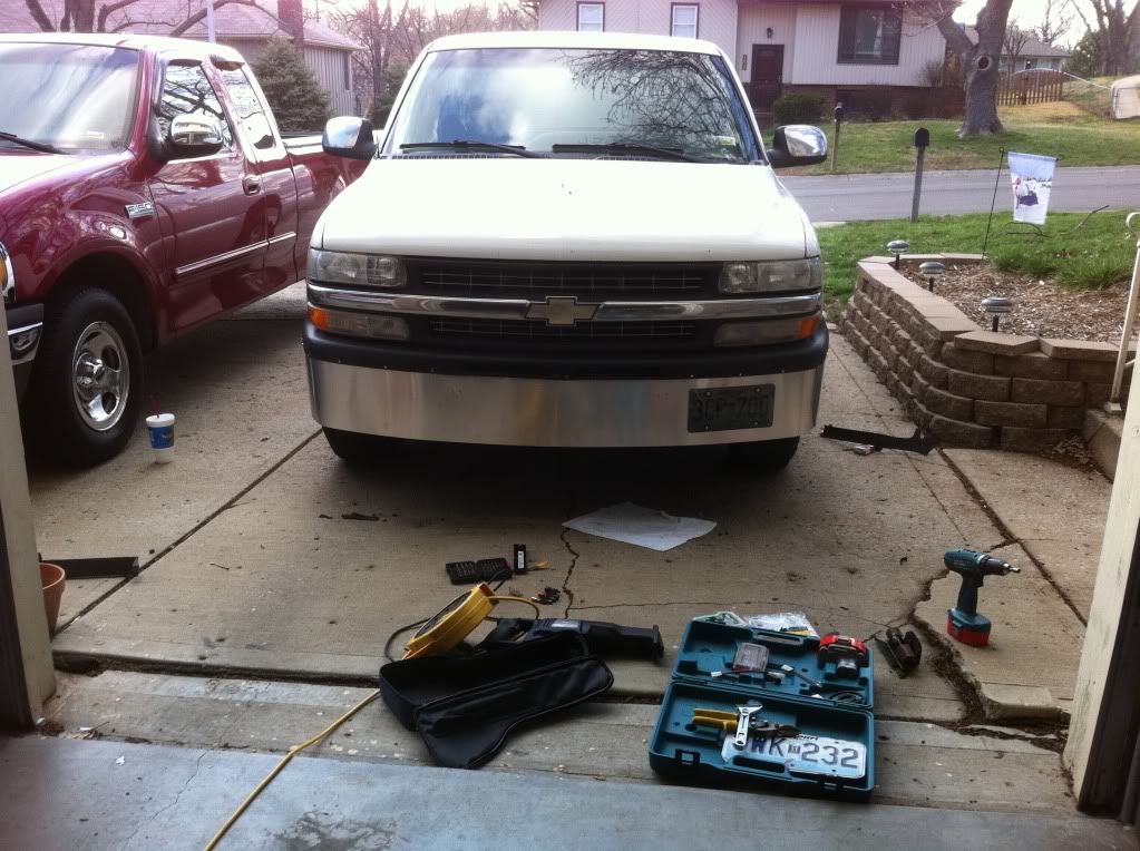

Here's the aluminum bumper I fabbed up yesterday. cost $26. Its a 10"x93" .05 sheet of aluminum shaped to fit the stock bumper cap. recessed and mounted. its cheap, light and works (surprisingly).

damn that bumper looks good
